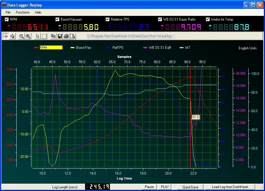

Yep. Here is a log I took during my dyno run (4th gear). I've also log many other non-dyno runs that show the same thing over and over again in just about all gears.
http://www.msprotege.com/forum/showthread.php?t=123683721
The graph below shows the max throttle opening position at 78%. By 6500 RPM's its down to 27%. Around 5.5K it starts closing but at 6K it starts closing FAST. Boost falls off at the same rate. Similar to AMS results.
Also interesting is how the throttle closes off in order to build boost. At around 2K RPM, it goes WOT and the throttle shoots to 78%. Then by 2800 its down to around 35% where it slowly starts opening again til it gets to about 65% by 5K RPM. And remember this is on a MS3 so a MS6 might be different.
I'm fairly certain that the turbo itself won't be able to produce much boost after 5.5K or so but we will definitely be able to gain a lot of power throughout the band if we have throttle control.
