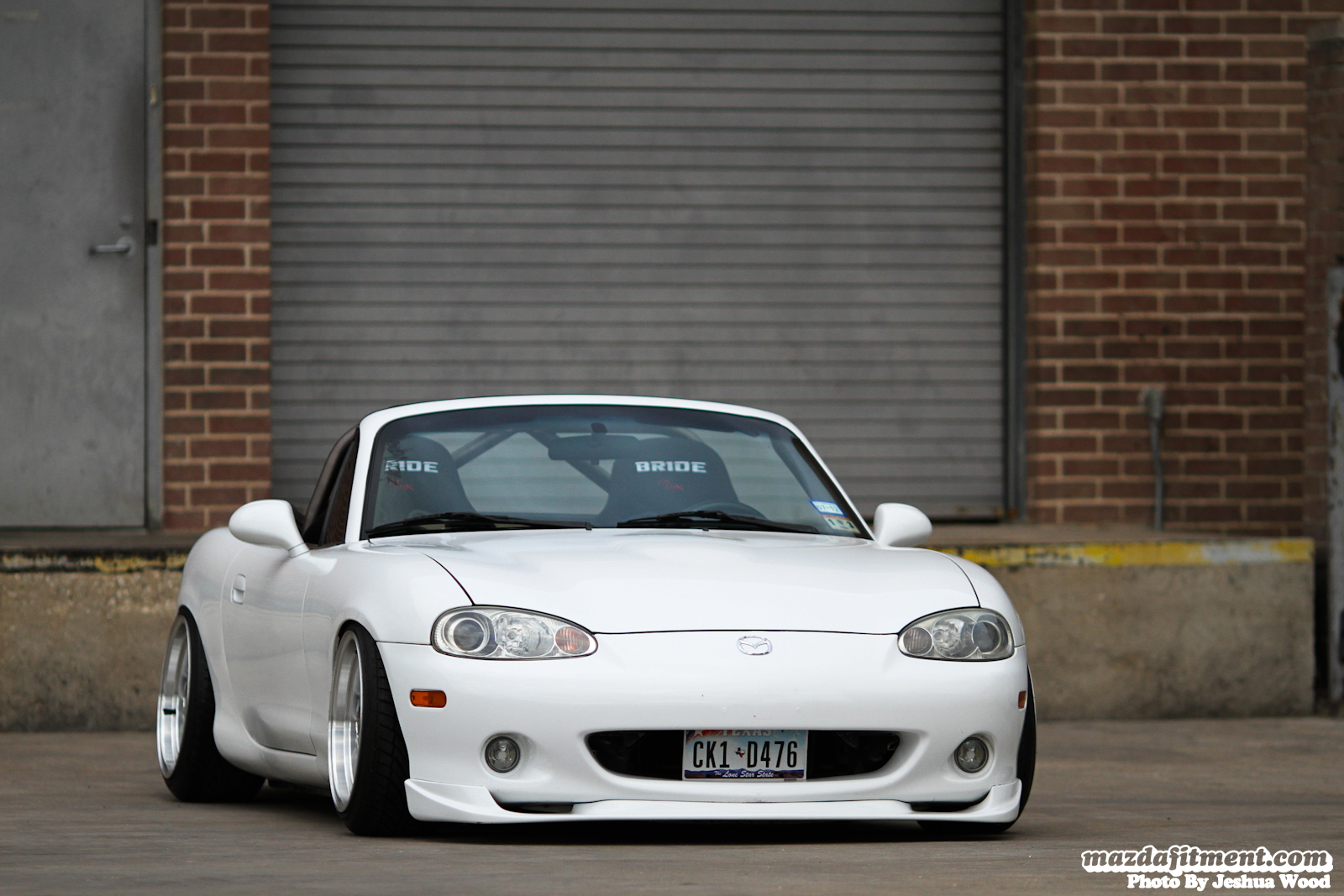

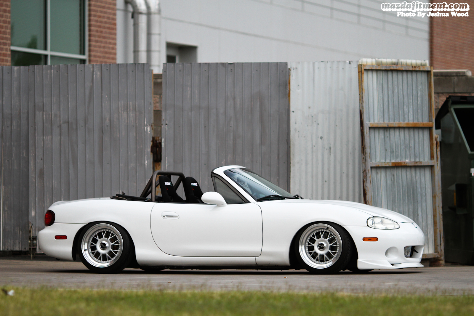

Main: http://mazdafitment.com/2012/05/14/lone-star-miata/
