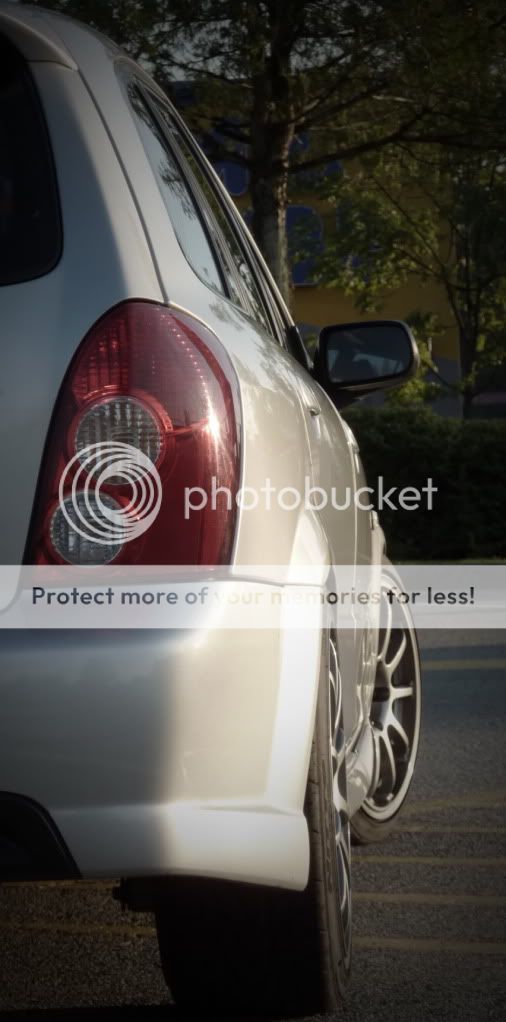

Best side profile I have without taking more: 17x8 with a 205/40r17 (8.58" width) Nitto Neogens. I know its not a 8.25" but its close. This is a common wheel/tire setup, there will be others. Beauty of it is that its not really stretch! 8" is still within Nitto's safe mounting widths, 8.25" ain't though
