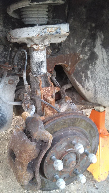

So I noticed a blob of grease on my rim last week and until I finally went to clean it today, I didn't make the connection that it could've came from the outer tie rod boot. Why do the non grease-able ones seem like they last longer? Guess I know what I'll be doing on Monday.
Is your tie rod end worn out or just messy ??
I like the greasable ones for my climate I just pump the grease until it oozes out then wipe off the excess.
I bought a grease needle so I can pump all the different boots full of grease.
Just thinkin...
The non greasable tie rod and other joints with boots can be sealed to keep crap out but the greasable ones have to let the old grease out when you pump in new stuff.
Another thing is that your boot is leaking from the bottom and perhaps the grease swelled the boot.
Perhaps a rubber safe grease would prevent swelling.
You could be correct. I have not checked for play since I was on my way out of the house. That will have to wait
It's probably fine, they're supposed to leak.
(But at the top near the pin not the bottom)
I've found the "non serviceable" joints & boots don't have any grease in the boots. They're full of air, then salty water then the ball joint rusts, so I completely fill my boots with grease.
