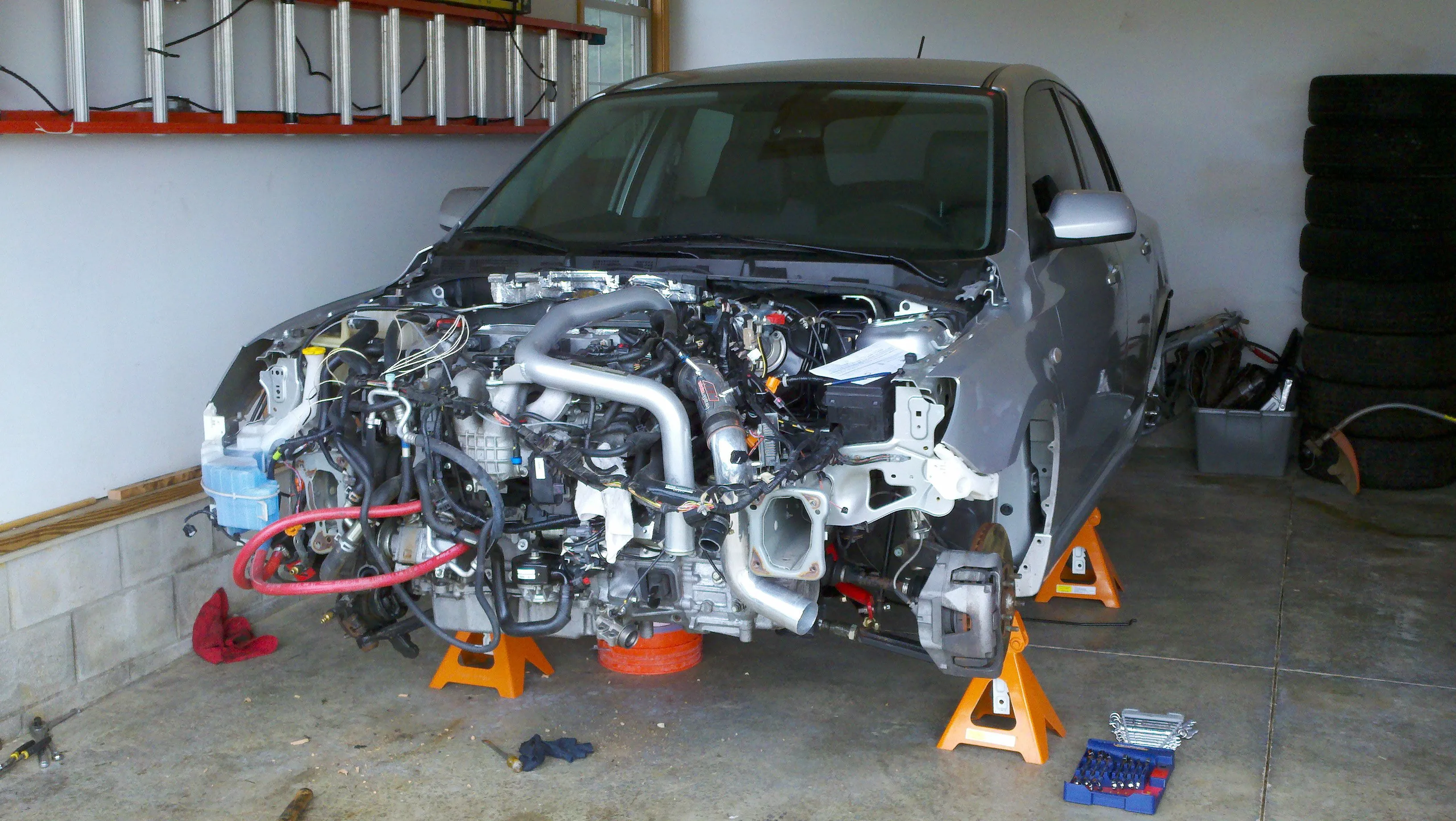

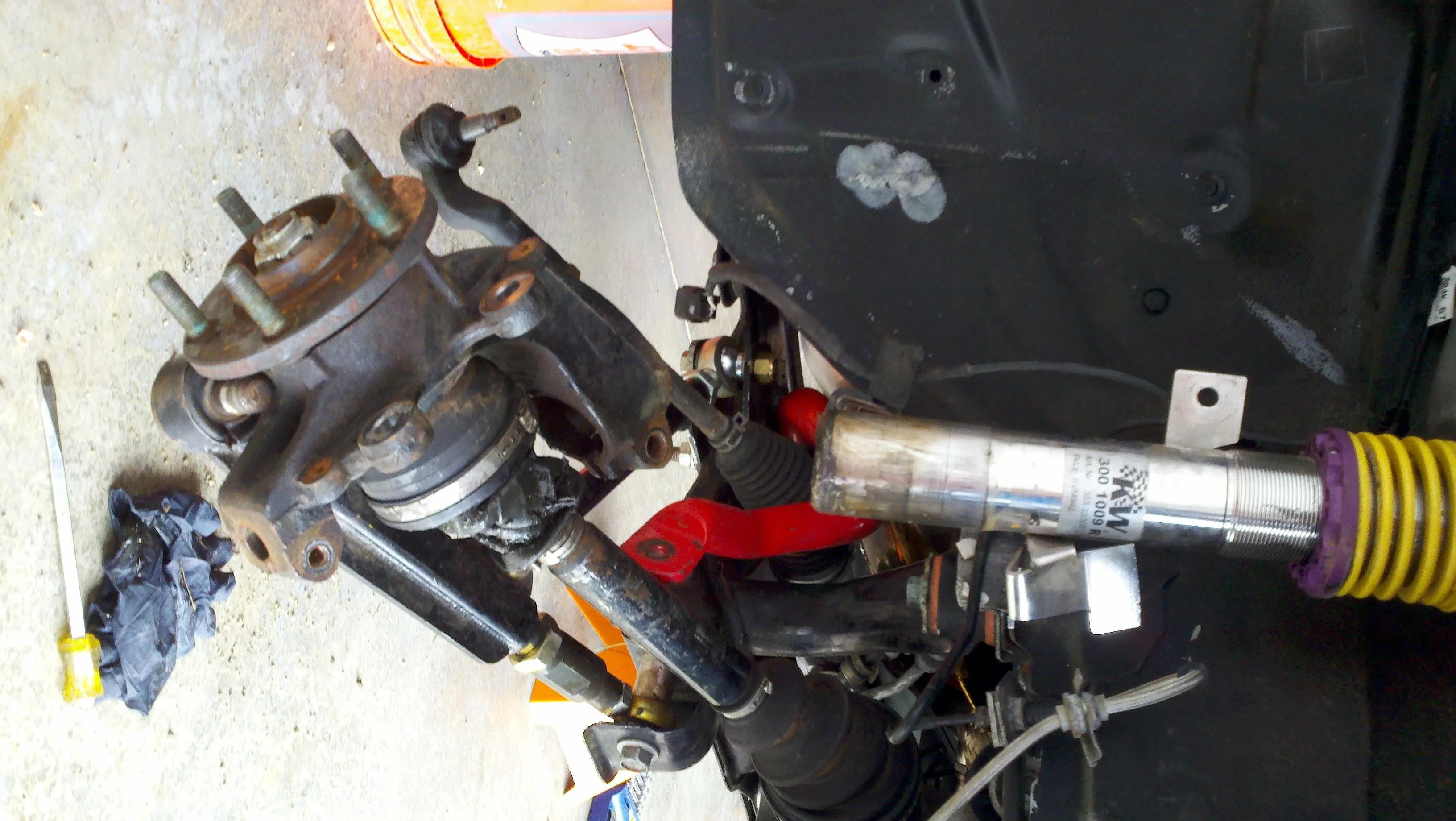

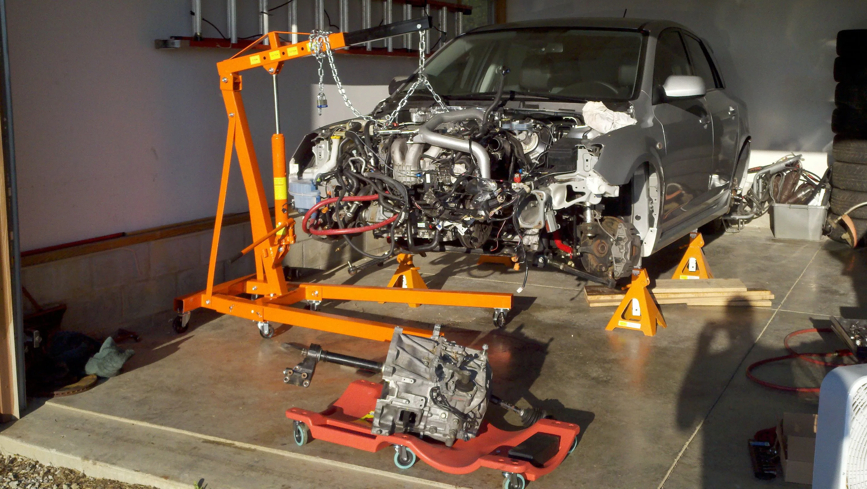

Here is what I did on Friday. My friend's speed had a bit of an off. So I am going to rebuilt it for him. The radiator, AC condenser and intercooler, was smashed and pushed back touching the motor. The crash bar and radiator housing were bent and broke. It tore off the oil filter, and broke the piston on the clutch slave cylinder. The passenger side front suspension was hit hard. It pushed the coilover through the knuckle and down on to the half shaft. The Tri Point lower a arm is still straight. All things considered, it really isn't that bad. I removed everything up front to give it a good inspection. And make removal of the motor and trans a little easier. I took the trans home to tear apart and send out the internals to cryo. As well as replace the diff with a Quaife unit. So we are replacing all the broken bits and then some. It only took me 7 hours of knuckle busting. By spring it will be a full on Time Attack race car. Weeee!

Tear apart/build the motor and trans. Using a Rotrex C30-94 Supercharger for forced induction. Will have to custom fab brackets and plumbing and what not, as there is no "kit". The smooth power delivery of the SC will be much more manageable then a turbo. It will also run cooler. Here is a link to the Rotrex web site for more info: http://www.rotrex.com/Home.aspx
Kraftworks uses the same kind of set up on their kits: http://www.kraftwerksusa.com/products.php
Joe(DPTune) and I are talking about tuning solutions for this project. He is the one who is tuning it now in it's N/A form. I want to see what we can come up with together for a ECU Reflash. If not then stand alone. Piggybacks like the Standback don't work so well on the 07+ NA 3's. (Read **** YOU C-PE!)
