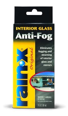

Use something like this? I've never used it before but could be a solution
edit: reviews don't sound promising

I've used that stuff for years & it works to an extent. however if there's an excess amount of moisture, like rain/water on the inside from opening the door when it's raining/snowing, it doesn't work as well. however, i think it works best with a car that has a/c. My old work van didn't have a/c & the windows fogged up all the time, especially during the summer when i was covered in rain water & sweating because it's 80 degrees plus it's extremely humid.
To be short, the stuff works, but it's not a cure all for not having some sort of defroster with a/c.
I used to use Fog-x on my cars before the P5 without A/C. It works pretty well, if you apply it right. Rain-x + Fog-x = win
I like rain-x, I made the mistake one time of buying the rain-x & glass cleaner in one.
I looooove Rain-x. But again, you have to apply it correctly or else it will make the street lights all streak over your windshield. Tessa won't let me apply it to her car because she said she hates it. Oh really, that why when we're in my car I don't even need wipers? Lulz. Dames...
I use rain-x on everything. I even use the rain-x washer fluid. the stuff is wonderful. I also use the rain-x window cleaner & it's pretty good, but not as good as using just rain-x on the windows.

Another trick is to add dishwashing liquid in a spray bottle with water and spray the window, will keep the inside from fogging up!
