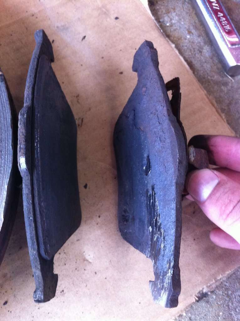

On my Speed3 I changed my stock brake pads at 96,000...
And by waiting until there was no pad material left, I ruined the rotors in the process:

-disclaimer- that pic is from the internetz, that is not one of my rotors! haha
