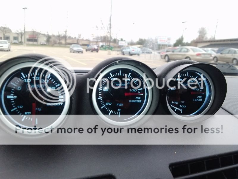

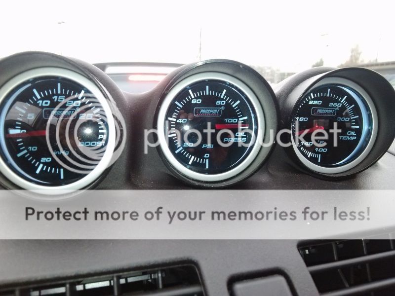

I have Prosport gauges and they've been acting up lately, my temp gauge goes crazy legitimately. Not sure what it is. My connections are all good and tight, all I have left to check is the ground but I don't see how it could be loose with the big ass screw I used.
Previous owner installed them. I did an oil change yesterday and pulled the oil sensors while i had the filter off to check (they are tapped into the spin on filter conversion. Everything looked good. All connections tight, no exposed wiring or anything. As far as the boost gauge, inside the car temp has no effect. However if its above 50 outside it usually works. Theres a little electrical unit for it mounted up near my BPV.

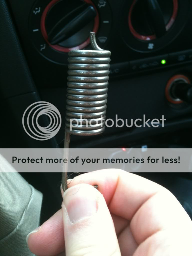

So I get in the car to go to work, press the clutch pedal to start it and hear this horrible cracking sound. Pull the car out of the garage to find this sitting on the floor.
I'm guessing it's some spring for the clutch pedal, right?
Let me know what you come up with. I forgot to mention, while the engine and oil temps are low, my boost gauge works fine and the oil temp gauge sweeps from 100 to 300 degrees non-stop, once oil temp gets to normal temp, then the needle gets stuvk at 300. My oil pressure gauge did the same thing, but now its always stuck at 110psi
Email prosport, maybe they have a fix or a good place to start. I have their premium 60mm in the RX7 for two years now, and have never had an issue.
So I get in the car to go to work, press the clutch pedal to start it and hear this horrible cracking sound. Pull the car out of the garage to find this sitting on the floor. I'm guessing it's some spring for the clutch pedal, right?
rut row...does the clutch pedal have any tension? I'm afraid that might be a new pedal assembly. Those aren't always servicable parts.
The clutch pedal does have tension on it, although it feels different now. I drove to work with no issue but I drove very carefully. (lol2)
It's weird that it was outside the car. I'm not familiar with the clutch setup on the 3 but most of the time all the tension in the pedal is controlled by a torsion spring in the pedal assembly. I'm not sure what outside the car would have anything to do with it.
Sorry, it was on the floor in the car. Am I safe to drive it at all?
