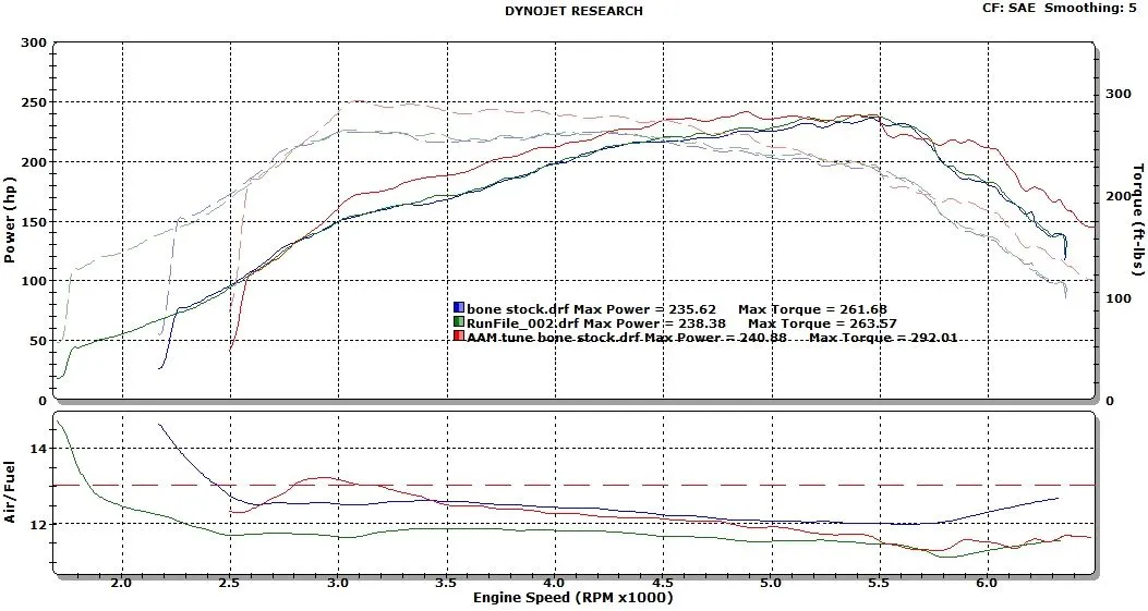

Here are my dyno graphs of stock, standback untuned, and the final Altered Atmosphere tune. You can see that my car actually got richer after installing the standback - which make no sense either btw. In any case the bone stock run was already pretty damn lean - though the afr was being measured at the tailpipe with stock cats but it certainly didn't get leaner with the standback installed.

as for your tune. the green line is alot safer than running a/f above 12 utnill 4500 rpm. But hey its your car. Zoom Zoom boom my friend.
