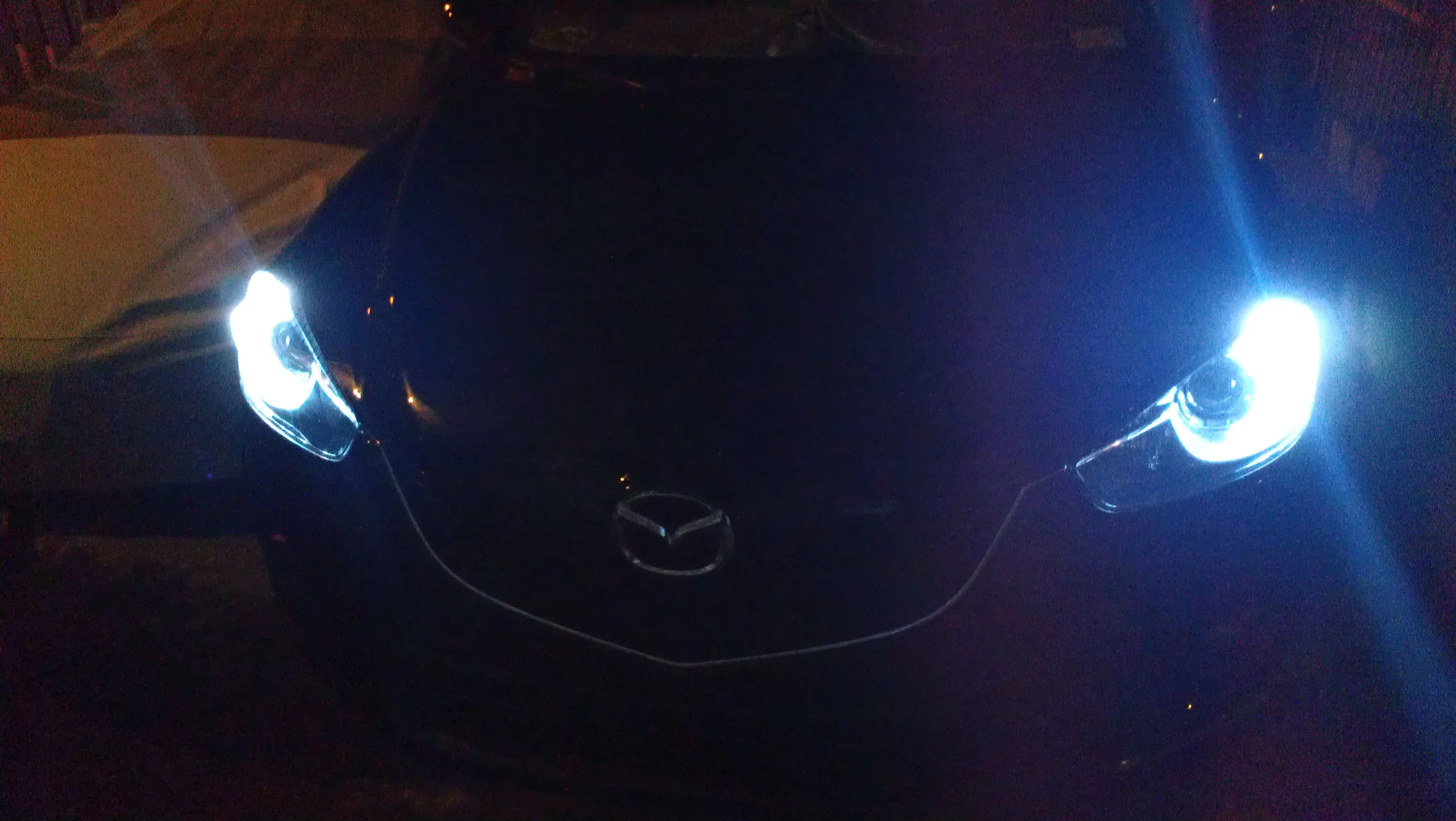

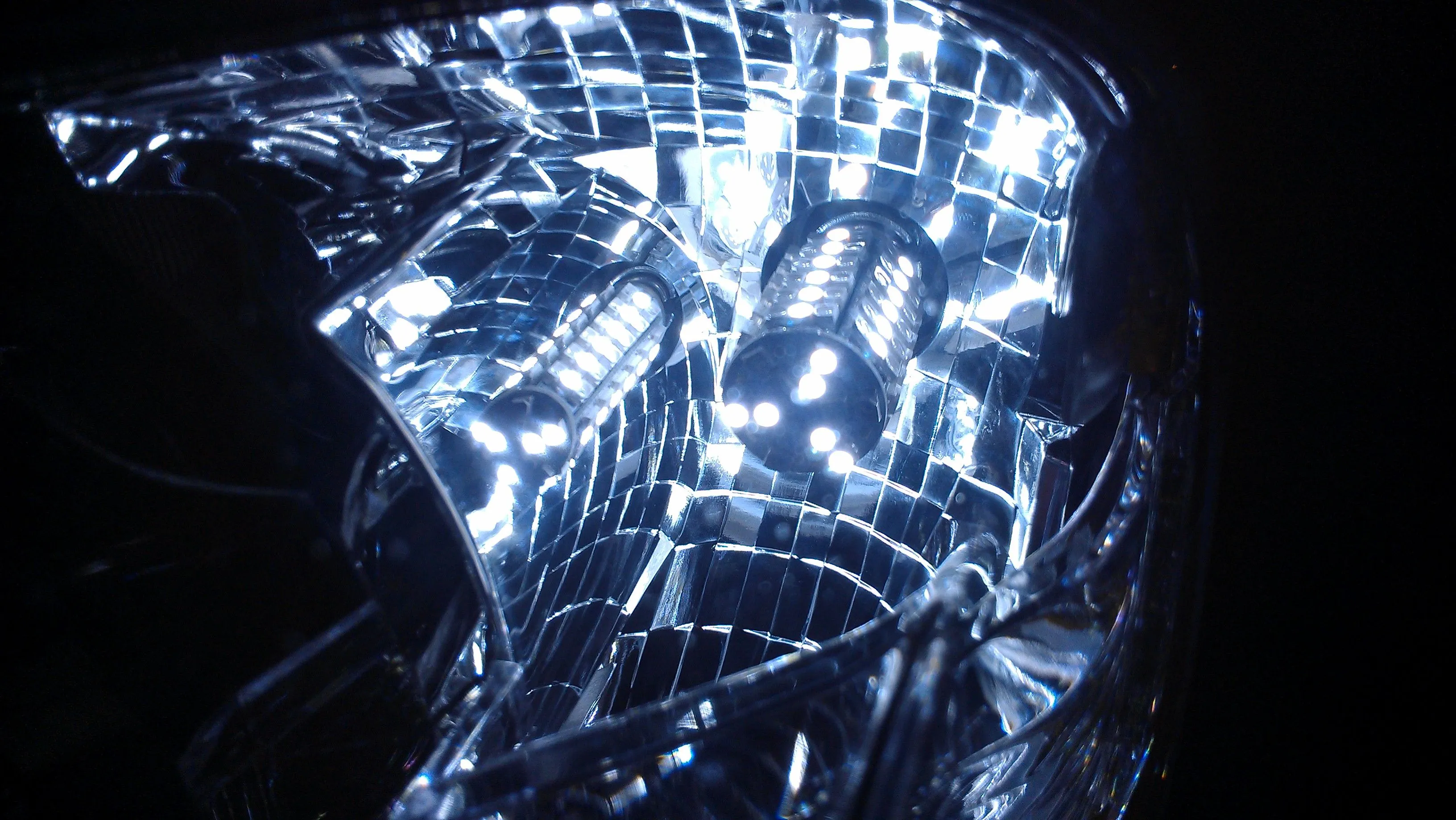

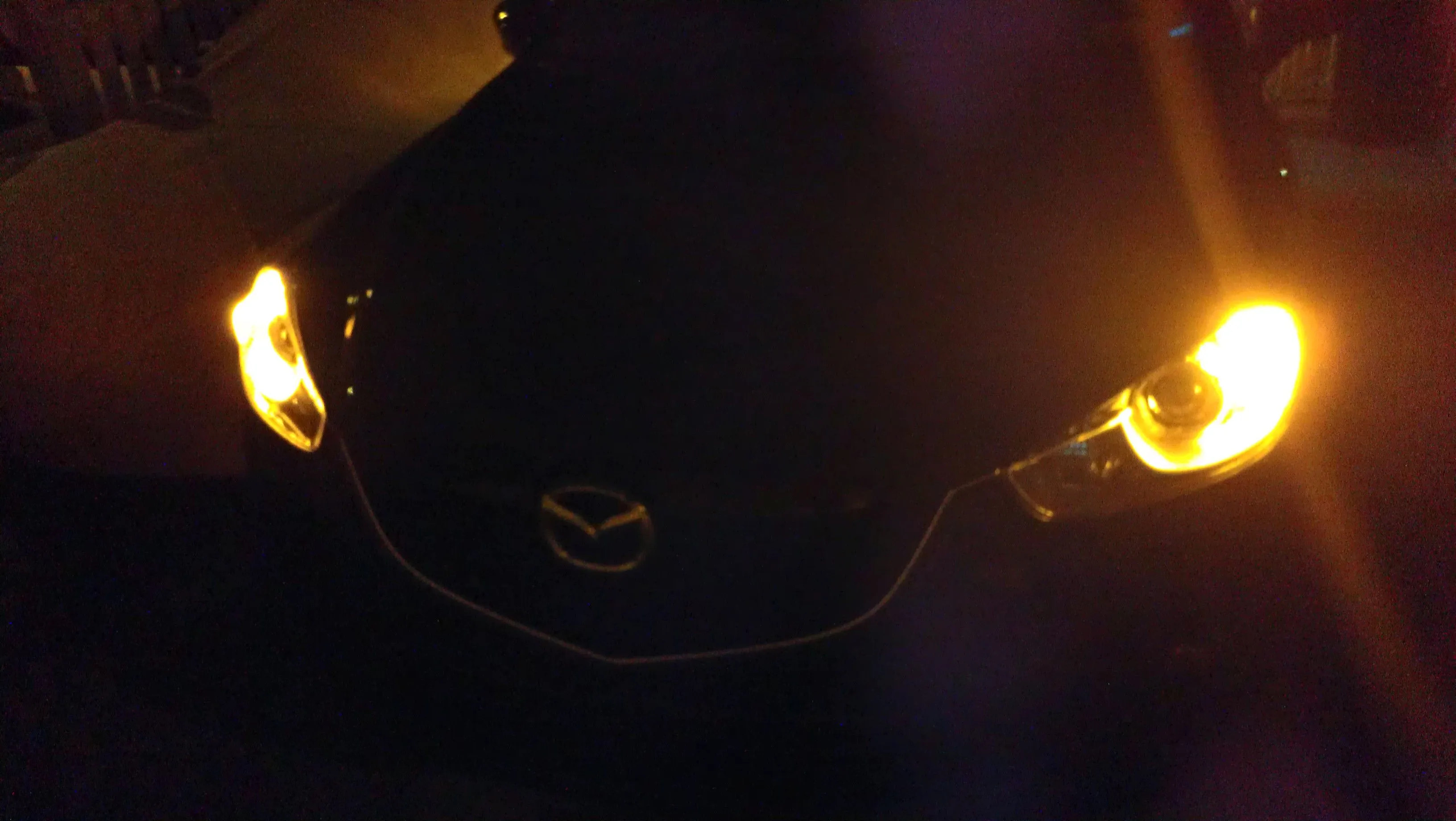

Care for some bad cellphone pics of my new 120SMD type 2 switchbacks? A bit more blue in the pics than in person. More than happy with them as they are quite brighter, especially the 80 amber LED's. When not in signal mode, the white LED's are significantly brighter than factory incandescent amber. Also complements my DRL LED's and Tech pack HID's.
Looks great. Too bad we have yellow reflectors, otherwise the side profile would be white.
You need install resisters for these to not hyper flash right?
I agree on the yellow reflectors. Fortunately, to my surprise. The side profile is still white at night due to the slit in the yellow reflectors. Only close up would one notice the ugly yellow, since it is mostly dominated by the white light bleed.

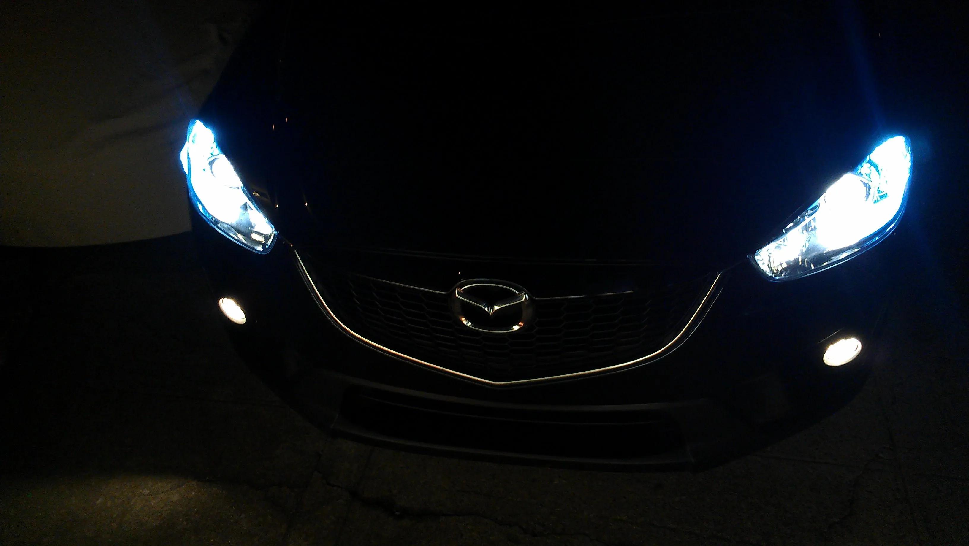

5k switchbacks with cree DRL's , LED fog (old picture now the metal cover in the foglight is removed)

With most LED turn signal replacement units, a pair of load resistors is required. I have yet to install load resistors, but it is necessary. It hyper blinks when using the signals, but is normal with the hazards. Yes, that also means the "3 blink signal" feature completes its cycle within a fraction of a second without the loads resistors. It is so noticeable that even my girlfriend asked about it in the car the first opportunity I got to use the signal. When using only LED front signals, a pair of 6ohm should be plenty.
