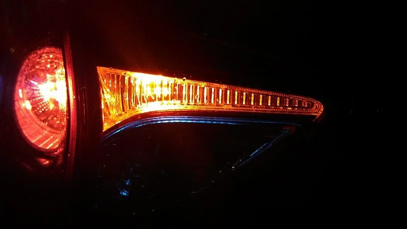

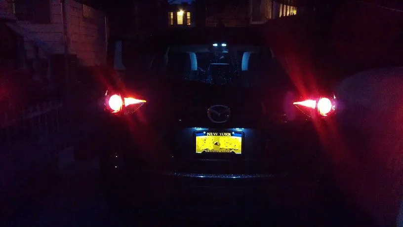

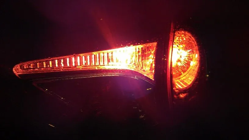

The pictures are from my phone, so color and exposure is a little off. I used a 20 SMD white LED 194 in the left driver side and original incandescent 194 in the right passenger side. As you can tell, the difference is almost unnoticeable. The brighter white produces a slightly lighter color in combination with the red lens, so it looks a pinch more orange. The fill from the many differently angle diodes of the LED also fills the housing slightly better. The only real tell tale sign of it being a white LED replacement is the light bleed at the bottom of the housing on top of the reverse light. You can see that there is a bit of white light bleed. With the passenger side using an incandescent, the bleed is still there but it is less noticeable being that the light is slightly yellow. The LED replacement is brighter, though not apparent with the poor inconsistent camera settings.
I personally see no point in replacing the rear parking light with LED's. I actually prefer the incandescent light spread since it looks like it hot spots at the point of the bulb and gradually dies off near the tip. A nice accent in my opinion.
Yes my interior lights are all replaced by white LED's including the visor mirror lights. Other LED goodies include the rear license plate and front DRL's. I plan on getting dual color switch back for the front signals. The rest I couldn't care less about.
