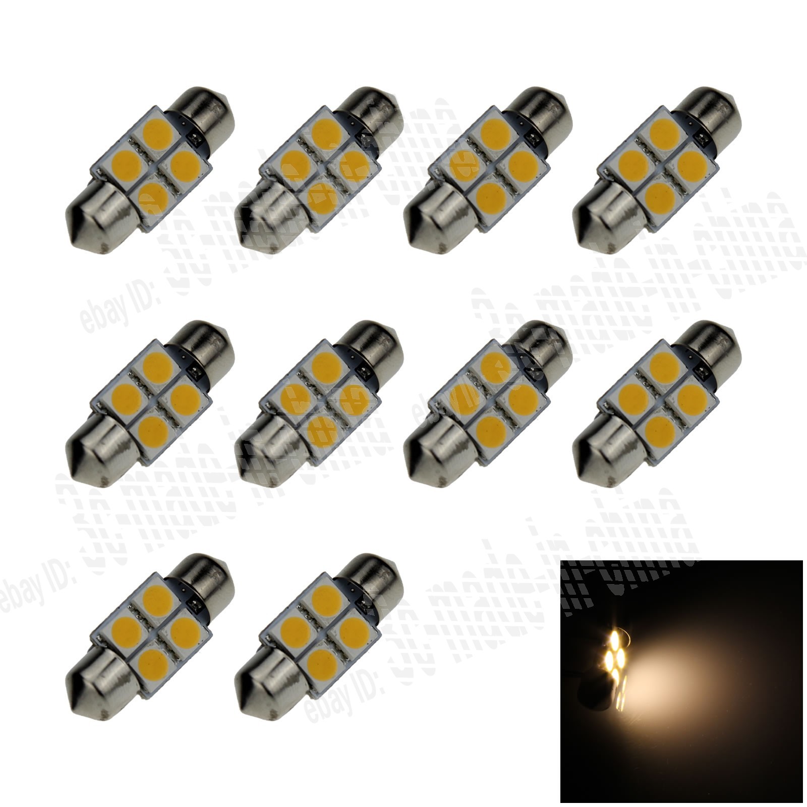

You can get this 10X Warm White 31MM 4 5050 Festoon Dome Map Interior LED Light Bulb DE3425 I003 from eBay for only $4.08 plus $1.99 shipping from Hong Kong. "Warm-white" should mean the LED has 2800K color temperature which looks like standard incandescent bulb. These will match up well with the two warm-white sun visor vanity mirror LEDs you just bought. You need 5 for each CX-5 interior and you'll have 5 extra for spare. By doing this you're still ahead than buying a xenon-white LED kit with a useless tool.
