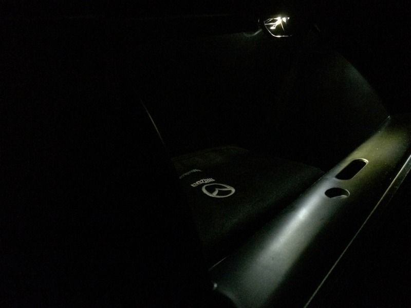

Finally took care of the lack of a glove box light. Minor annoyance. Especially since I've had 80's and 90's crap boxes that had them. Go figure.

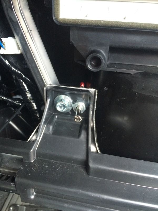

Used a pin switch to trigger the light.
Close up of the light mounted before wiring.
Crazy part is that it looks like the car is prepped for there to be a light. (other than a lack of a harness. I tapped into the illumination wire at the radio so it will only function with the lights on)
Originally I was going to put the pin switch in the blank knock out on the left of the glove box. Unfortunately, there is a brace behind it that didn't give enough clearance for the pin switch.
Where the LED is mounted, there was already a hole in the plastic that looked like it was designed for a light.
The only thing I might do is try to put some reflective material up by the light. It currently is firing towards the rear of the car and it might help direct more of the light into the glovebox. Either way, it is a huge improvement.

Ground is from the pin switch. It is mounted into the metal brace behind the glove box. Hole was already in the metal, just had to drill out the piece of plastic there. Power was sourced from the illumination wire at the main power connector behind the radio. Pin 15, yellow/green wire. This wire will only test with acc/ignition on and with the lights on.

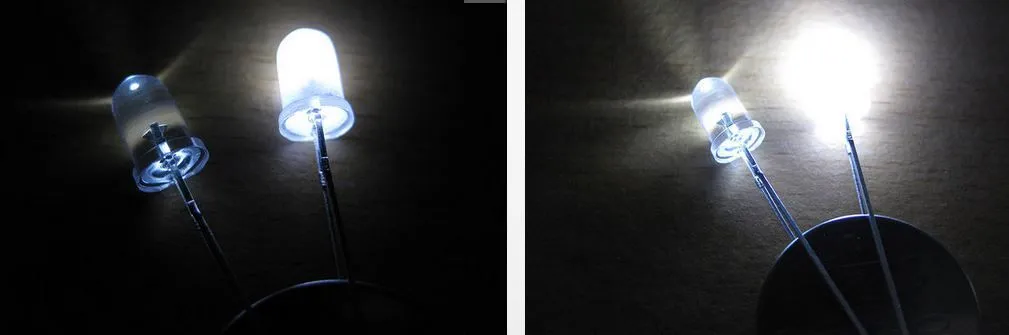

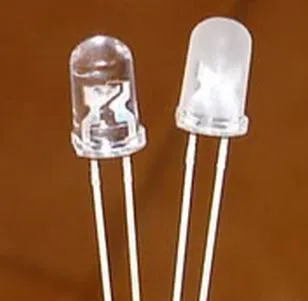

I don't think you'll need to do that. I've used various LEDs to help illuminate panels and spaces in a variety of cars and trucks. If the LED you are using has a plastic lens covering it, take some sandpaper and rough up the clear surface so is becomes frosted. The frosted layer will help refract/reflect the LED's light output in a wider area, which should help illuminate the glove box a little bit better without the need of adding some reflective material.
I'll be using this sanding method when I go to install the LED for my wife's glove box. I still haven't decided if I'll be using the same type of LED light/holder you got, or using the plastic base/holder from an alarm and a clear LED. The latter will be much easier to use since the hole needed to mount the led holder will be smaller, and the space required behind the glove box will be a lot less.
