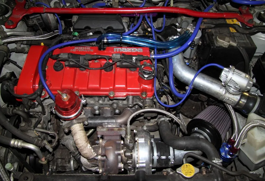

Hello from Russia.This is china ebay journal bearings T3/T4 turbo on 2002 Protege 5. Boost 0.6 kilo and everything is ok!
