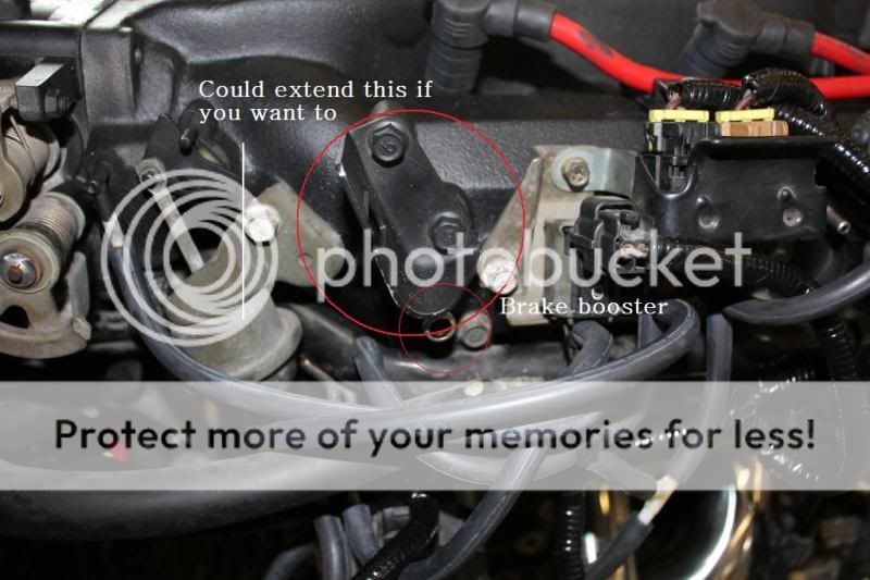

oh maybe yours looks different because its from a milly.. hows your clearance with the brake booster?

Here's a better pic. I didn't have any clearance issues with my intake mani and as you can see, the battery and brake booster are still there.

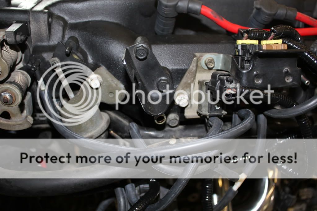

got a bit done today, manifold mounted, vacuum mess started. I have the lines in the generic diagram sorted.. but theres a couple extras on the throttle body. one I know is from cruise control, brake booster and the PCV valve. I'll have to make a parts run tomorrow to get some bigger vac lines. Then I'll start running wires and fighting the exhaust (ebay ftl. whee), then rust proof what I can reach of the engine bay..
will post pics tomorrow.
As for things on the TB there should only be the IAC, everything else should be on the manifold

Vacuum mostly finished (hat tip to Jedidiah) got the spark plug wires all pretty and run (correctly), laid out the wiring and started making sure it all plugs together. I have a few unknowns but I think I know where they came from. Then tucked it all a bit, need zap straps.

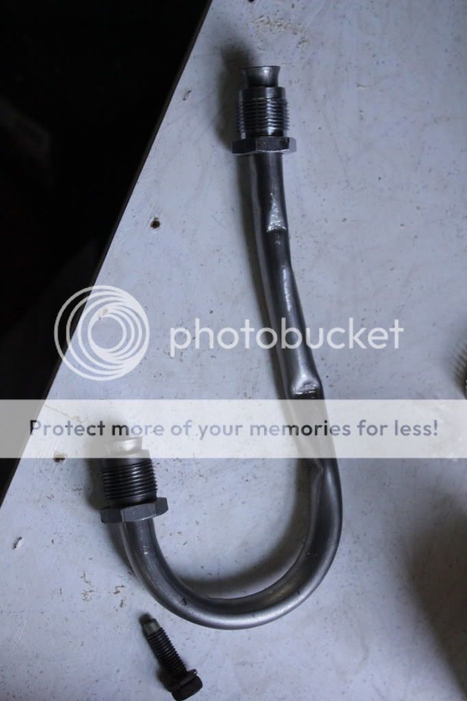

lol I went on a parts run to get the power steering figured out, thankfully I brought the return neck with me. I was trying to avoid explaining exactly what I was doing, as to not boggle his mind (I got the least imaginative guy there, normally I avoid him). He pulled a part number and grabbed the line, which was 3/8. Yaa no.. so a test fit later and I left with 3/4 line. Still need a coupler and I assume the protege's return is 5/8, but since I spent 45 min just getting like 4 things I decided to do it another day...

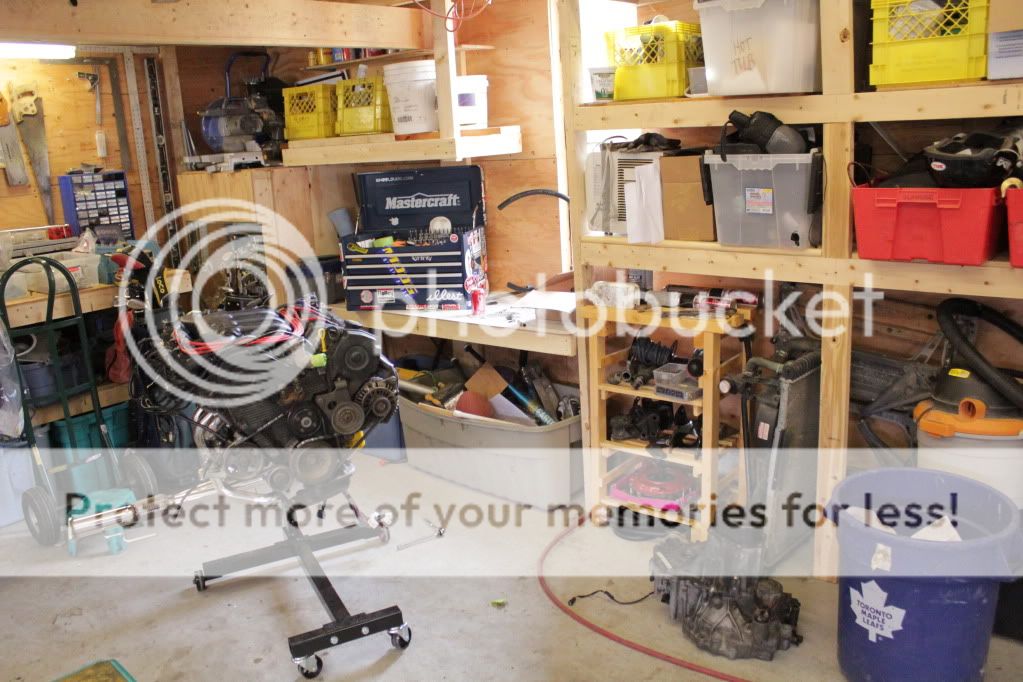

also cleaned up my workspace. again. threw out a bunch of little stuff I don't need

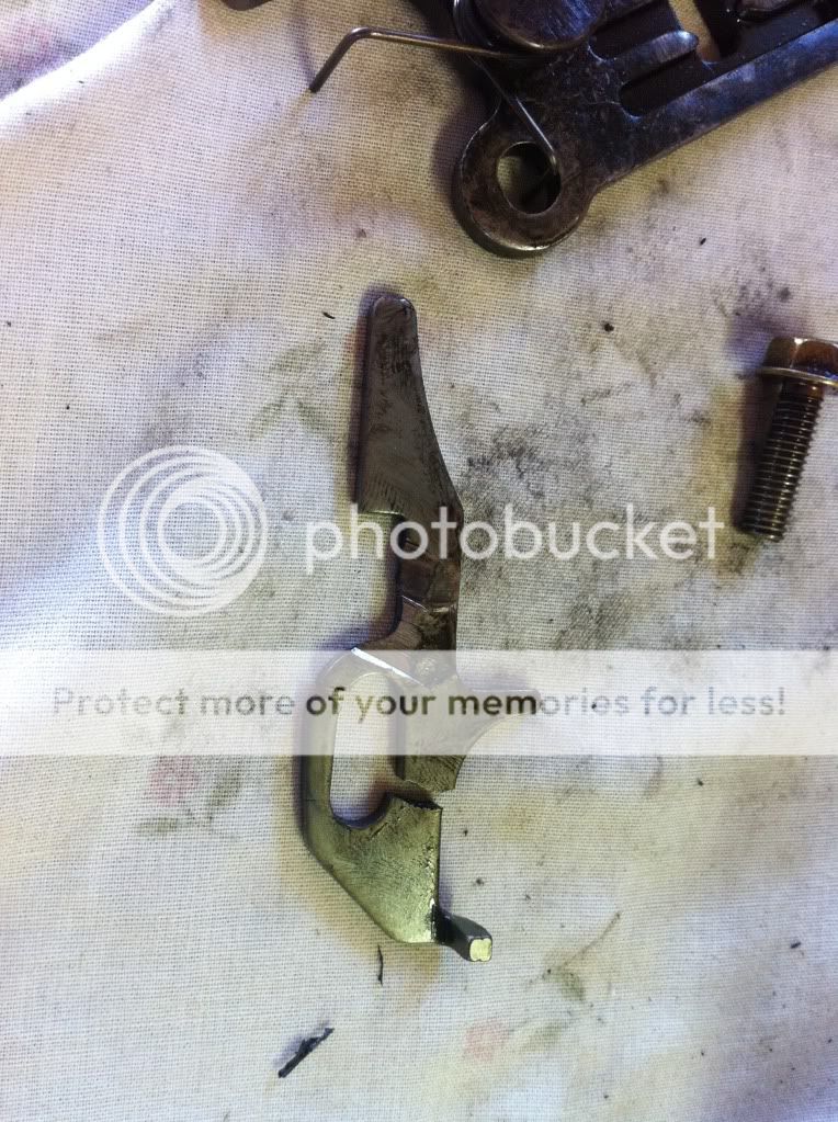

That thing I found in my transmission is indeed the reverse switch, so I will be swapping the gate, oil baffle and 5th gear set from my FS trans on the day of. I also noticed today that the fans on the probe rad (which look beastly) don't have a place in my current wiring harness.. I'll have to make a custom setup that retains the protege's relay setup. Another con into using a probe rad, maybe while I wait for my pics to upload I'll make a list:

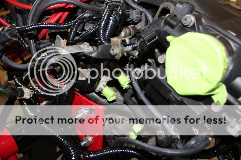

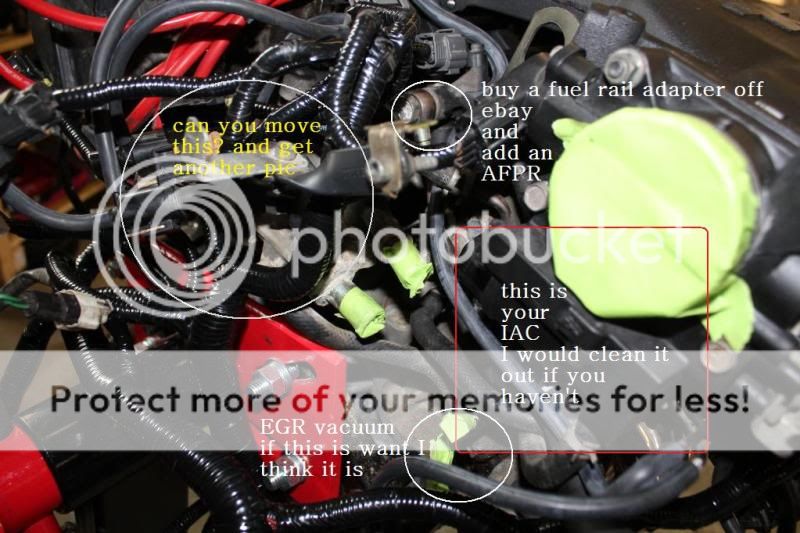

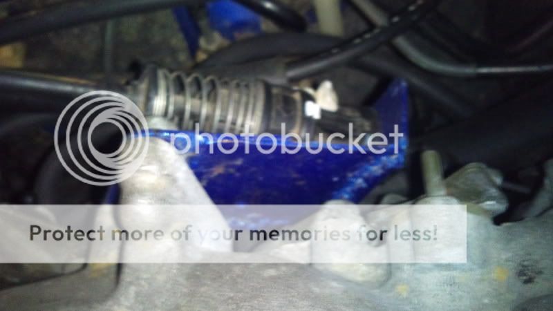

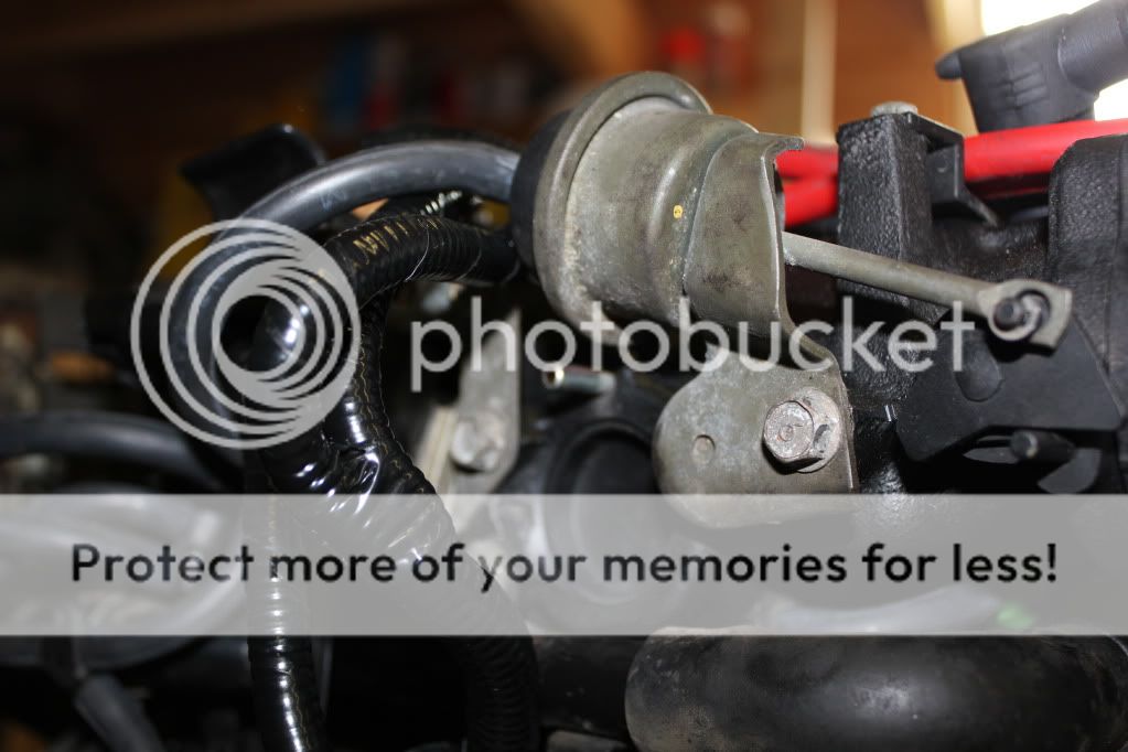

So these are the two vacuum nipples I can't get a definite answer on, I'll assume the smaller one is for the HVAC, and the bigger is for the brake booster. Please correct if I'm wrong. You can just see the bigger one poking from below the throttle cable bracket; which as was stated (jedidiah again) has a waaaay larger gap than the protege.. will have to find a longer/custom cable.
And are these two taped up coolant nipples for the heater core? once again can't find a pic anywhere to save my life. If so which is send and which is return?

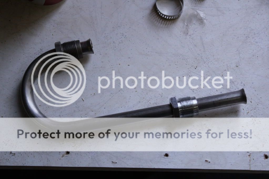

that hose is off a ford taurus i trimmed one end by about 1/4 or 1/4 an inch, i have the part number if you want to stay with the p5 rad to make things easier
and the other hose isn't that you just need a 30 inches 1" to 1 1/4" flexi hose

The P5's high pressure power steering line does indeed bolt up to the Probe's pump. You might have to unbolt a bracing bracket but it's a piece of cake. :)
The low pressure line on the other hand was a total b**** for me. Haha.
It PS high side bolts straight up but its a lot longer

And for the low side you can use your p5 tank but you well need to adapt the probe line smaller or the p5 bigger

I'll do an AFPR later, and probably the HEI, just running out of time at the moment..

lol one more thing, I can get a better pic without that bracket in the way, what is it your looking for? the coolant neck?
those two taped up lines are fuel lines, the EGR vacuum is run already.

i was just trying to figure out what was taped off, i figured it was fuel lines

Ya I taped them off just to keep them clean, green is also easy to spot when the engine's in the car.

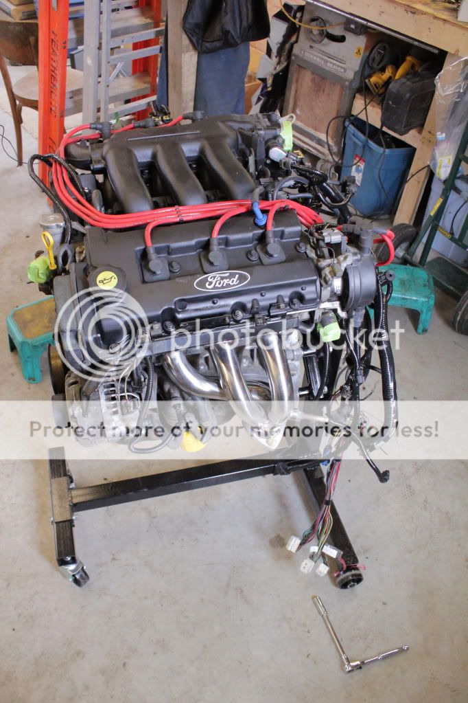

todays update:
was in the garage till 12:30, got a heck of a lot done. Literally have 3 minor things left that I can do before the engines in.
trans is apart
went fluid shopping, still have to get trans fluid. They didn't have a listing for it, I went home did some research and am going to go with 75W-90 GL4 Royal Purple.
have all plugs accounted for on the engine, I know where the others are going except these two. They come off the back of the harness, just past the rear 02 sensors. ABS maybe?

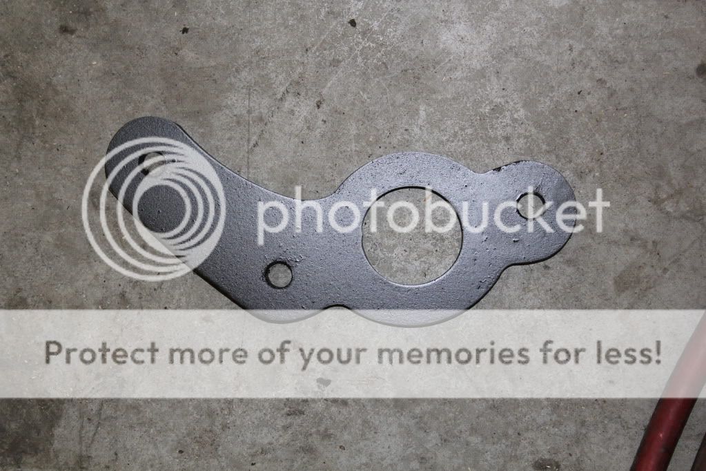

I have my home made tranny saver bracket, I might have made it too beefy though.
One more interesting photo, found the other part of the mystery piece right where Brian_MP5T said.. however it is the part that prevents you from shifting into reverse when in 5th. not the reverse sensor, thats done on the top case.
