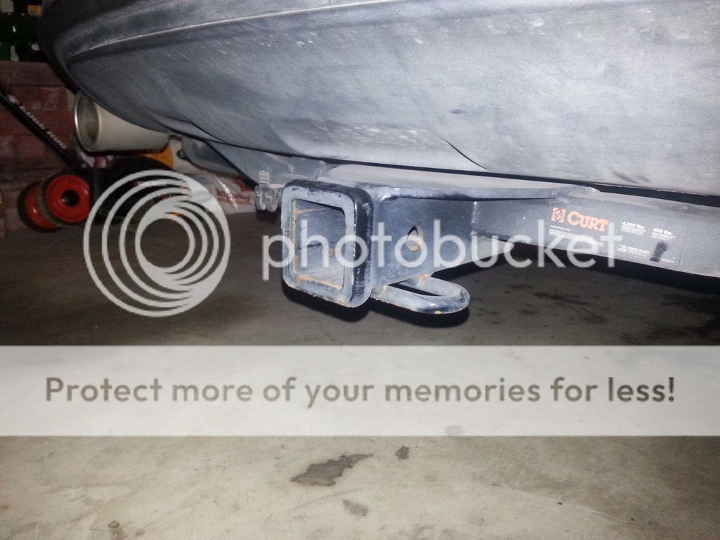

I've got the Curt:
With one of these holding my wiring in place (you can see it on the far side of the opening):
http://www.ebay.com/itm/Tow-Hitch-T...lug-/400958126847?hash=item5d5af77aff&vxp=mtr
