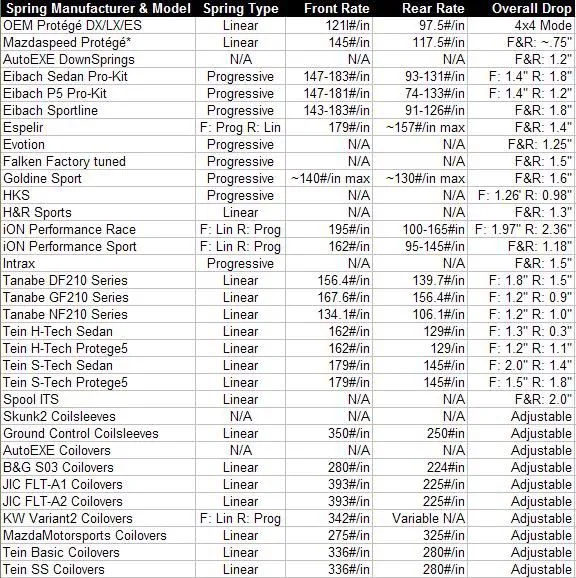

They also aren't on this sheet I usually reference:
Edit: I took the part number and went on eBay and found this, which is not only cheaper at $130, but also lists 1.9"-2" drop front/rear and 280F/230R for what I assume is the rate. Does that sound accurate?
