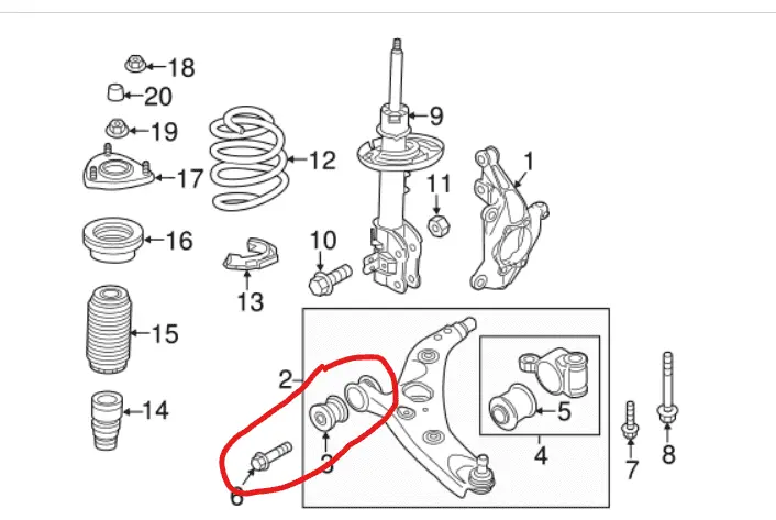

  • Lower Control Arm Bolt: There was one bolt that feeds into the horizontally into the Engine Cradle I believe and it was blocked by the transmission pan so I had to use a 19 mm swivel head bolt with an extension to get into there with the torque wrench and tighten it down to 170 ft. lbs. I did it a second time just to be safe but I am not sure if this may have something to do with the noise.

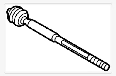

Another note. You mentioned zip tying the inner tie rods. Inner tie rods should not be loose enough to dangle. The joint should be tight and it should be stiff to move and the rod be able to point and stay in any direction it is placed up, down or sideways.

Have you gone back there and taken a close look at that bolt and bushing? Although it sounds, as you said, that nothing should have happened when you tried that bolt, the fact remains that SOMETHING did change as a result of your work, so I guess it's a case of everything being guilty, until being proven innocent.

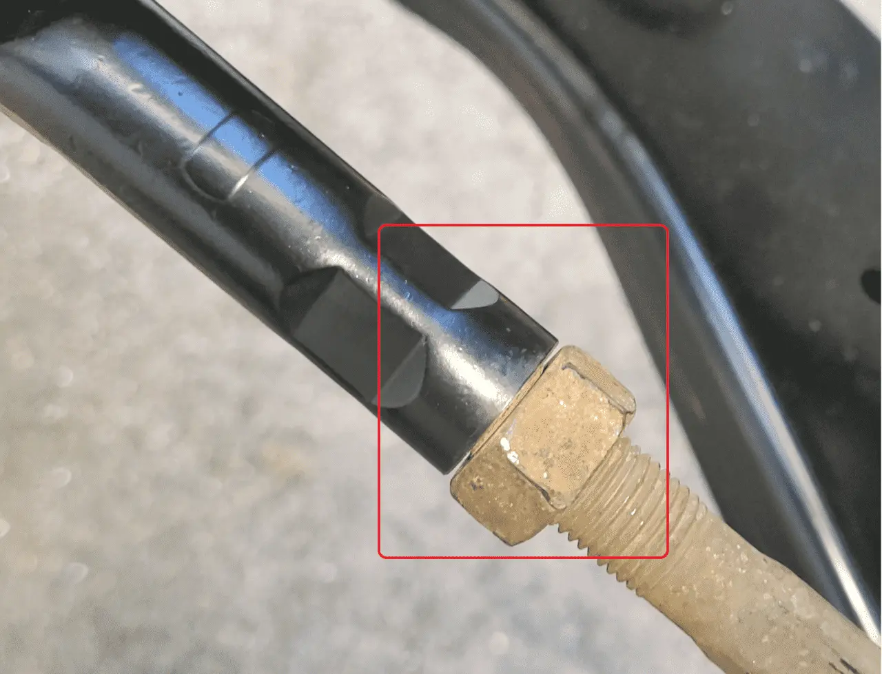

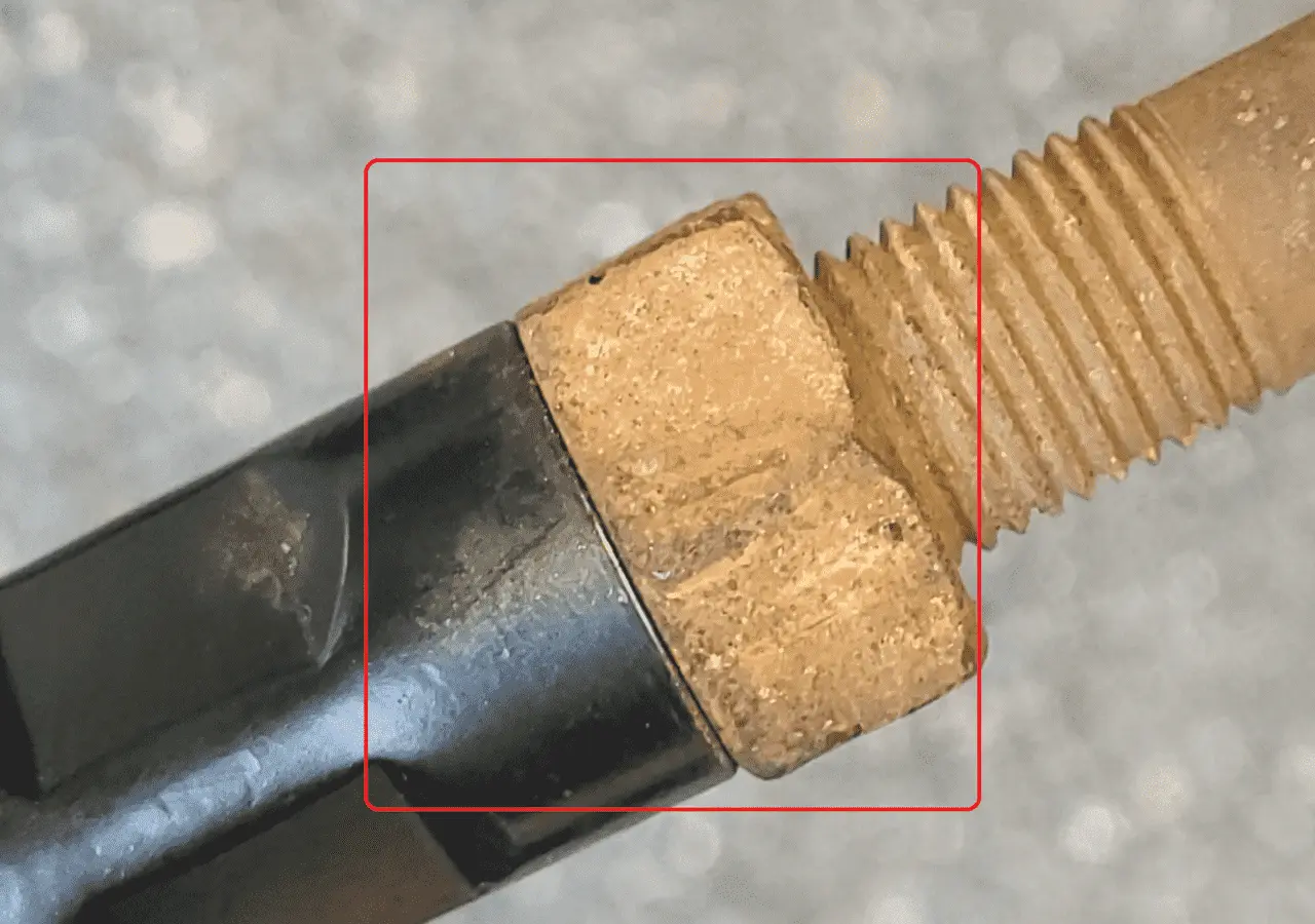

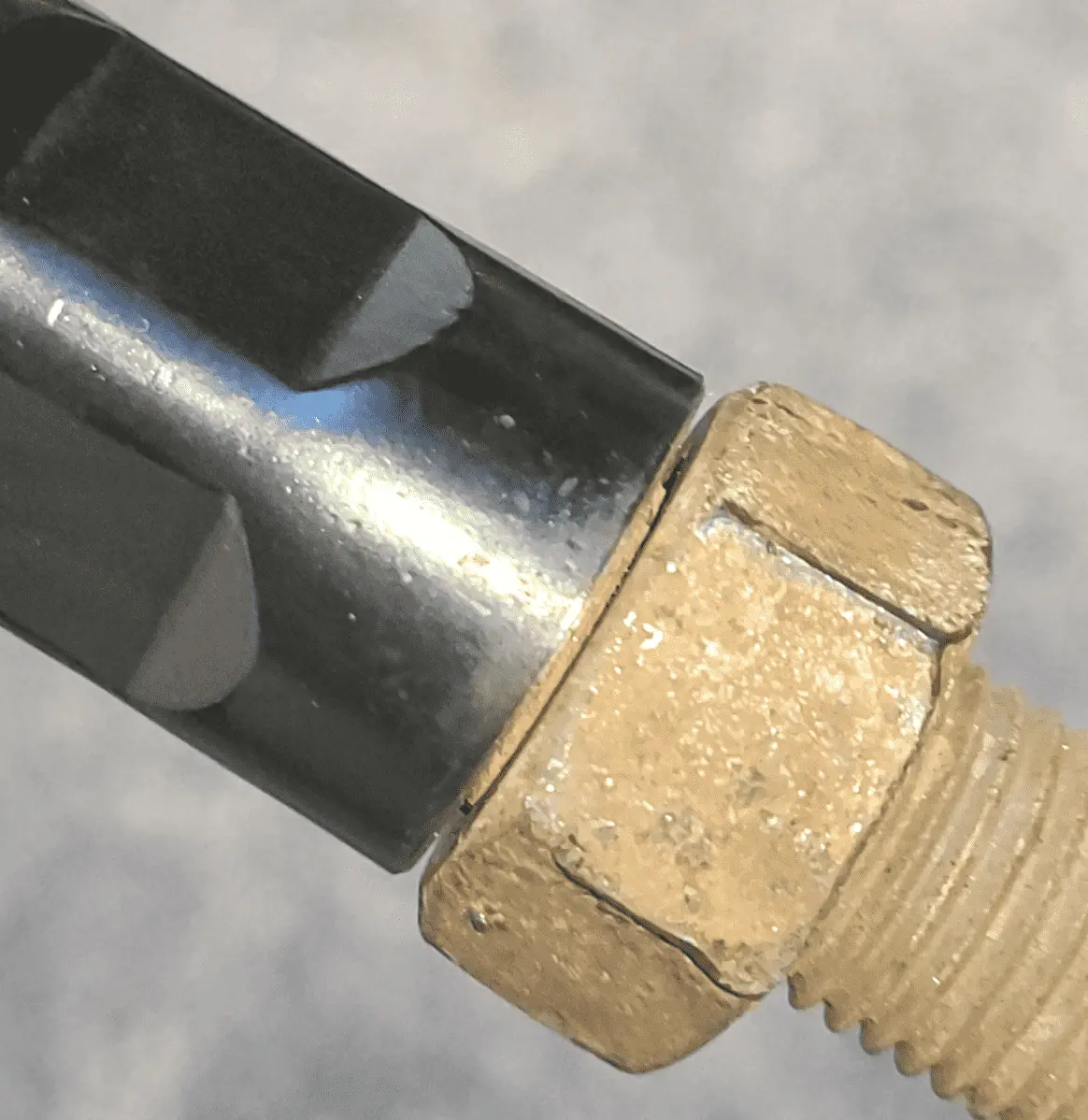

User error as I did not fully tighten the tie-rod end locknut fully on both the driver/passenger sides which resulted in the clunk over uneven pavements at speeds of <20 mph.
Long Answer:
I actually knew about the tie-rod end locknut not being fully tight prior to torqueing all of the bolts/nuts down but I did not know that it would make a significant difference in terms of the clunking noise which was my oversight since I thought securing the lower ball joint into the knuckle would be enough.
I do recall watching a few videos about counting the number of turns when loosening/tightening the outer-tie rod and I followed this same exact process but I'm guessing having to use a MAP torch and loosening the rust slightly affected this methodology since the rust created a seal between the two components. I would say it might be dumb luck or something that I figured it out but either way, I am happy to have resolved the issue. Here's the troubleshooting process that I went through to figure it out:
  1. Rocking the Tires: I had the car on jack stands with the front tires lifted off of the ground and then proceeded to rotate the tires at the 9 and 3 o'clock position to see if there was any noise. I did hear some noise when rocking left to right and afterwards, I rocked the tires at the 12 and 6 o'clock position as well but there wasn't much noise from this angle.
  2. Hitting tires with a Hammer: Based on what I saw from EricTheCarGuy, he recommended using a hammer to whack the wheel at different angles to see if there was anything that could be discernable and I thought I heard something when performing this method on both the driver/passenger sides but I wasn't too sure based on my inexperience so I moved onto step #3.
  3. Prying Components with Bushings: I used a pry bar to attempt to pry the sway bar to see/hear if there was any play or if there was any metal on metal contact but there was nothing. I also used the pry bar to rock the control arm bushings from side to side to see if there was any noise but I did not hear anything as well.
  4. Wiggling Components by Hand: I tried to wiggle the stabilizer bar end links to see if there was any play but there was nothing and I eventually removed both of the sway bar end links from the driver and passenger side of the vehicle. I then used my hands and grabbed onto the sway bars as they are now easily maneuverable and I was able to fully rock the sway bars up and down to see if there was any play with the bushings but there was nothing still except the rubber noise. The next thing I did was wiggle the tie-end locknuts in a back and forth motion. Upon doing this, I heard some play but I wasn't sure if this was normal behavior or not.
  5. Hitting brake caliper/bracket with Tire: Finally, when I was about to put the wheels back onto the wheel hub to lower the vehicle back onto the ground and do a test drive without the sway bar end links, I heard a strange noise that sounded like what I heard when performing test #1 when the rubber portion of the tire hit the brake caliper/caliper bracket. I used this as a hint and kept hitting the caliper/caliper bracket using the tire again repeatedly and it sounded exactly like the clunk noise I was hearing. I did the same exact thing on the passenger side and hit the brake caliper/caliper bracket with the tire and the clunk was not that noticeable if at all. Eventually, I was able to locate the clunk and pinpoint it to the tie-rod locknut and when I grasped the area with where the outer tie rod and lock nut were held together to see if I could dampen the noise while hitting the caliper with the wheel, it significantly reduced the clunking noise.
  6. Tightening the tie-end locknuts: I then proceeded to tighten the tie-rod end locknuts fully on both the driver and passenger side and then reinstalled/torqued down the sway bar link end nuts and went for a test drive over bumpy/uneven roads with <20 mph to see if the noise could be replicated and I did not hear the clunk anymore.
Observation:
  • The passenger side tie-rod locknut had a extremely small gap between the outer tie rod.
  • The driver side tie-rod locknut had a 1-2 mm gap between the outer tie rod.
Tie-rod locknut (Driver)
Tie-rod locknut (Passenger)
Here's a video of it:
