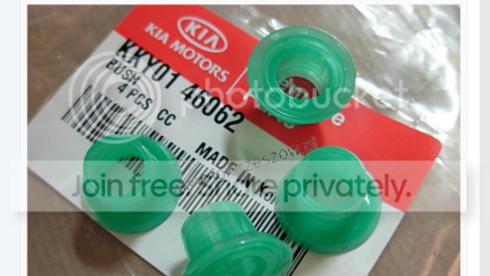

There is something called "bronze oil" bushings available.
(I made my own bushings)

In my case almost all of the slop was due to part #4..
