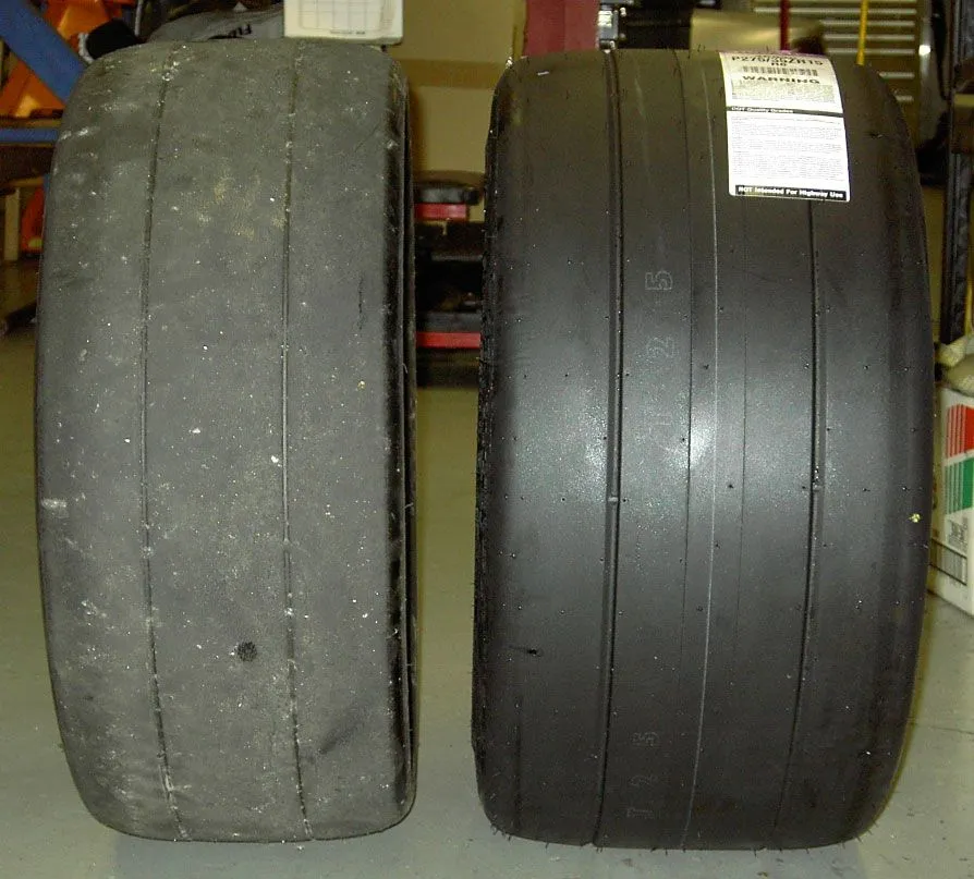

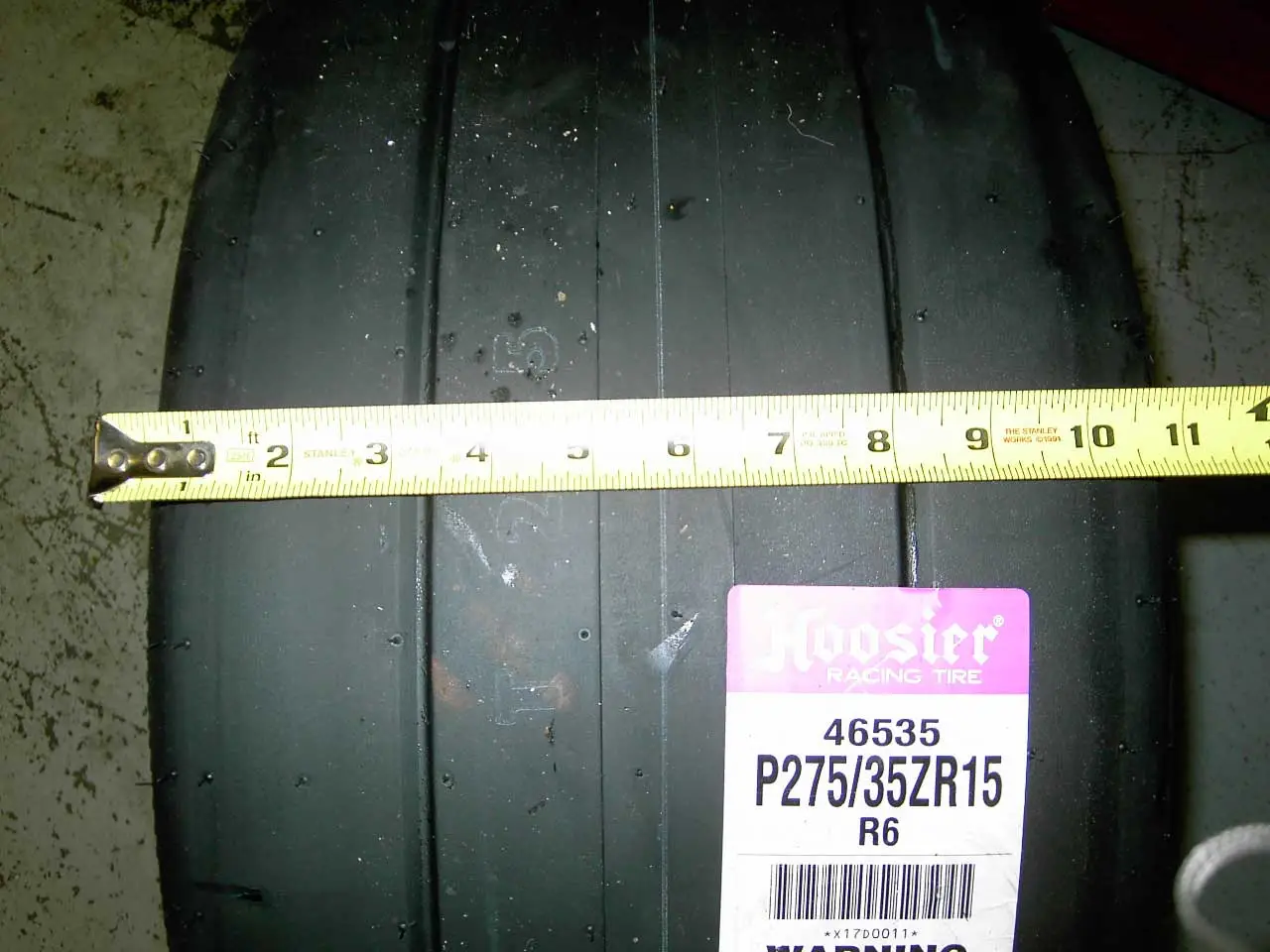

Some nice pics from the miata boards.
Tire on the left is a 225/45-15 according to the OP.

when i saw that pic i was wondering, "what's with the skinny tire on the left?"
that 275 is some serious rubber. you definitely need those, justin. and i'm going to predict some higher spring rates. FTW. ;)
actually, "FTW" would be a 275/30/13. (laugh)
