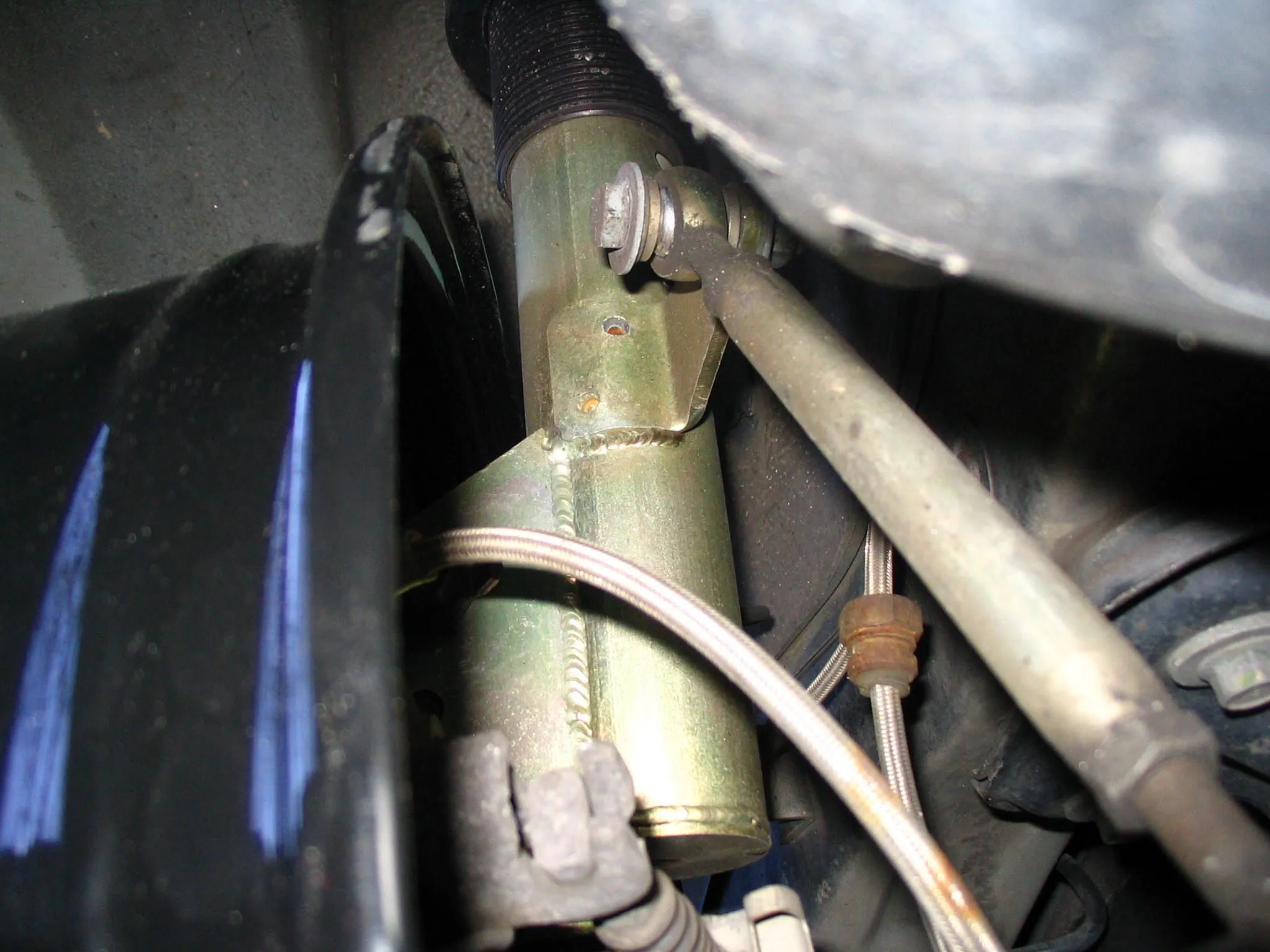

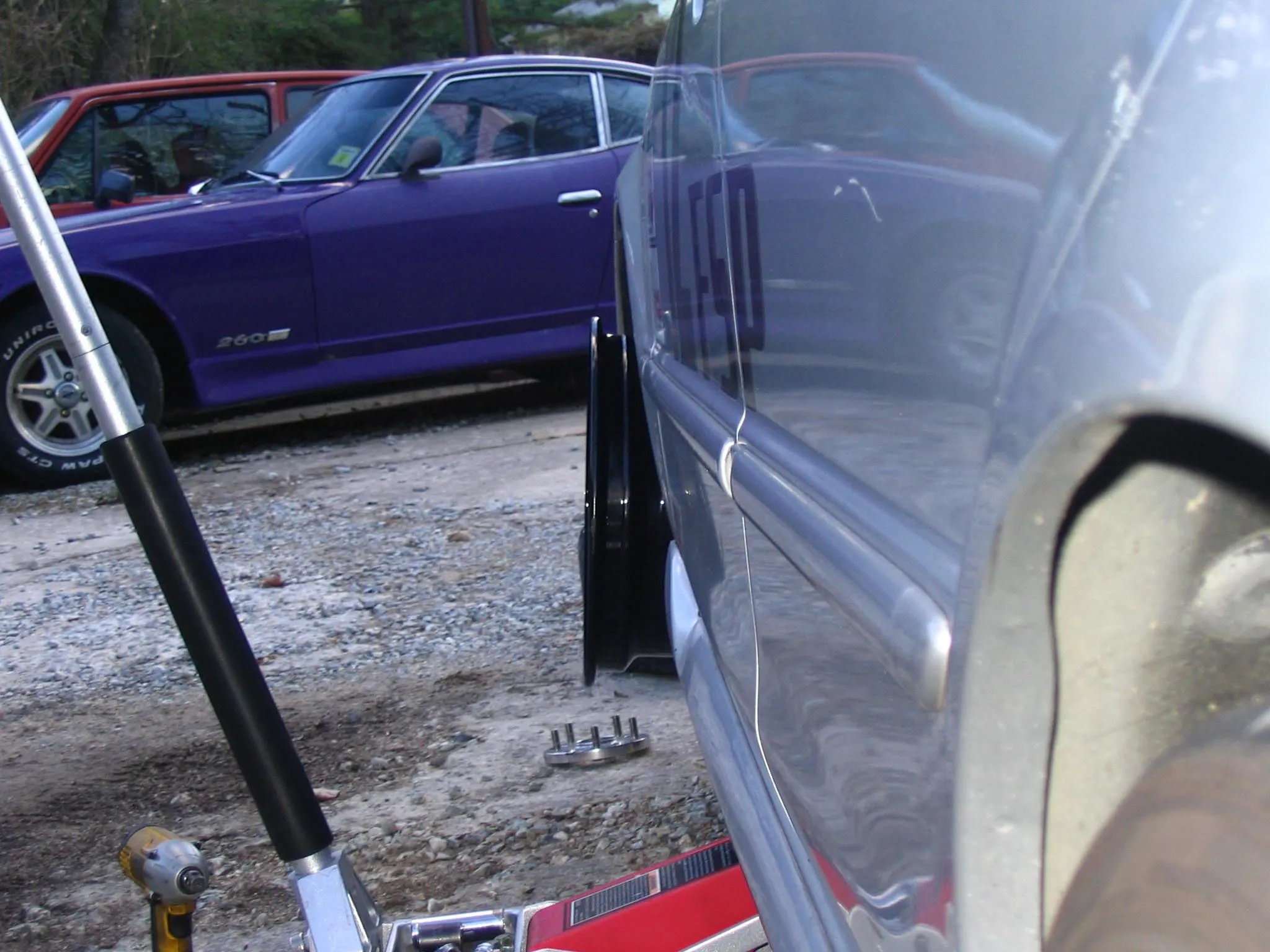

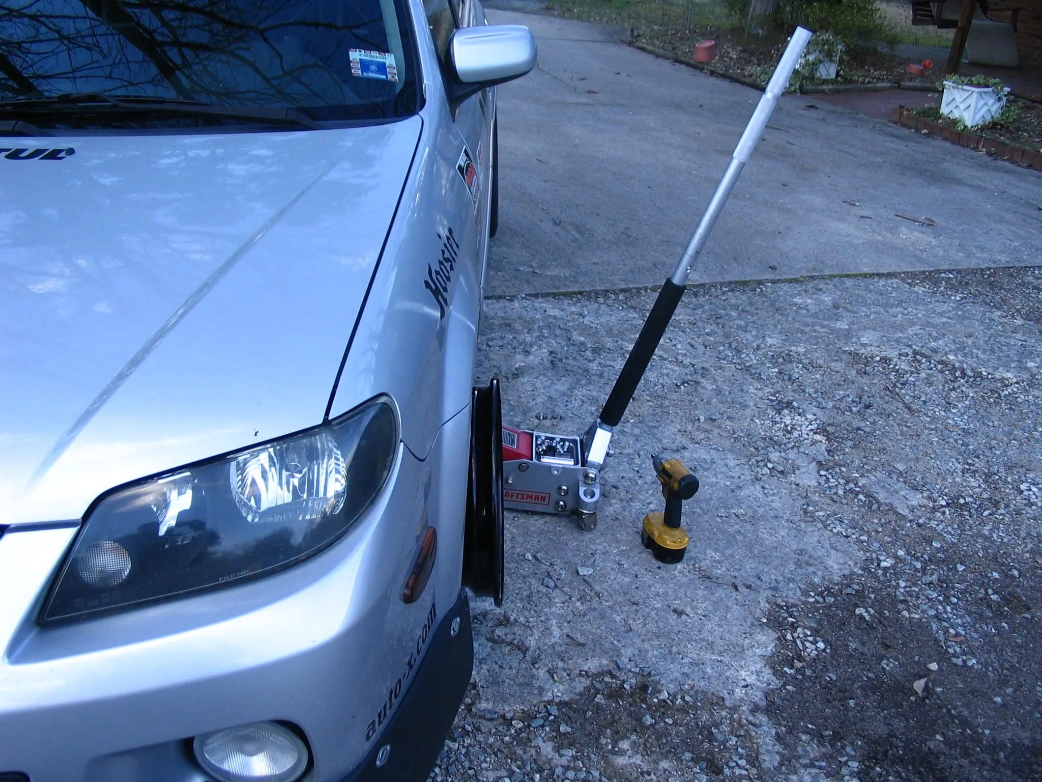

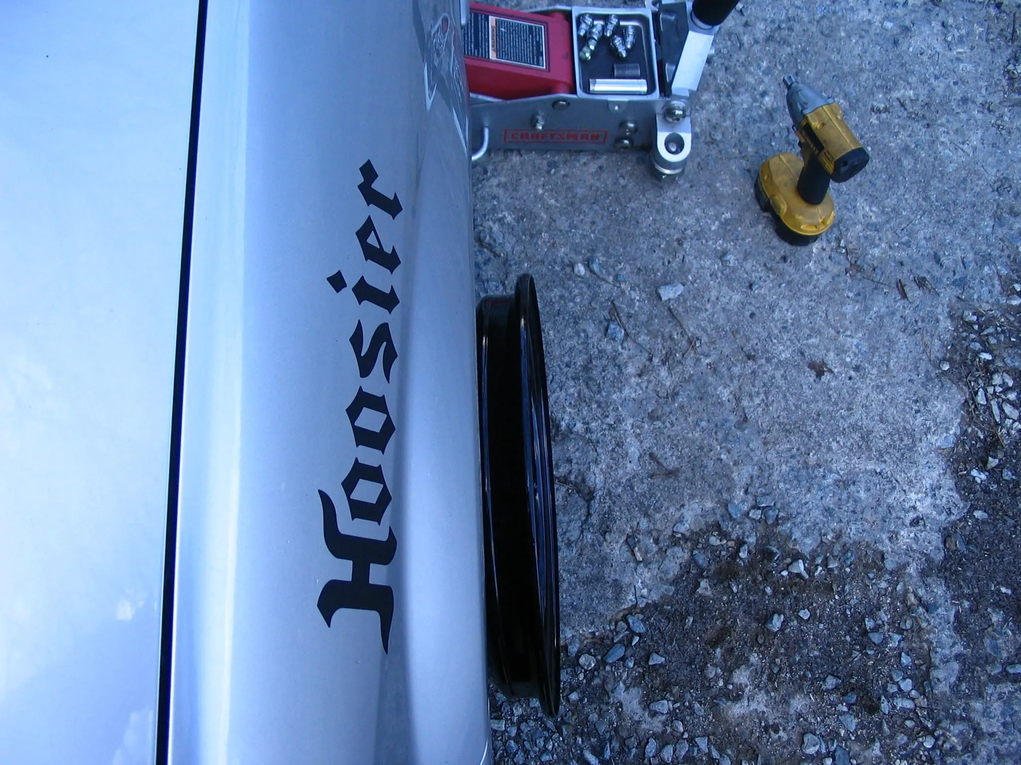

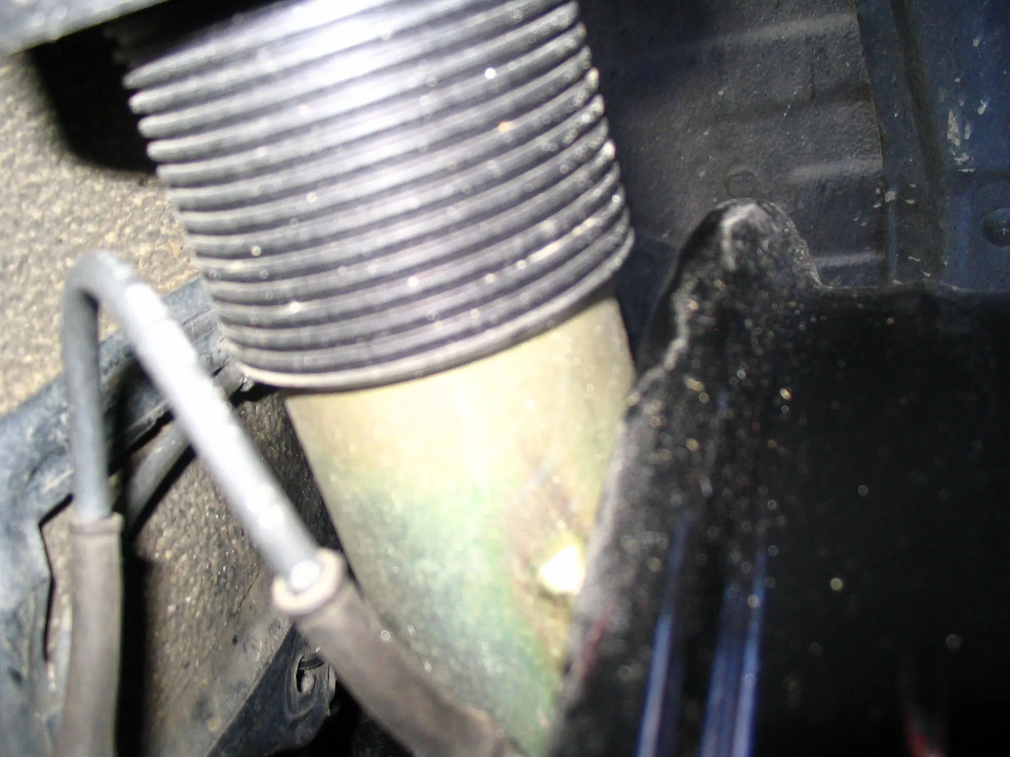

WHeel mounted on the front of the car. No spacer. Everything clears the rim. Tire will be very close if not hitting on the strut and possibly the brake line bracket and ABS wire bracket at full lock.

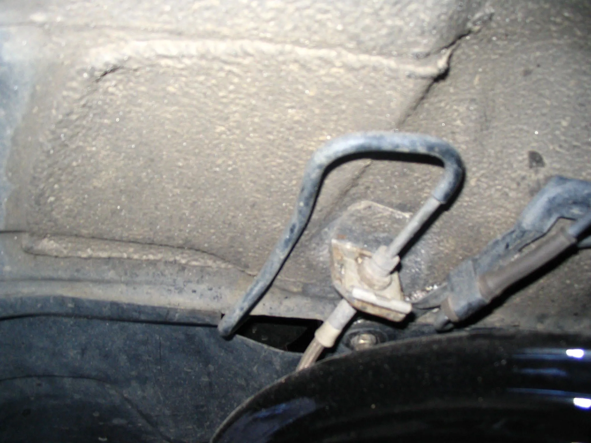

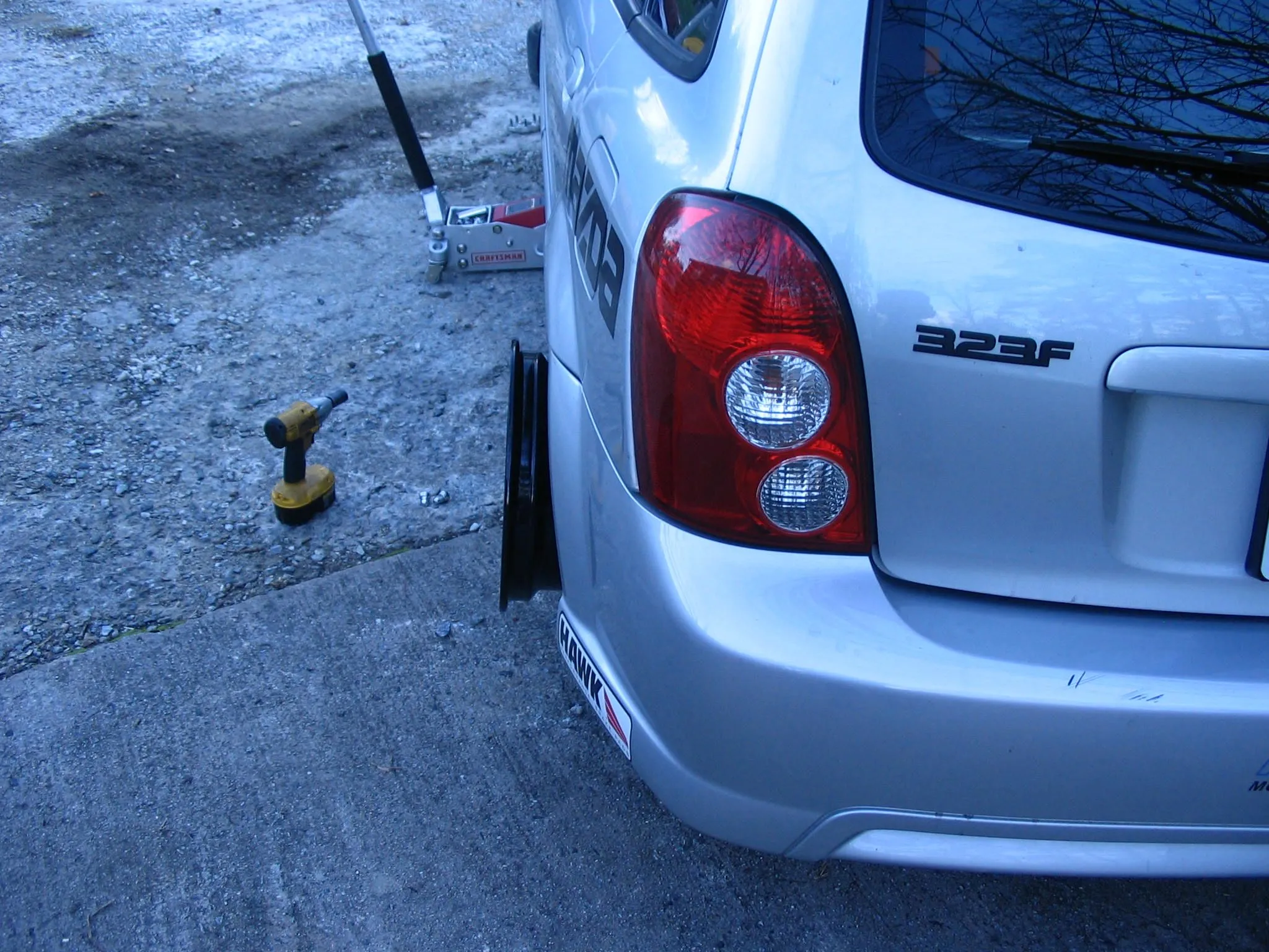

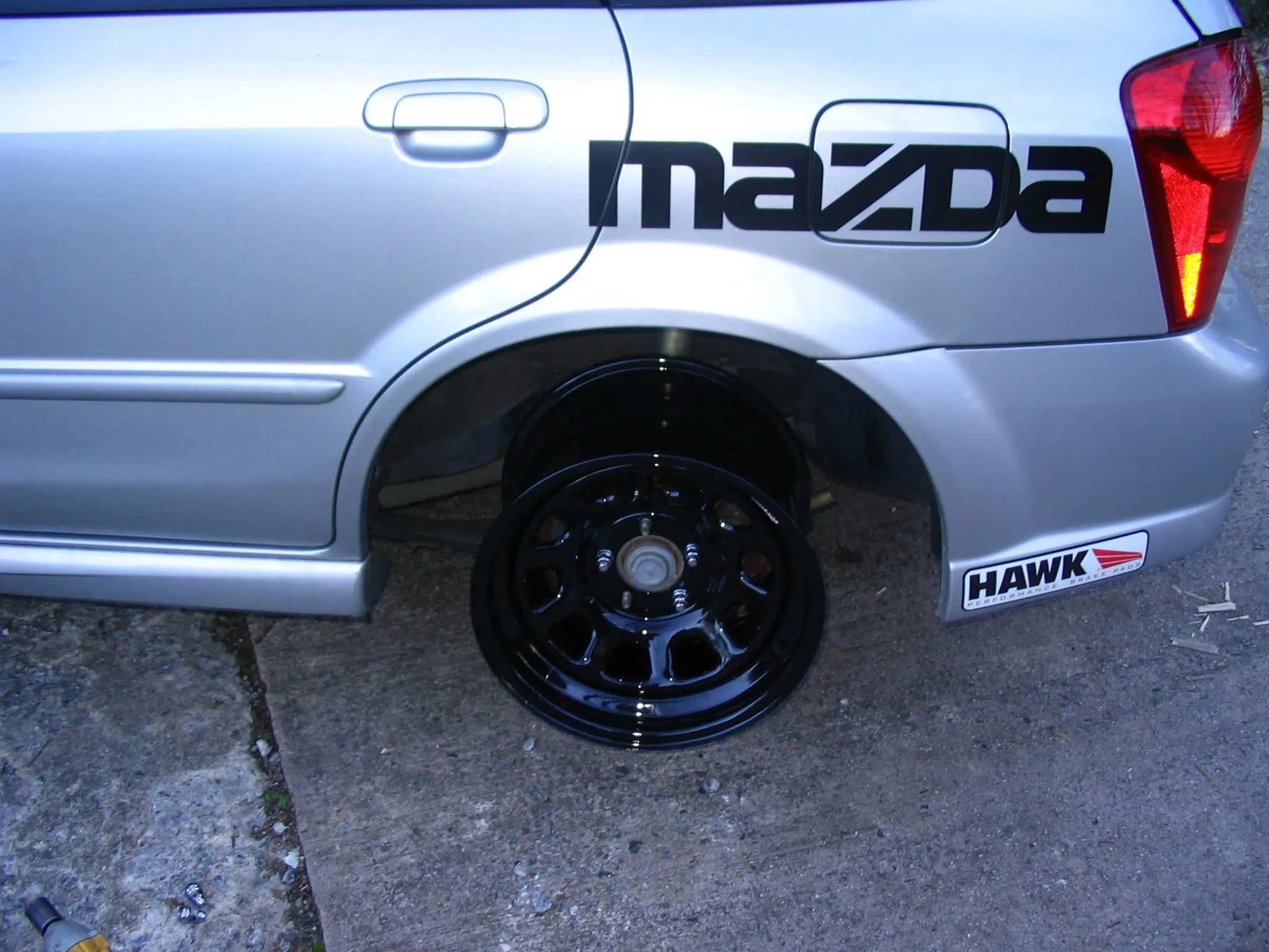

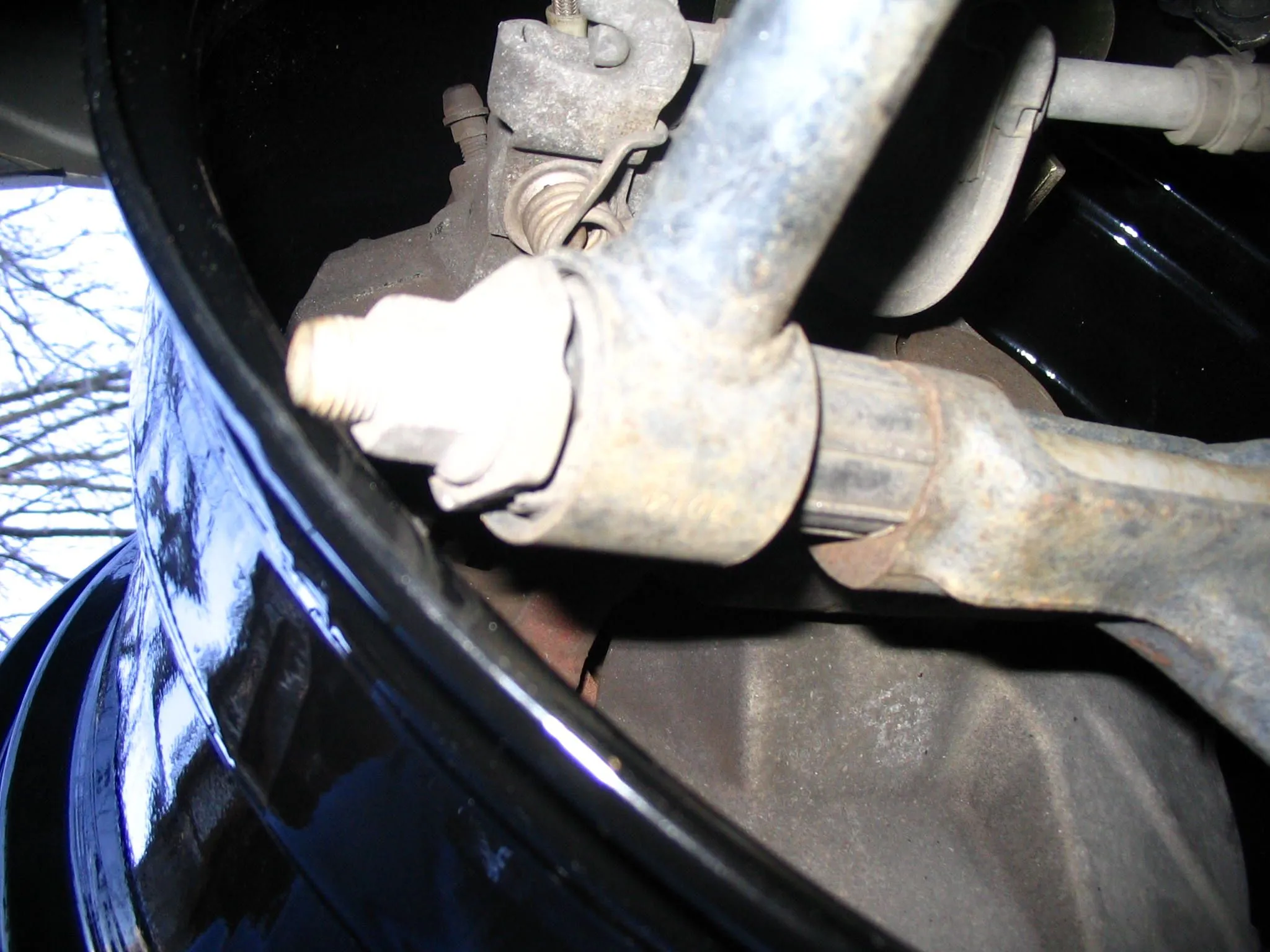

Here is the rear of the car. I had to keep my 3mm spacer on the rear for the wheel to clear the rear lateral link mounting bolt as seen in the 3rd pic.

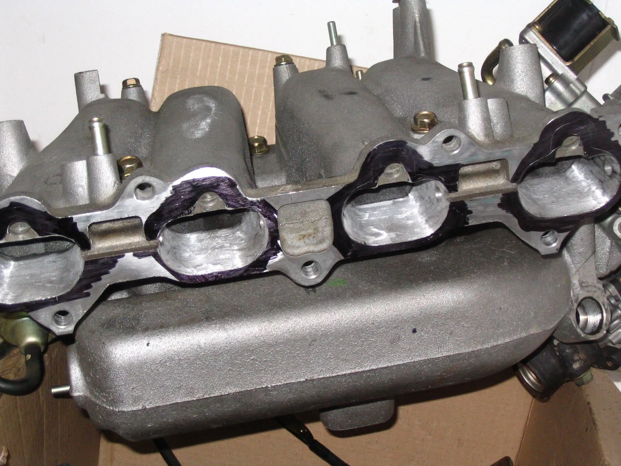

Best I can tell right now I will need somewhere between a 5-10mm spacer minimum front and rear for the tires to clear everything. I'll have more data on that in a few days. I'm working on something else right now. i was having a bad stumbling idle problem and I located the cause today. We originally thought it was a bad manifold gasket so I replaced that yesterday, but the problem actually got worse. I went to work a little peeved about it and decided to install another gasket today. As I was putting on the new gasket I noticed some very interesting lines in the intake throats. upon close inspection it appears as though I have almost cracked the manifold runners off the mounting flange. I guess I should install that rear manifold brace back under the manifold when I put the spare one on the car. I left it off when i was swapping heads and manifolds a lot since it was a pain in the ass to crawl under the car and remove it every time.

It's 4am and I'm bored as hell. Here is a picture of my uncracked manifold hot off the porting table. I'm looking forward to the old girl running 100% again.
Perhaps Individual throttle bodies in the future?
I am going through this now with a hybridized sheet metal intake manifold for the DSP car. It will be lighter and less complex than the stock item. It is a very expensive bit of weight savings though as mine will require full engine management. Ah well, I never planned on being rich anyway.
