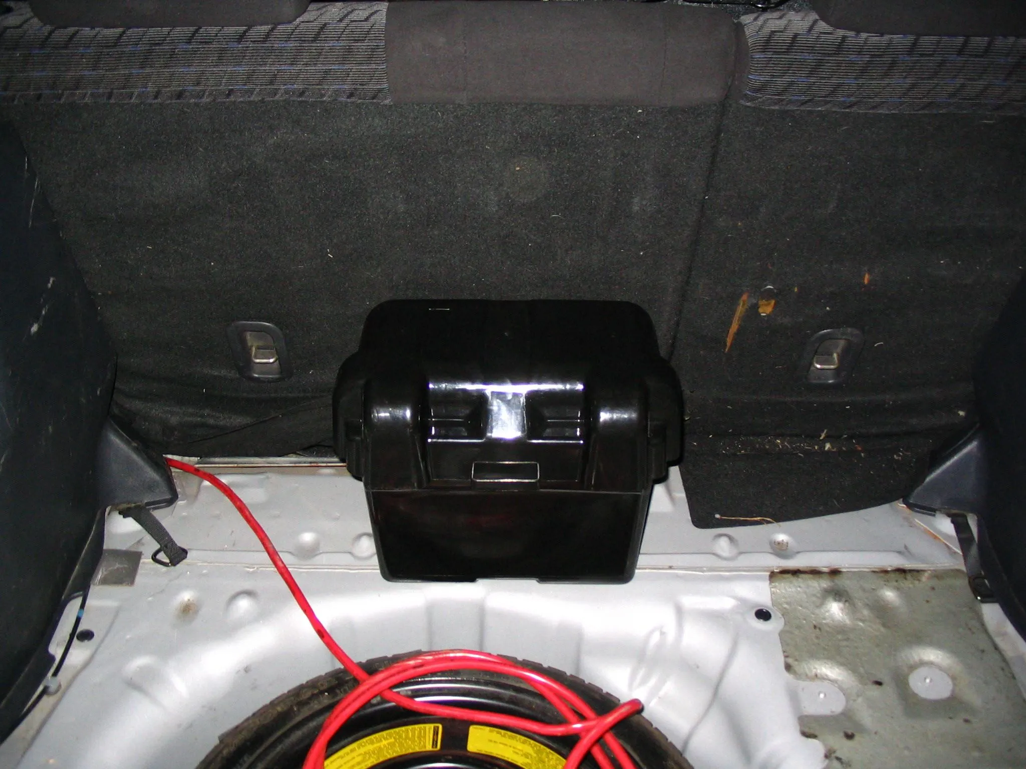

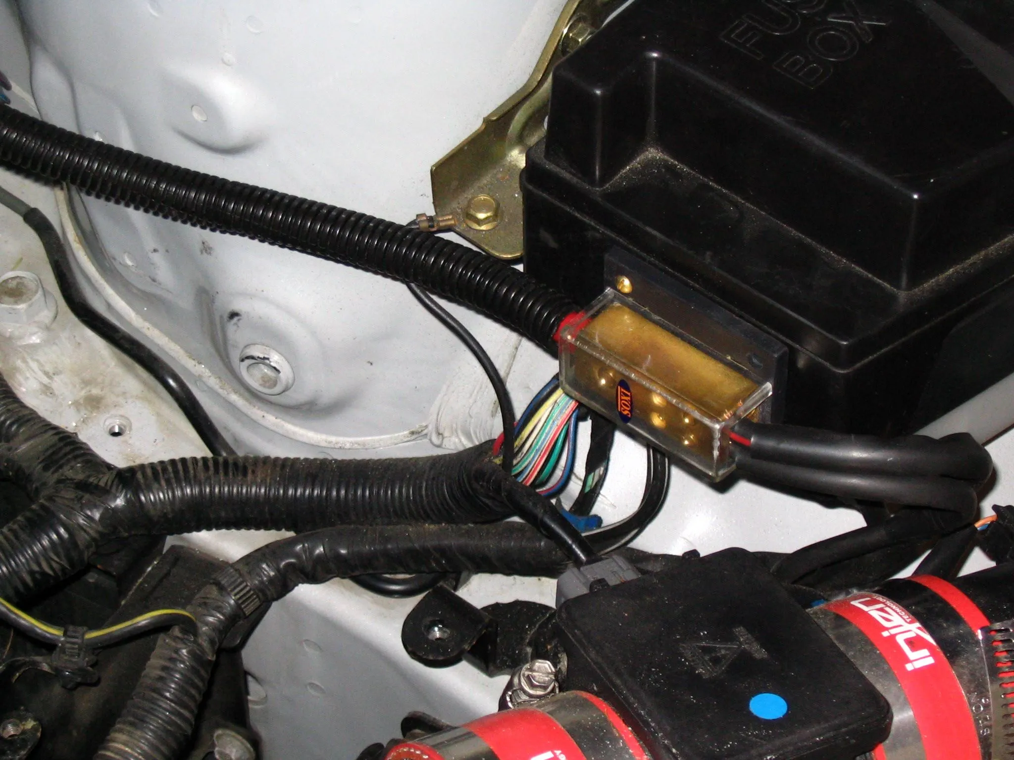

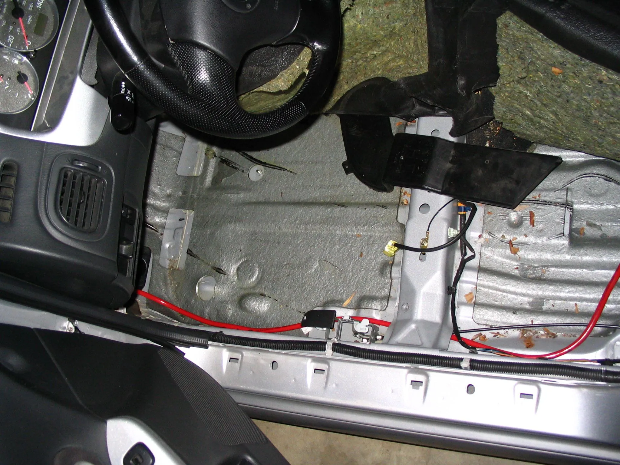

Battery Relocation
I've almost finished the battery relocation to the back. The wire doesn't go exactly where I want it to in the engine bay, but the pipe it's going over is for the AC and will be coming out so no big deal.
