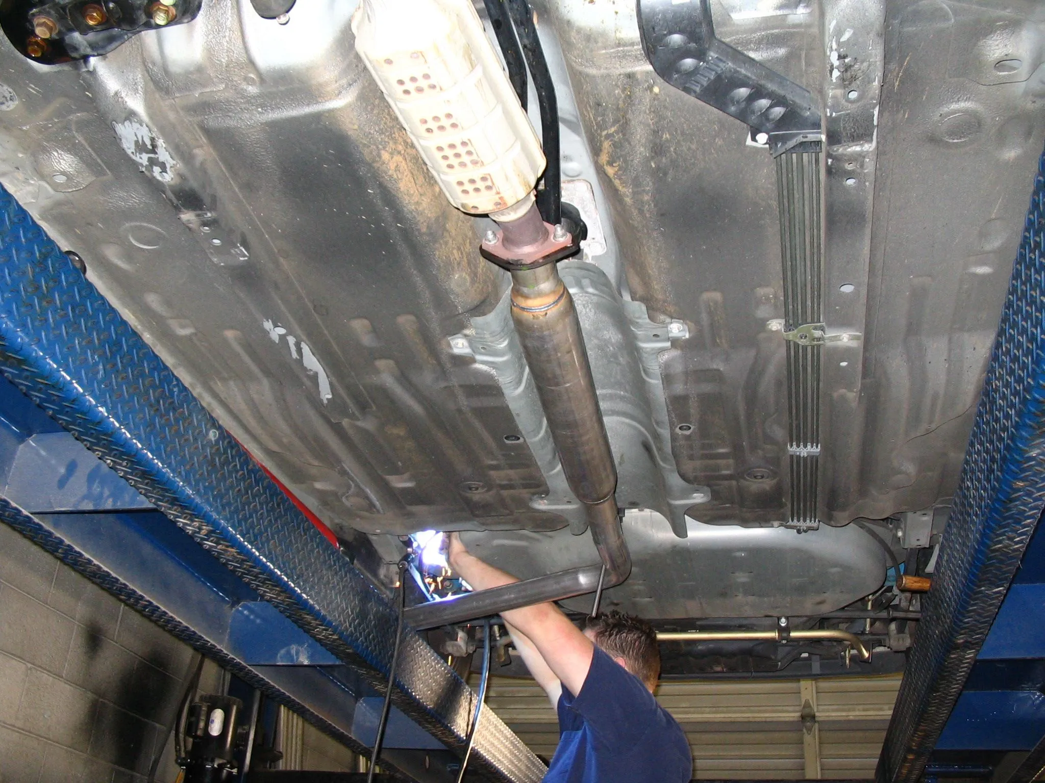

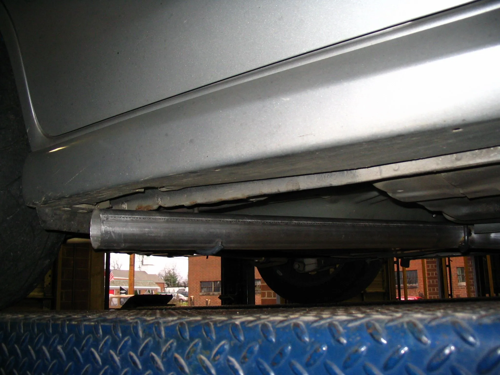

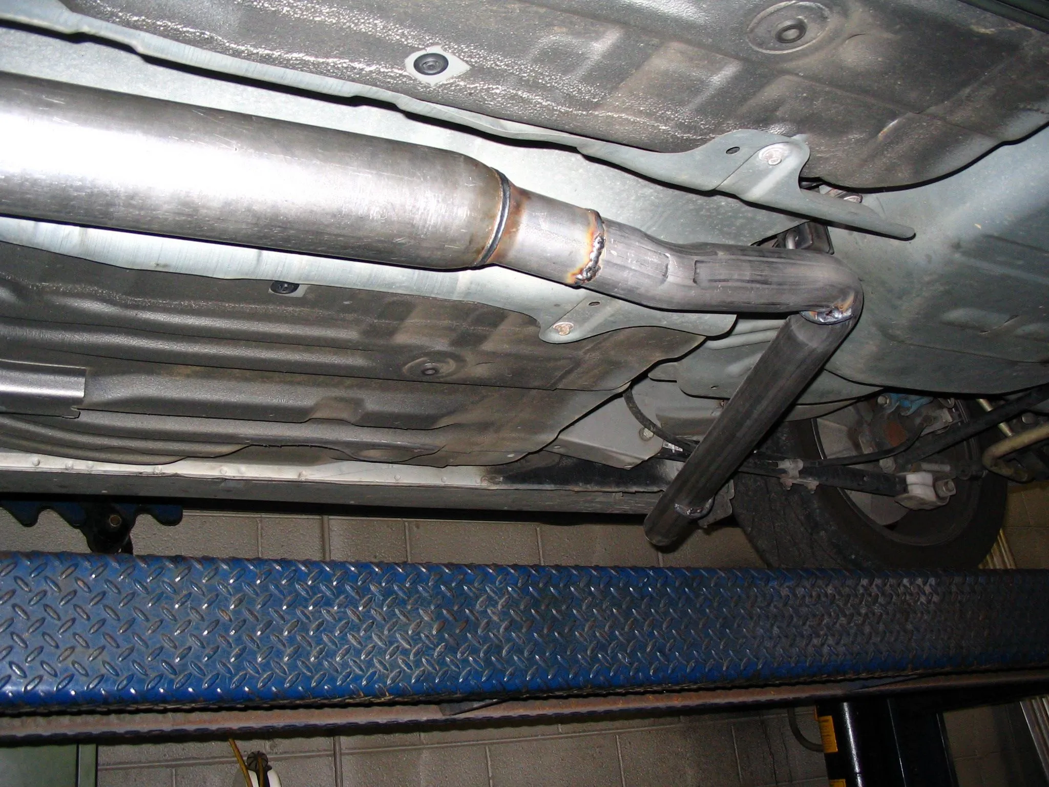

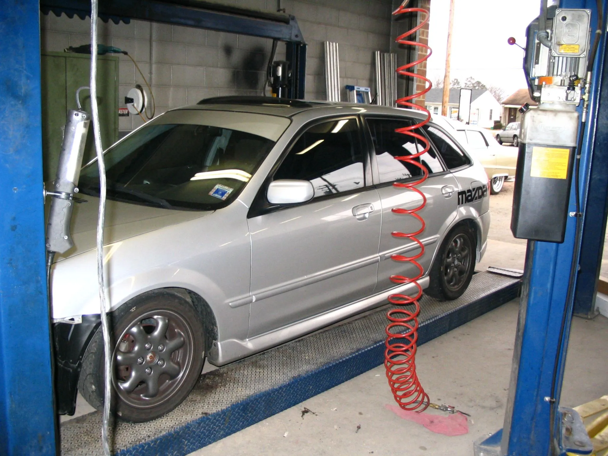

Exhaust Done!
I finally got by the exhaust shop today. Here are the pics. The glasspack used was a little larger than what I wanted (which made it a little more quite than I wanted), but it will serve the purpose until I get some of the more expensive items taken care of. The car sounds very smooth until it gets into the high rpms where it gets just a touch of raspyness. Overall I'm pleased with it and can now concentrate on getting a new mid-pipe.
