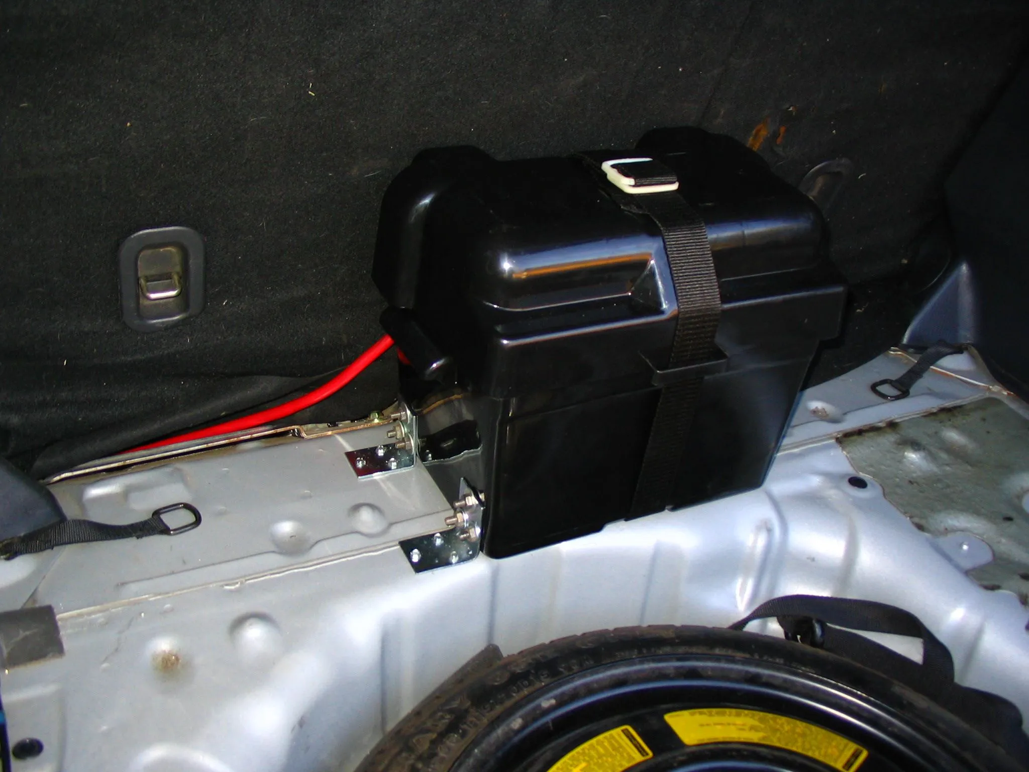

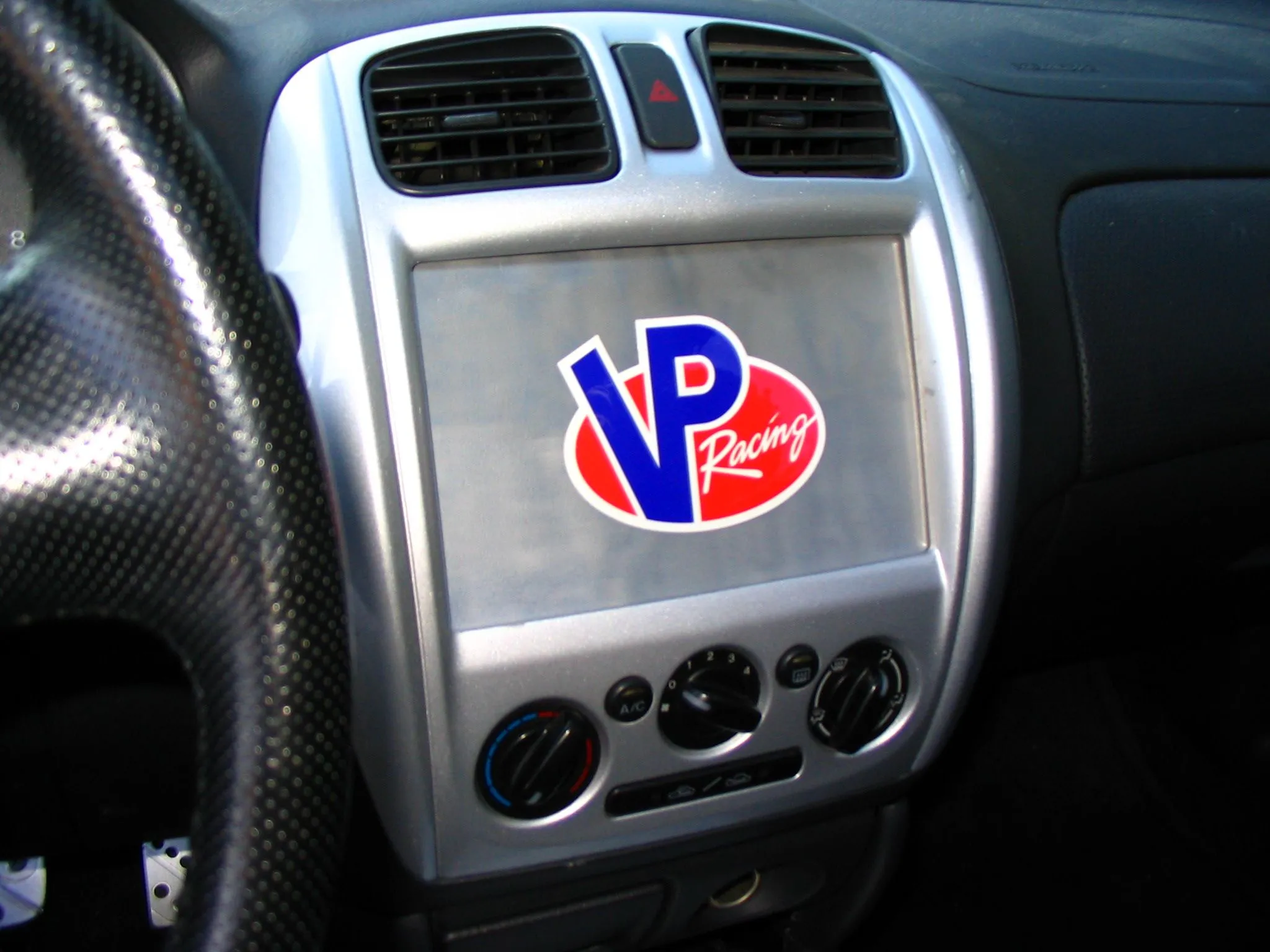

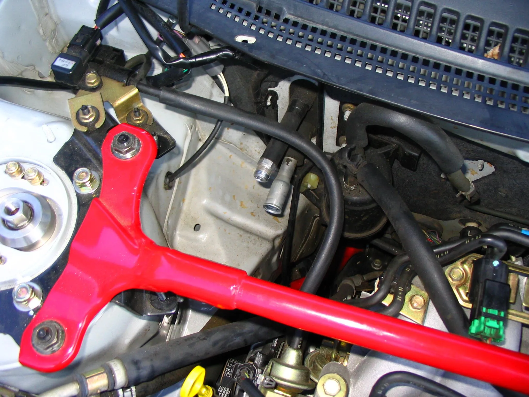

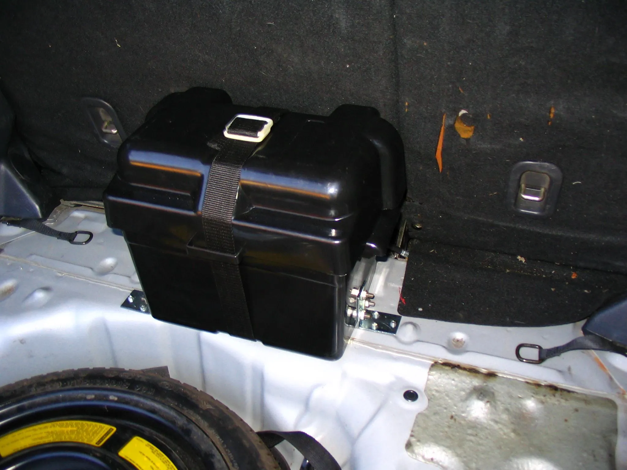

A little more progress today
I finished up the battery box mounting yesterday. Today I removed the cruise control and made a new plate for the where the radio used to be. In the third pic you can see where the A/c went into the firewall. The sticker on the radio plate is temporary until I figure out what switches I'll need there.
