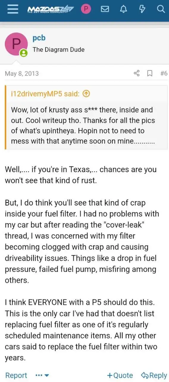

You should consider replacing the fuel filter while you're in there.
A clogged fuel filter can cause fuel pressure issues and strain the fuel pump.

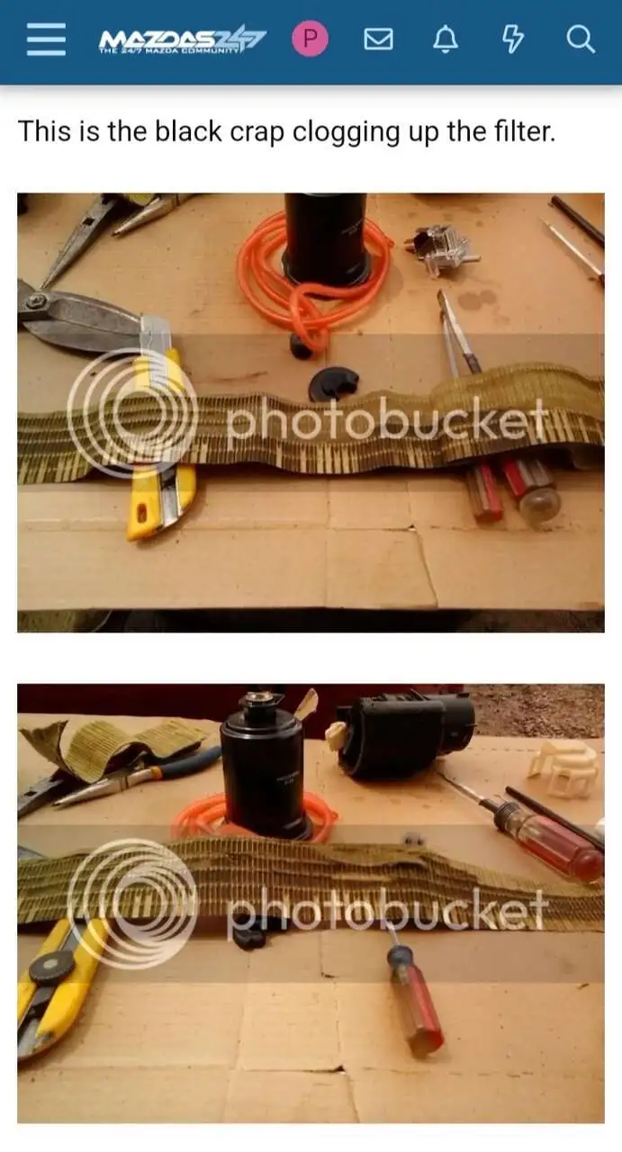

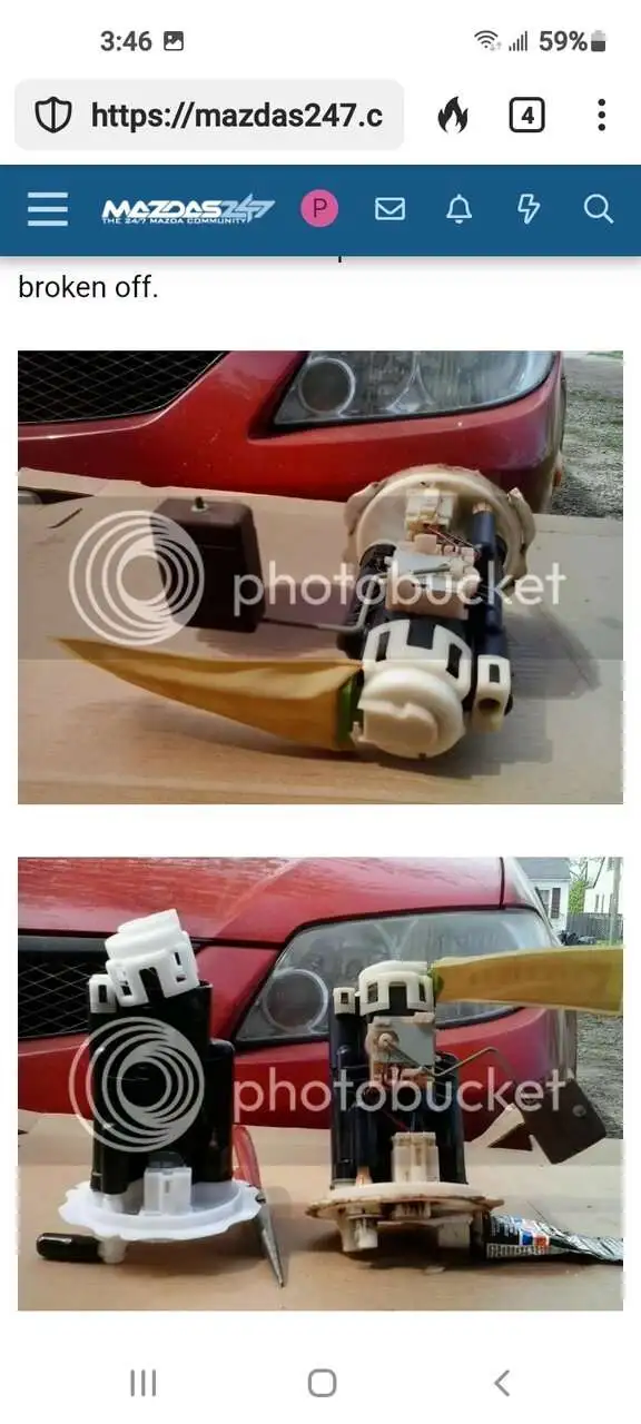

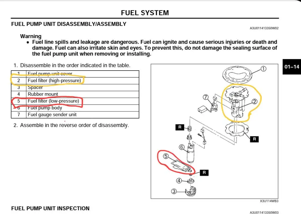

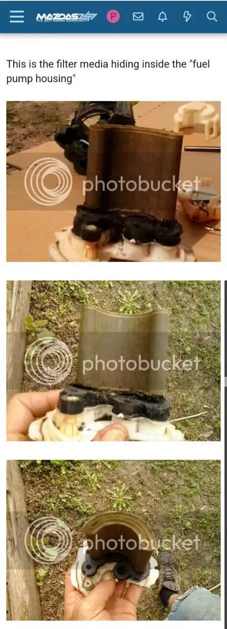

So I had a question about this. My car ran great for 3 or 4 days. Then went back to it's idle issues. So I do believe the filter is clogged and is straining the pump itself. I was curious to ask about the housing. So I understand after disassembling the fuel pump that the strainer is the filter, is there also a filter with the housing itself? Or is it just the filter screen itself as the only filter? Also as another note, seeing if it is just the screen as the only filter between the gas tank and engine. I may install a K&N Fuel Filter on the fuel line before the rail.

So after driving my car around for almost 2 weeks with the new fuel pump housing and fuel pump. My filter was definitely clogged and absolutely killed my last pump but over time I realized that this is simply what was causing my consistent low idle but not my drop in random idle. With the new "fuel system" (ofc not the whole thing) components replaced I have had a consistent idle of around 750 to 800 which is better than my usual before hand. I still have had a drop in idle and can probably pin point it rn... maybe.
