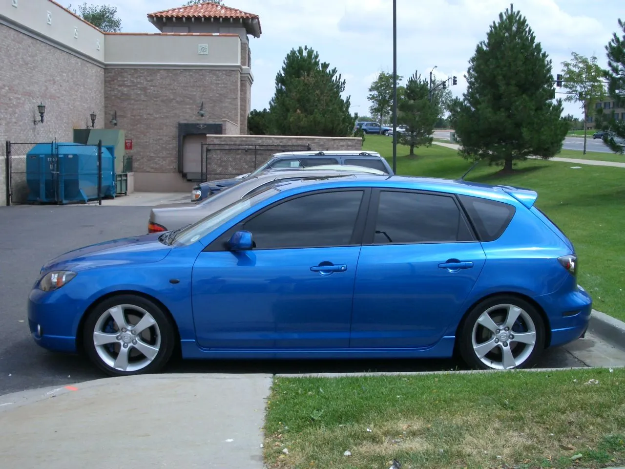

Sprint springs installed this morning!!
They are very good springs, i've had mine for about a month and it handles like a champ now.........check out my car.........

do you change your camber kits also?? how much of a drop did you get???
answer soon please because I really want these ones. Tell me also the pros and cons of this spings
thanks
there is not a camber kit out yet, but you will need it mainly on the rear.....otherwise they are really great...Sprint said they will be coming out with a kit soon.......so they say......get them they're worth the money!!!! :)

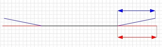

As far as alignment goes..
I have a very crude, but hopefully effective diagram that could help explain why an alignment IS necessary after changing ride height.
In this very crude diagram, imagine that the black line represents the steering rack, and the blue lines represent the tie rods at original height, and the red lines represent the tie rods at the new lowered height.
In this example, after lowering the car, the effective length of the tie rods would have increased, causing a "toe in" condition if not corrected.
Depending on the angle of the tie rods at original height VS. Angle of tie rods after lowering, the toe would most definitely be affected.
(I have seen some rare cases where the angle before matched the angle afterwards. Originally angled down a few degrees, after lowering, angled up the same few degrees leaving the car with a perfect alignment (toe only).
Hope you can make sense of my diagram....
