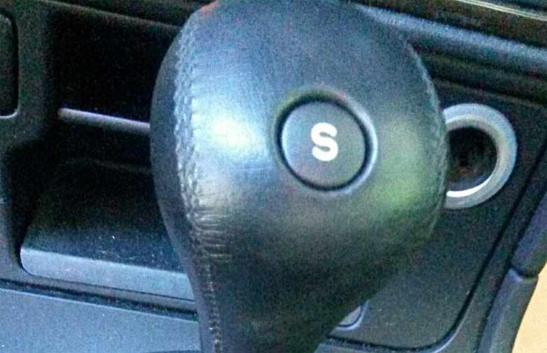

It was on the shifter on my Saabs. Pretty damn convenient.

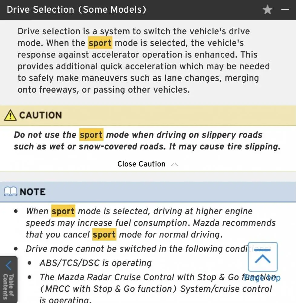

Is that listed in the manual or something? I've been trying to find this information but I wouldnt say actively.
Partly, but it isn’t as clear as explained above.

The 2020 manual says little about Sport Mode. The most salient bit is:
 When the sport mode is selected, driving at higher engine speeds increases and it may
increase fuel consumption. Mazda recommends that you cancel the sport mode on normal
driving.
 Drive mode cannot be switched in the following conditions:
 ABS/TCS/DSC is operating
 The Mazda Radar Cruise Control with Stop & Go function (MRCC with Stop & Go
function) System/Mazda Radar Cruise Control (MRCC) system/cruise control is
operating.
 Steering wheel is being operated abruptly
That's about it. It's pretty obvious just driving in Sport that it holds the gear to higher RPMs before upshifting than in Normal mode. As previously mentioned, in less than aggressive driving Normal mode runs through the gears at around 2500 RPM, give or take. In Sport it runs up to 3000 RPM, maybe a little higher.
