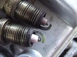

Hey....
This are my Actual Plugs when me engine blew!
Check the left one...looks green, very green!!! = DETONATION
yeah... that's definitely green! LOL... wow... nifty. I'll try to at least get pics of my plugs tonight!
Later.
Steve

I think he means what physically causes the green color... aka metallic oxide deposits or what. (or at least that's what I want to know! :) )
