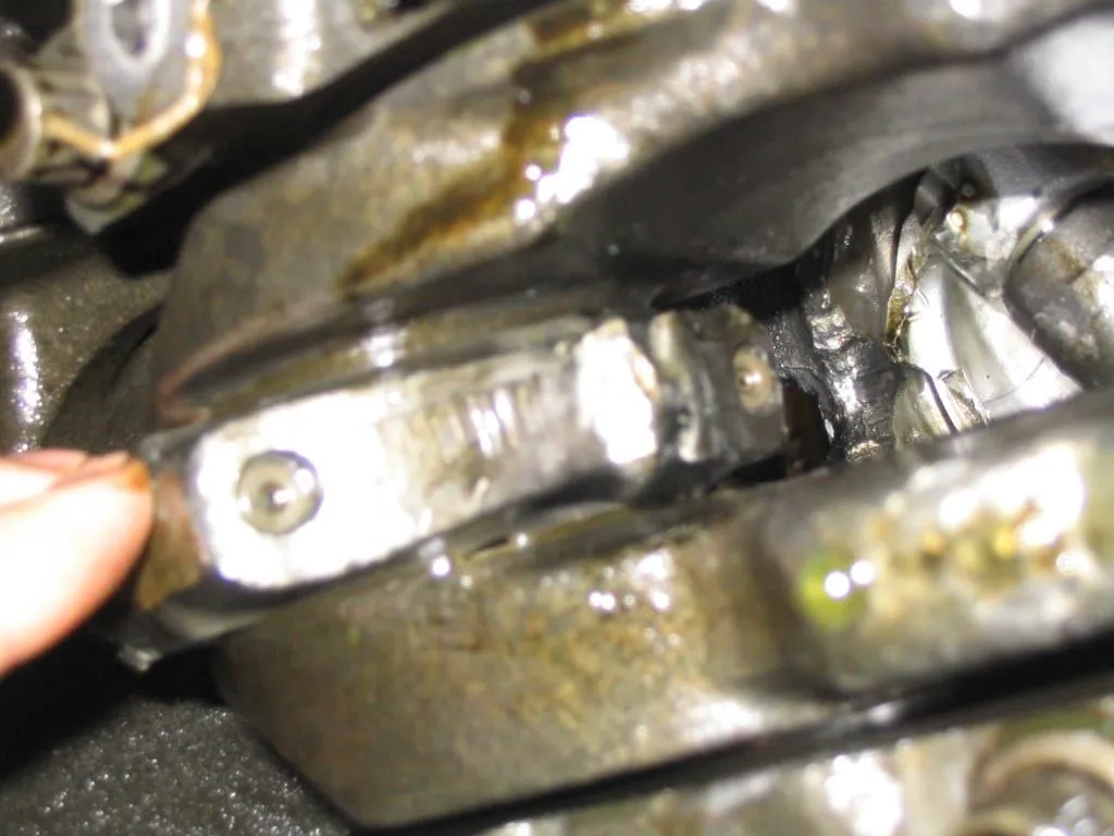

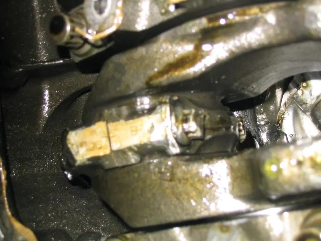

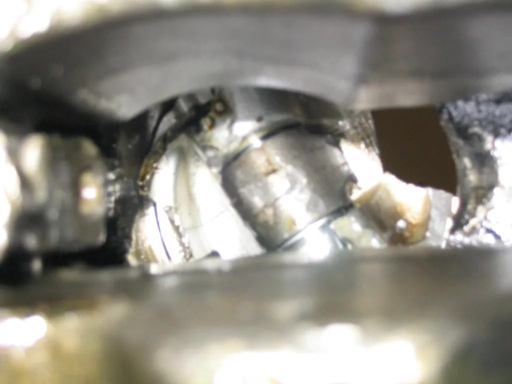

pics of the bottom end/rod bolts...

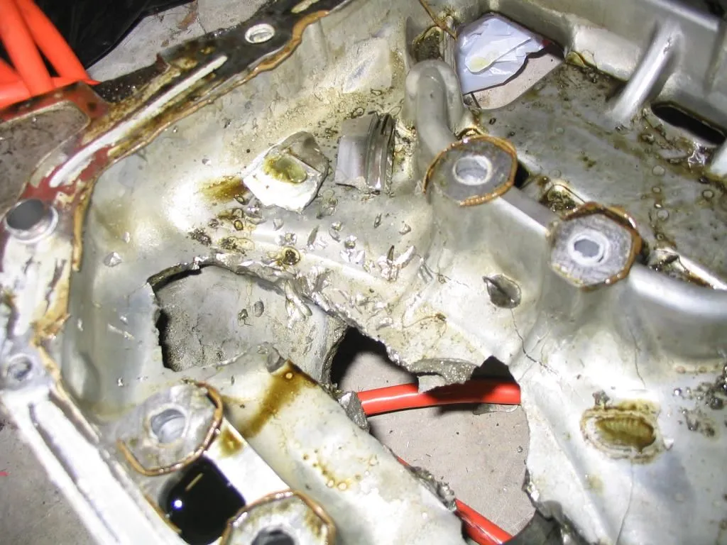

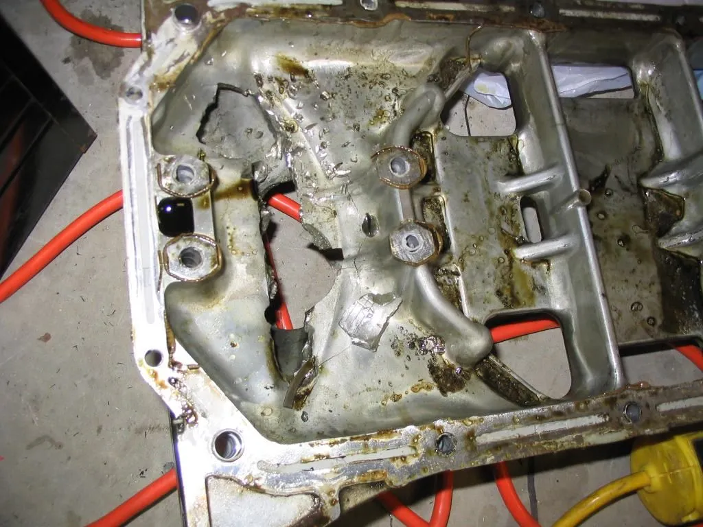

the considerable damage to the upper oil pan...
igdrasil said:
THIS IS THE SAME THAT HAPPENED TO MY ENGINE. Piston 1 and 4 bent and twisted the rods up to the limit that the piston reached the crank shaft and got pulled out of the pin (broken under it) and left the piston in the chamber while the rod is playing around doing some decorative holes in the block.(pissed)
Hey, and about the head gasket, maybe its not aligned in the block because the alignment pins are stuck on the head and not on the block. Look for it.
the pin is still in the piston though.. and the piston isn't twisted all that much off center... but yeah I follow you for sure!!
I'll have to look for those alignment pins.... never saw any sign of any of them.. the gasket was just floating around when I pulled the head off..
Upper oil pan = Main Bearing Support Plate (MBSP). Your s*** got eaten up! (eek2)
Why does this bring back deja vu?
Yeah you should see the piston itself and see the size of the hole in the block... it's at least as big as the upper oil pan mess (btw.. anytime you try to buy the part they call it an upper oil pan, but yep it does screw directly into several of the main bearing caps)

dude...
I really have no way to describe this ...
Your motor got freakin destroyed..
The thing that really struck me was the upper oil pan, I thought it was very insane the amount of dings in it...it seriously look like you had a snap, and then that space acting as a freakin jiffy pop of metal chunks...unbelieveable..and to this we still have NO idea what caused this...
Mad props on throwing all that money and effort into the engine..I love the fact that your going to make a big thread about it...
Can we say Bryan Pendleton of protegemp3.com?
Yeah it took a HELL of a beating... I'm quite sure the rod snapped... the rod had to be moving to hit the piston with enough force to shatter the skirt and so forth. I think it snapped up by the wrist pin, and then swept through the block and the upper pan and then finally came off after it beat the living daylights out of everything else!
