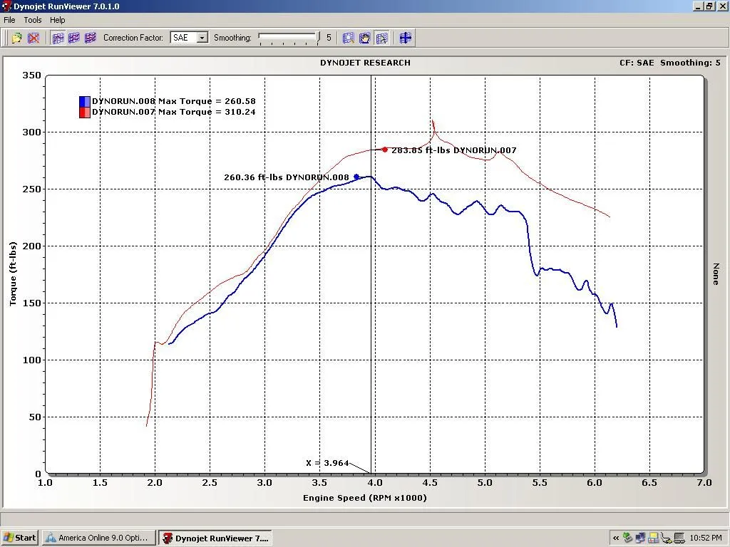

Kooldino said:
My mistake, 260 something. This pull was in 4th gear. 4th gear pulls tend to show more torque on the dyno we were on.
I hadn't gotten a chance to tune the car since the install of the intake cam, but for an hour before the dyno.
Still I do not see where the camshaft is helping. Here is a 15psi pull from Deans with the mostly stock MSP exhaust system. We did make a downpipe and removed the front cat. @4,000 rpms Dean was up 20 lbs ft at the same 15psi.
Thanks again
Later........Nick
Thanks again
Later........Nick
I see that you still have that crazy drop at around 5.5K. Is that the MAF issue there... aka before you guys switched Dean's to a bigger MAF or is it something else? I see it isn't in the other curve... so I'm wondering what the change was.
No thats the way the torque curve builds and then falls off. It may be a little faster then it should be, maybe. The wastegate was not holding good at 15psi. With the new wastegate we will see how it looks when we go back to the dyno.
Thanks again
Later..............Nick
I was referring to the lower of the two curves, the upper one looks good... is the lower one Dana's? As it is rather similar... just confused as to what i'm seeing there.
