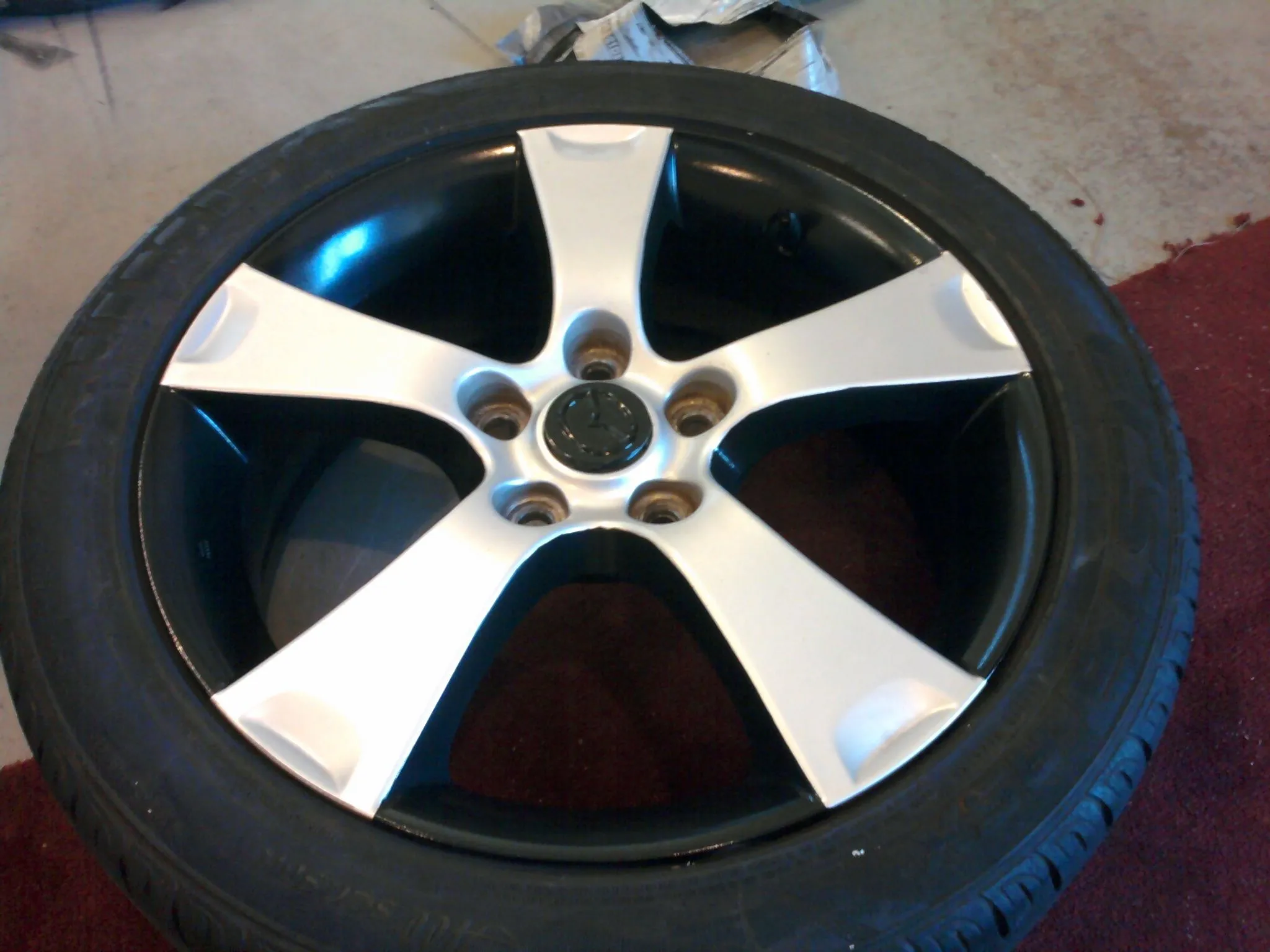

I don't know...just not really feeling the rims...car is hot, but I think that paint scheme is not...I don't think it adds to the car...

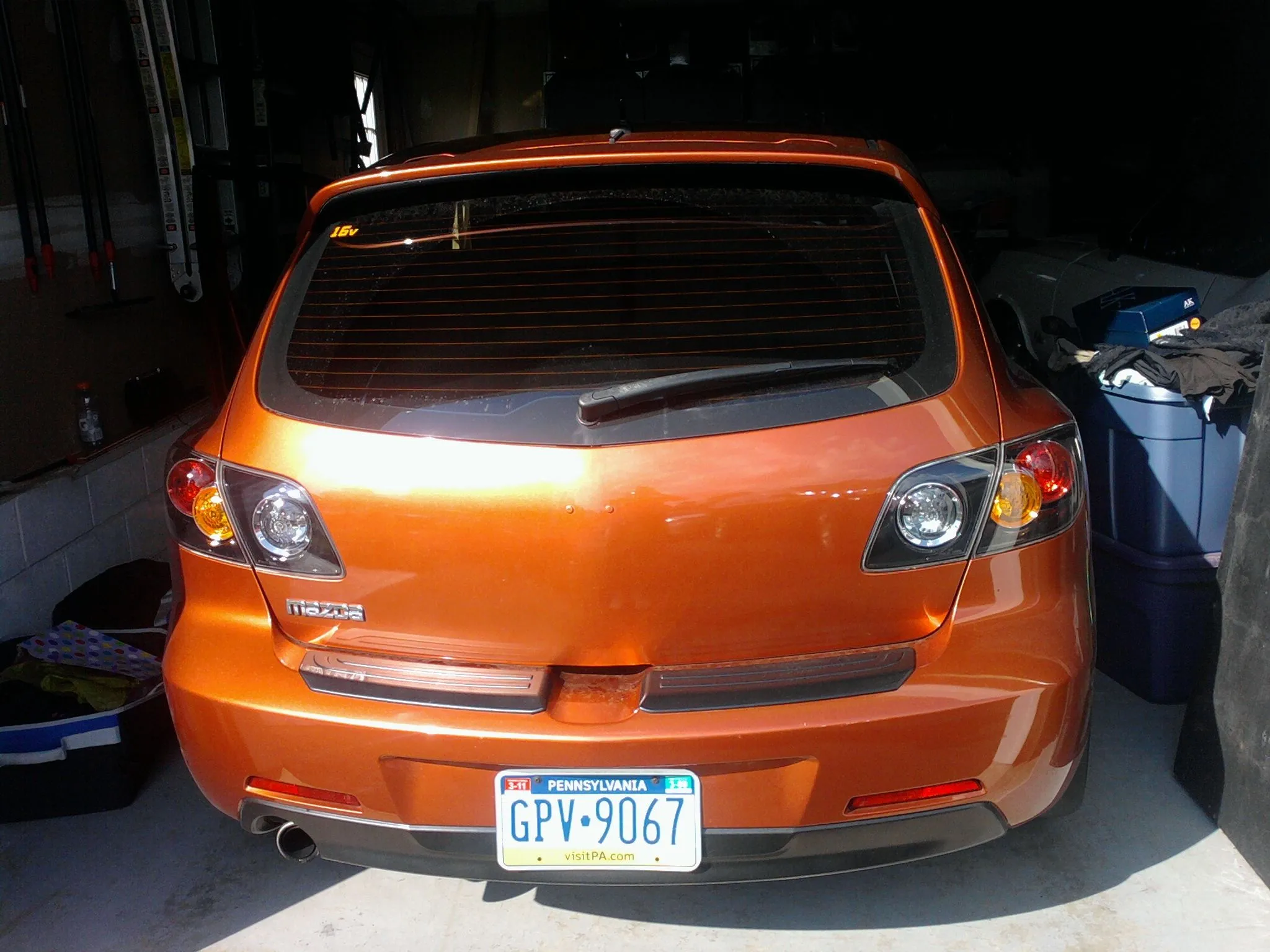

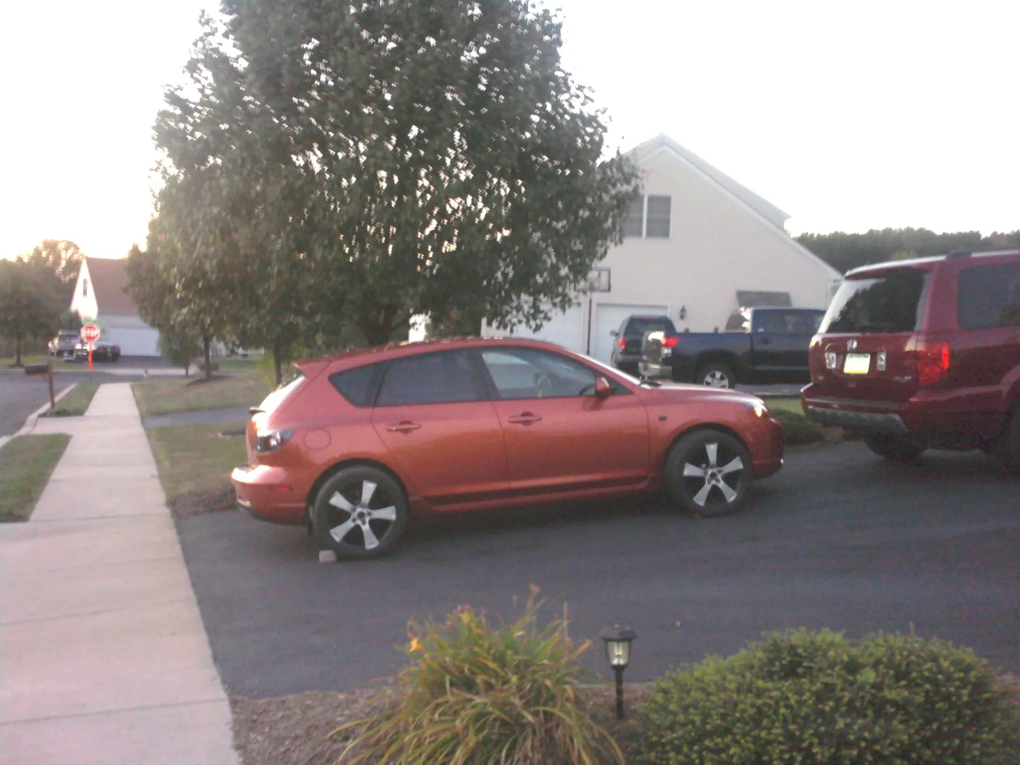

I am running H&R coilovers. I paid just over a grand for them shipped from street unit. Install was a breeze but I have done this kind of thing before. I absolutely LOVE how they ride and the drop they gave me. They are not harsh at all for being all the way down. I'll work on squeezing every bit of lowness out of them in the spring. I think I can get a few quarters of an inch lower.
H&R does not have helpers. I am running both the perch and the locking collar in front and I have the spring perch/adjustment collar removed in the rear.
I got my eyelids from partplaza on ebay and the supertones from ebay also. I couldn't find them anywhere else for cheaper.

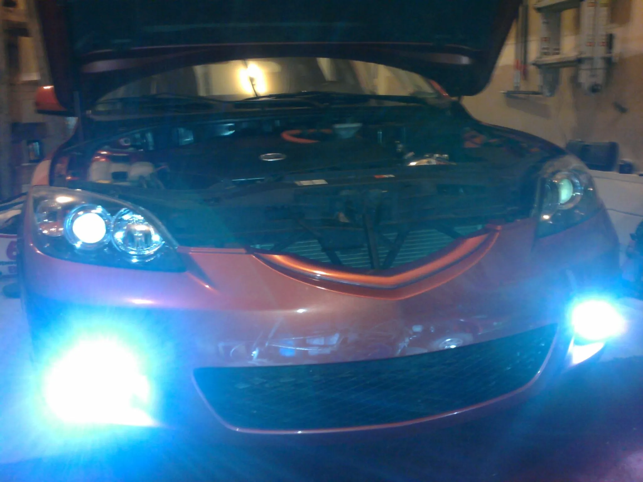

when you connect the horns up do you just make the wire longer that the stock horn was wired to or what, like how easy is it to install
I pre-wired the horns but left extra length. Then I removed the front end of the car, used self tapping screws into the bumper support to mount them and also double as a grounding point, wired them together and cut the wire to the right length, unplugged the stock horn, and plugged in the wire from the new horns with a terminal on the end. It was a pretty easy job but time consuming to get everything how I wanted it to be.
