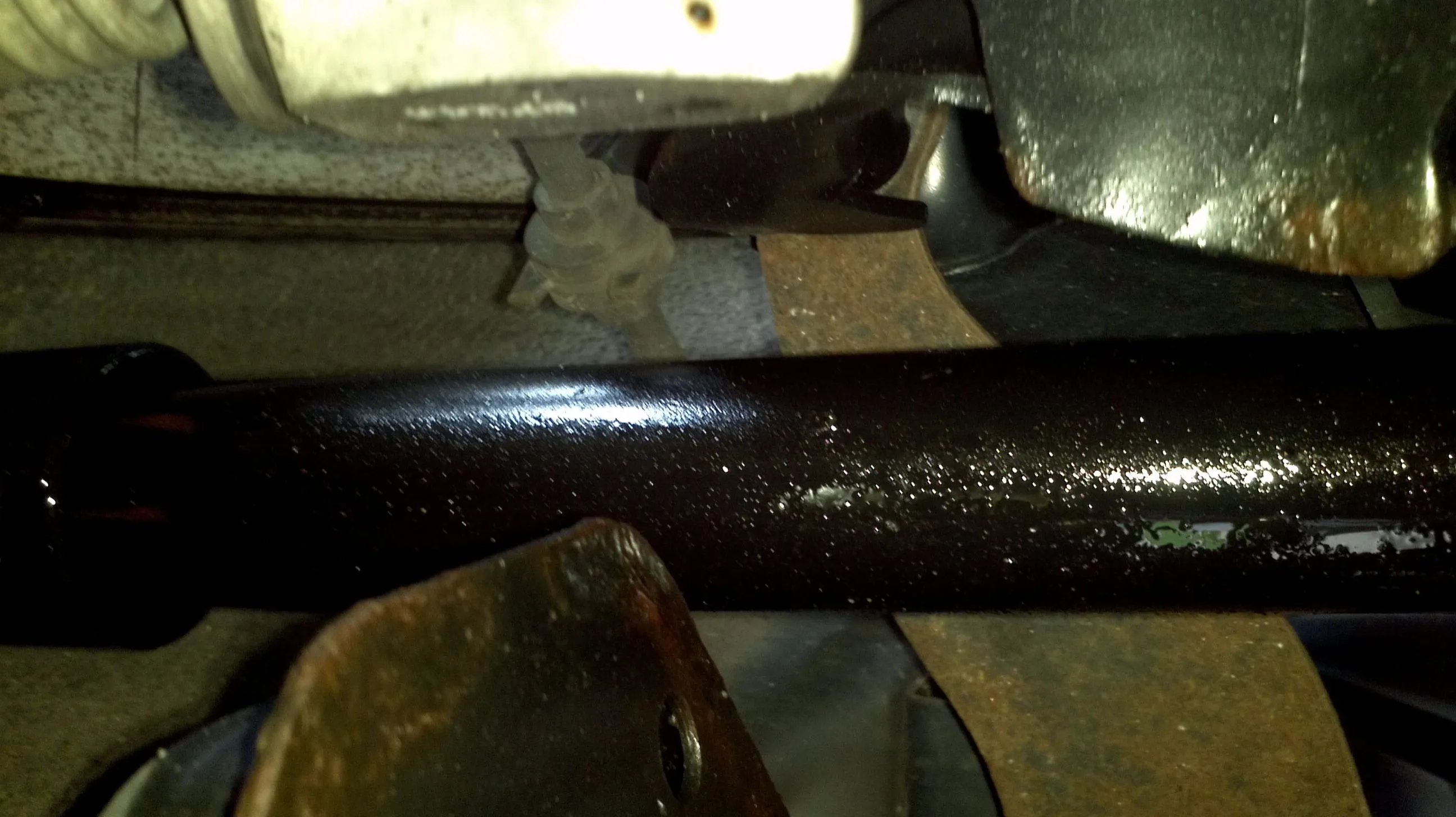

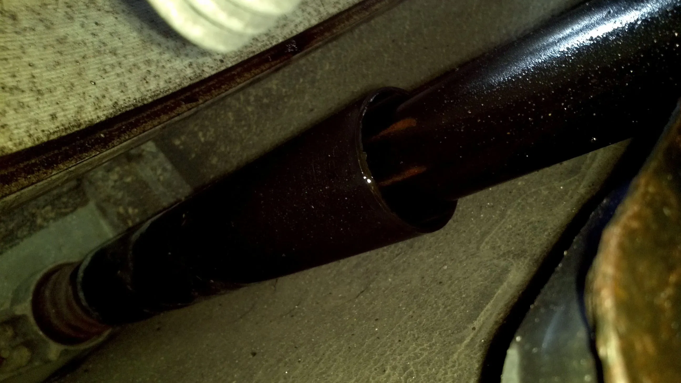

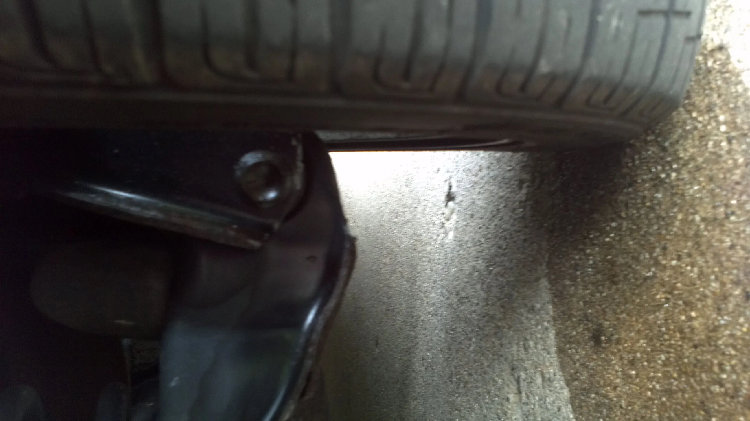

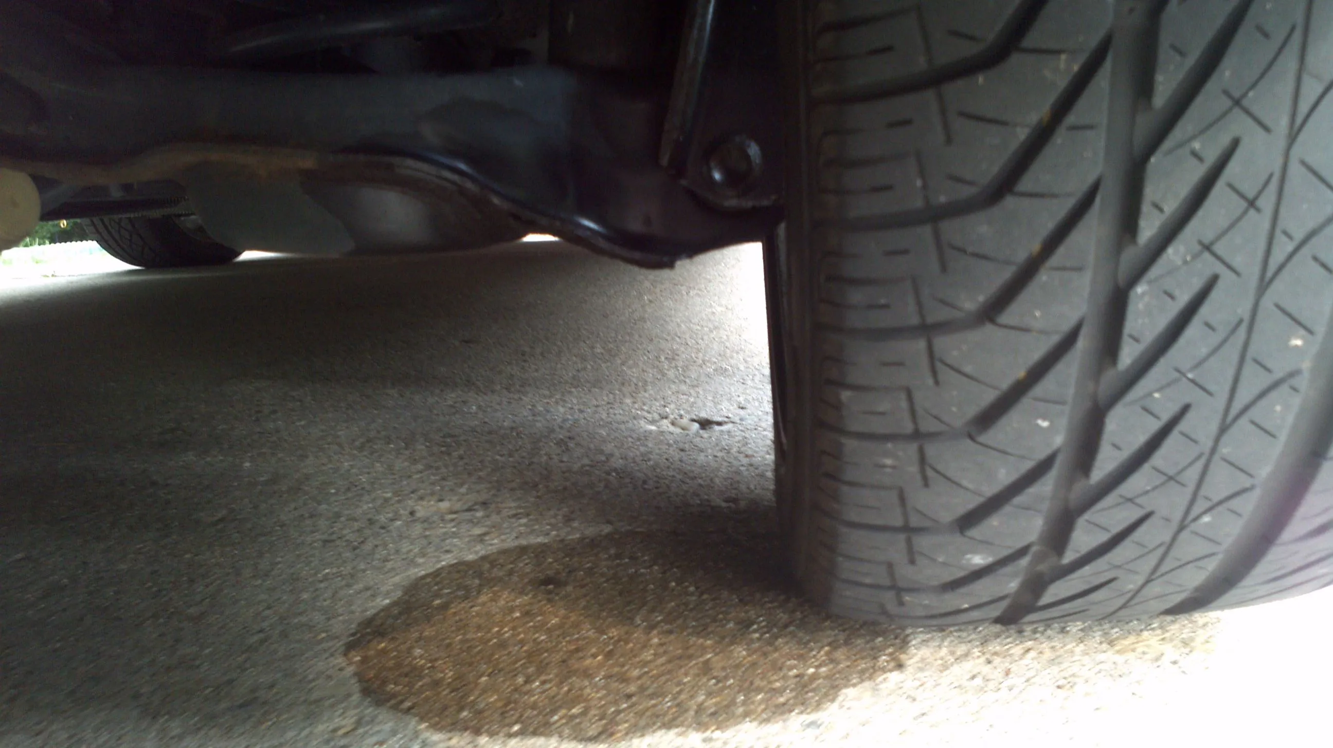

So what do you guys think? Blown?
cvp0917
Mazdaspeed 3
Went out to move my car a little bit ago and found this on my driveway, i poked around and found oil all over the shock. Im assuming it blown? Hopefully its covered under my extended warranty i bought when i got it used.
It just pisses me off how im reading around and the 3's factory ones only last 20-30k miles when the factory shocks on my mazdaspeed protege lasted me 163k (until i hit a deer). Is it so hard to buy a car with quality parts nowadays?
btw, please excuse the crappy cell phone pics, my ex wife managed to end up with my $800 camera...

yup they are toast!! I still have my stockers if you want to buy them, just PM me.
