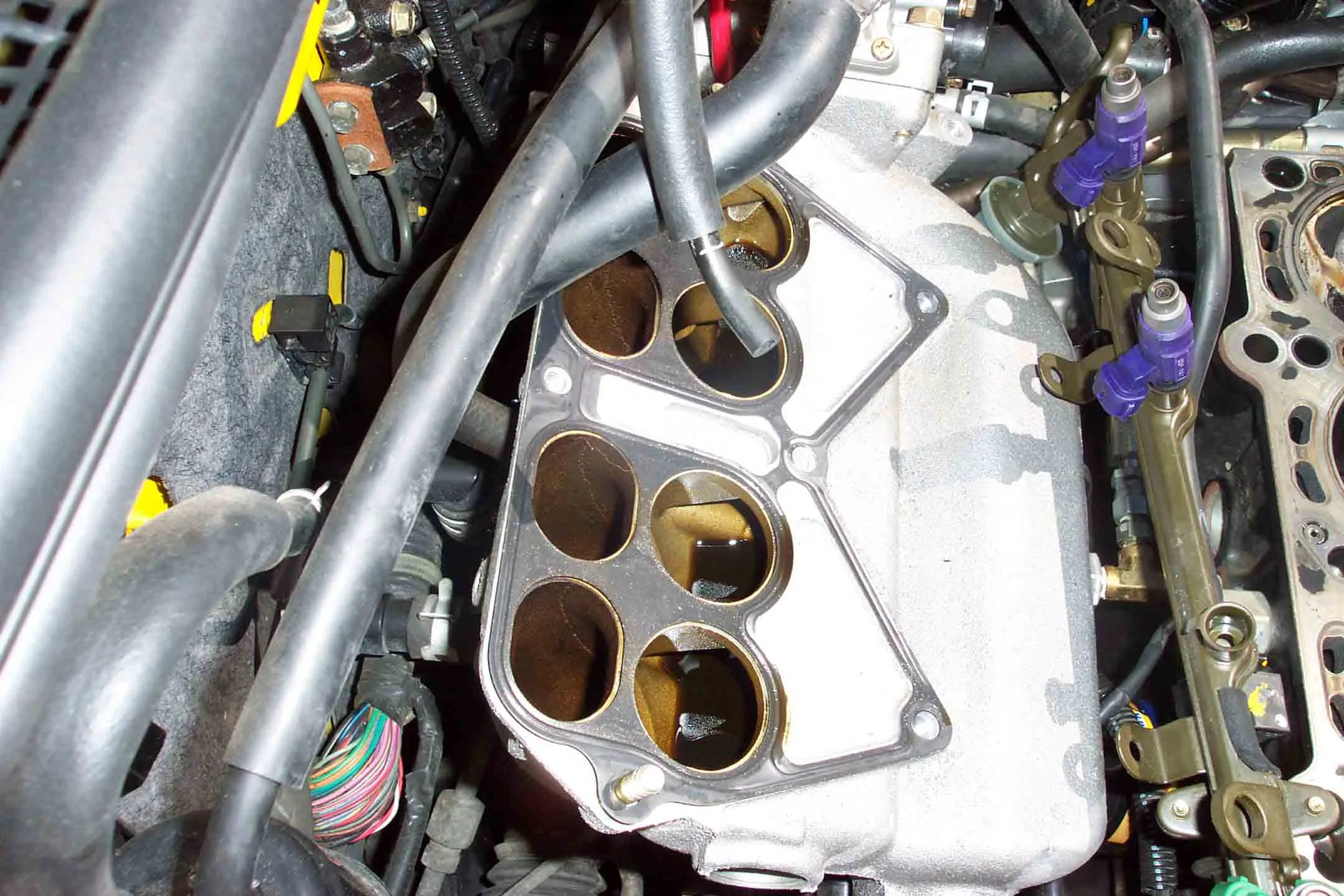

Take a look at the oil in my intake manifold....

kudakev615 said:
(omg) (omg) (omg) (omg)so your saying you always have much oil entering your combustion chamber?
No... I'm saying that the magnetic energy of the North Pole is drawing the oil into the upper regions of our engines that it should otherwise not be found! This is a phenomena only found in regions north of the 49th parallel. The price we pay for living in paradise I guess... (canada)
Okay, back to the original topic! 'pologies for the jack... (evil)
