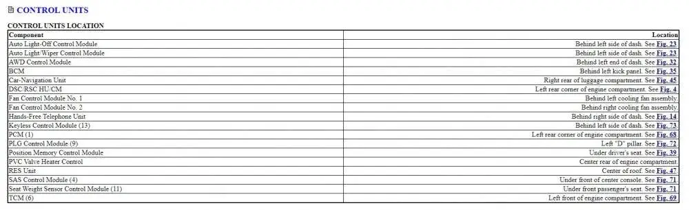

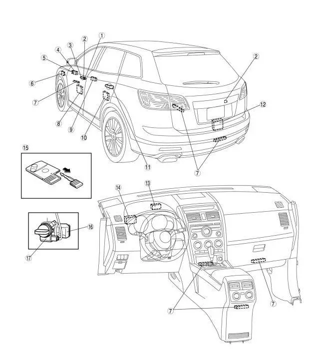

do you think i have a problem with the rear keyless antenna for it? Is there any way to check the antenna? please help.
