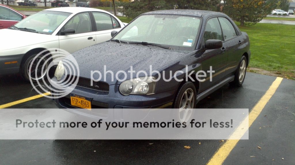

The black looks sooo much better. I like the white but I didn't realize how much better the black would look. Have you tried any lens restoration kits?
Meguiars PlatiX and my personal fav Novus.
They work for the oxidation really well, but the lenses have patches of tiny little etched cracks that this stuff cant get out. Straight on they look clear, but look at an angle and these areas are visible in the sun
Well that stinks. One step at a time I suppose. Keep up the good work. How's school and everything going? I can't remember if you're done or not lol

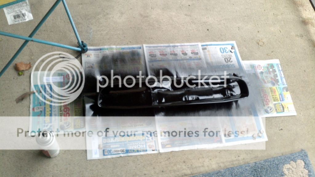

So I debadged the grille yesterday.
Shot it in a nice gloss black
But then my clear coat got confused and thought it was wrinkle paint:
Annoying. Currently waiting for it to dry so I can sand it down and try again

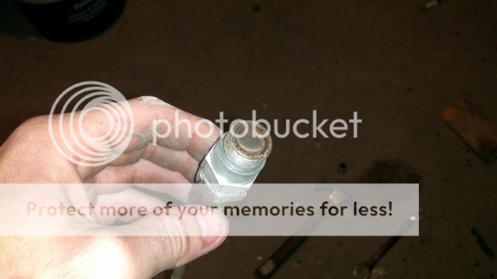

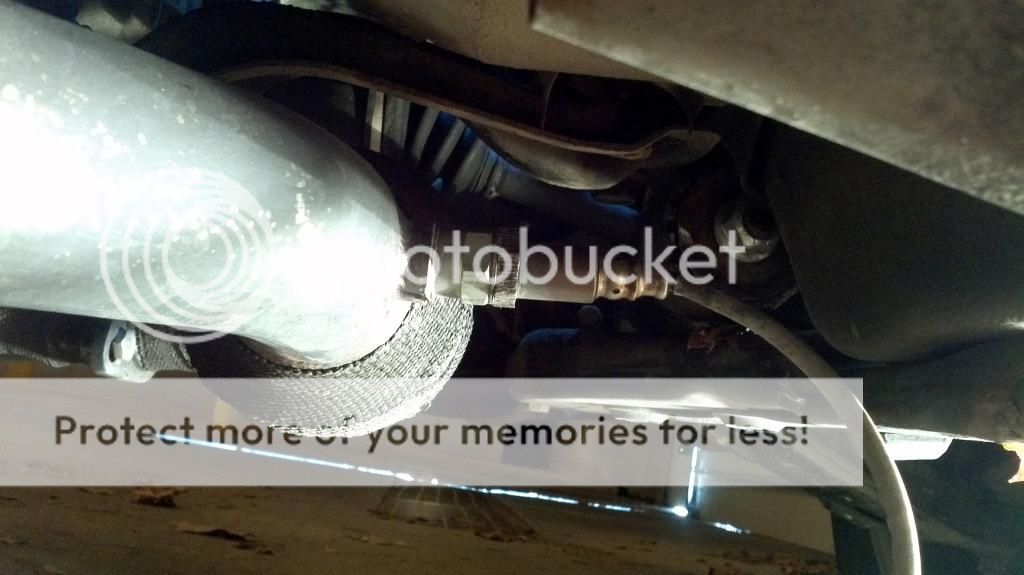

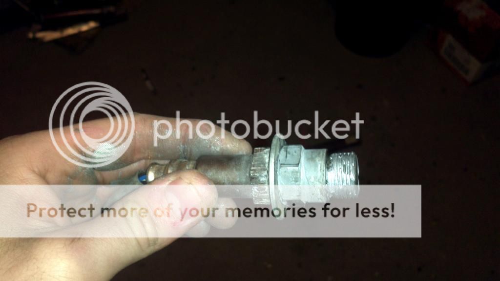

Had the day off so I decided to tackle getting the downstream o2 sensor spacer out of the midpipe.
Had to unbolt the mid-pipe from the header, unbolt the mid-pipe supporting bracket and slip off the third farthest-back exhaust hanger to get enough room to twist the 90* spacer out without it hitting the underside of the car
Then the o2 sensor seemed to have fused itself into the spacer, so I hit it with some penetrating oil
While it set for a few minutes I decided to remove the leftover bracket from removing the AC that supports the alternator cable, a few zip ties cleaned that up
Then I got the sensor out

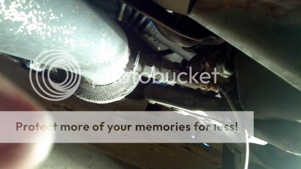

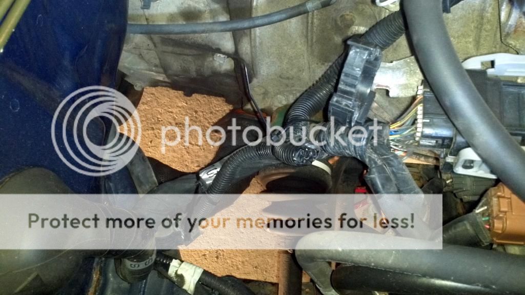

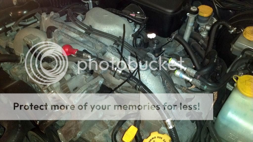

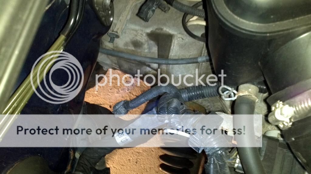

Re-assembled everything and realized that with the sensor coming out of the mid-pipe normally, there isnt enough length to plug the sensor back in, so up top I had to get some more room from the harness.
This is how it looks stock
and how I had to tweak it
Then I ventured out into the "hurricane" and drove about 30 miles, no CEL so far. Hope that solves it

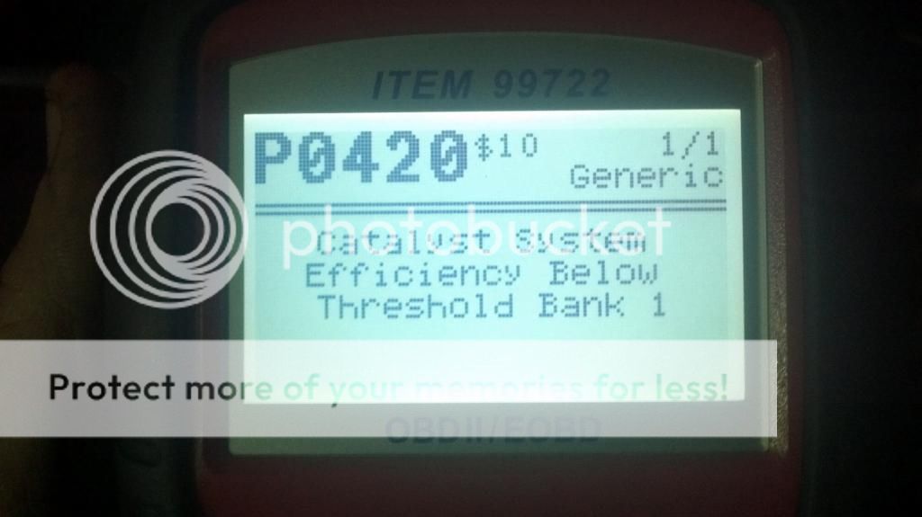

Check engine light came back on
To This:

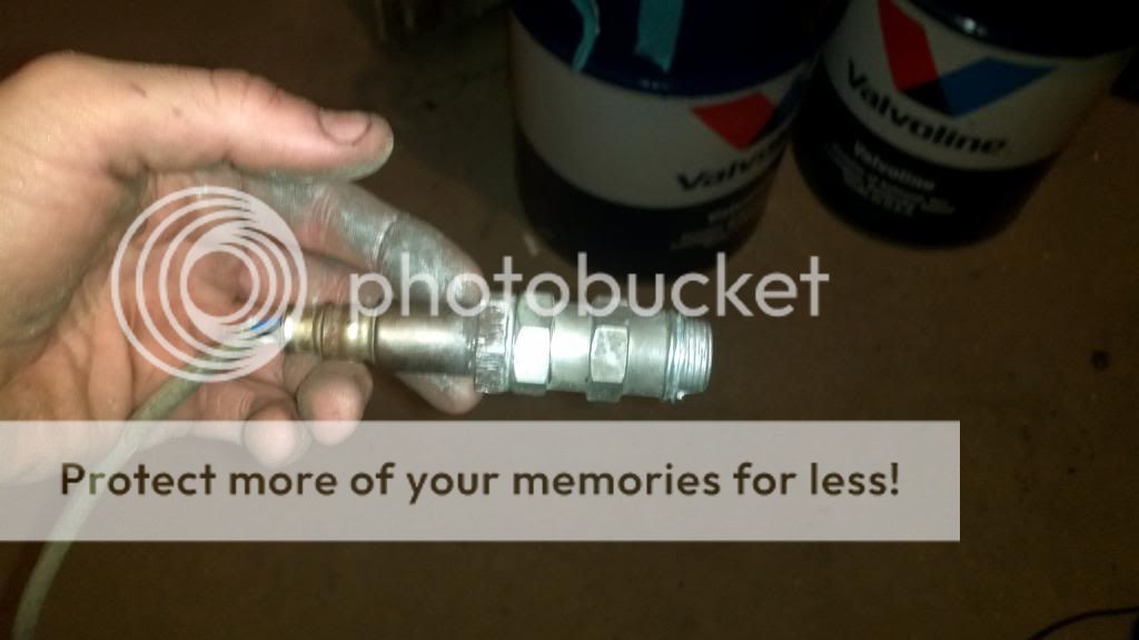

So im thinking the o2 sensor still needs to be spaced. So I used an old one from my old car I had laying around.
Lets see if that does the trick

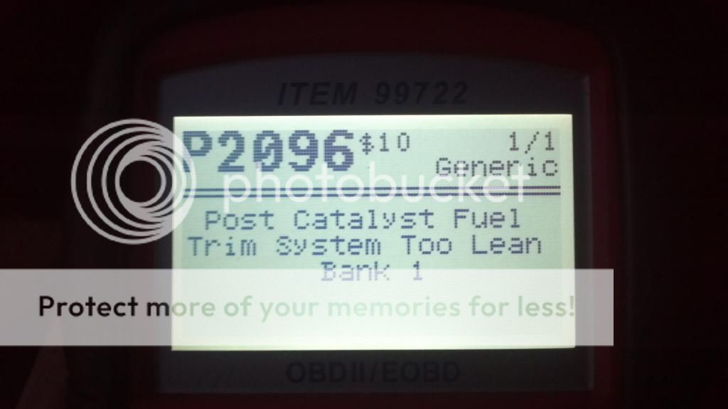

Was so sure the check engine light was gone this time ...
... but then at 1:30 last night innocently driving through BVille being "escorted" by two police cars that apparently had nothing better to do ... booop ... it came back on.
Gonna read the code tomorrow at work, wondering if getting an extended sensor and using the bung farthest back on the midpipe may do the trick ...
Back to this lol
Gonna have to tweak my spacer tomorrow.

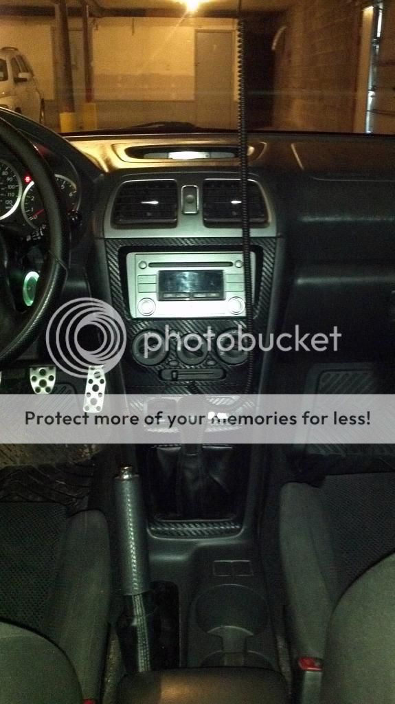

Then decided to use up the last scrap of CF wrap Ive had laying around to wrap the center dash piece
As you can see the odd angles of the radio opening meant I couldnt get the wrap into those bends without popping back up so I had to cut it back a bit. For now Ill leave it like that. Whenever I get around to getting a decent head unit Ill wrap it again but throw down a coat of flat black underneath so it isnt so obvious.

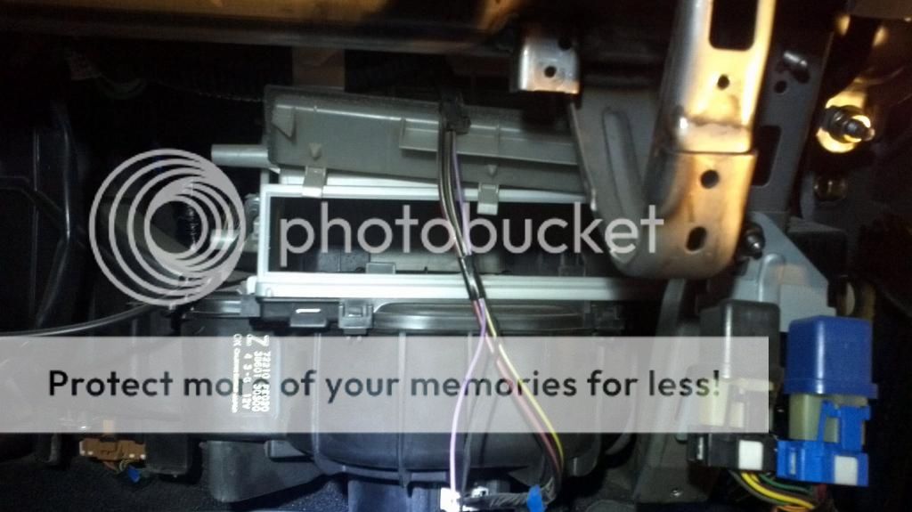

After hearing that our cars do in fact have cabins, and watching a how-to video I decided to see what mine looked like:
Haha maybe Ill throw one in there at some point :p
Also tweaked my spacer with a spacer, doubt this will do the trick its barely changing it at all. I have one more trick up my sleeve then I might buy an extension and try the sensor bung farther back on the midpipe
