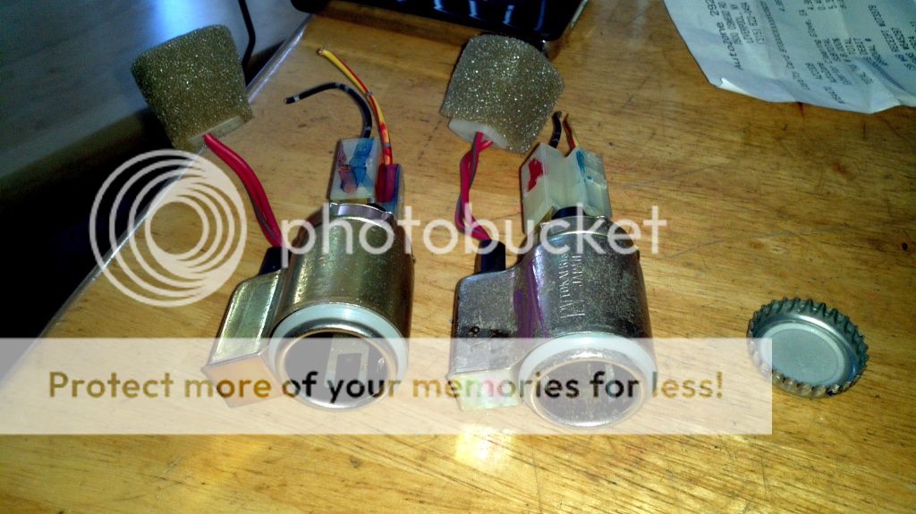

And decided to re-work my aux outlet mod. Picked up these from the junkyard this morning ... two subarus live on!!
Ordering something new to go along with these too :)

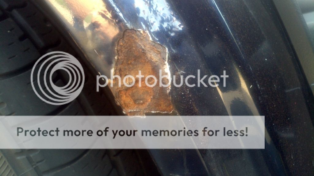

Decided to commence operation "**** You Rust" tonight. Just did a little to get it started. Began with the worst spot.
Thats a large pit!!
Hopefully I can save the metal and it doesnt come through from the back side, I can feel some bubbling back there.
Going to need a grinding wheel attachment for my cordless drill, this was all the wire cup brush could handle, that or a good ol fashioned metal hand file

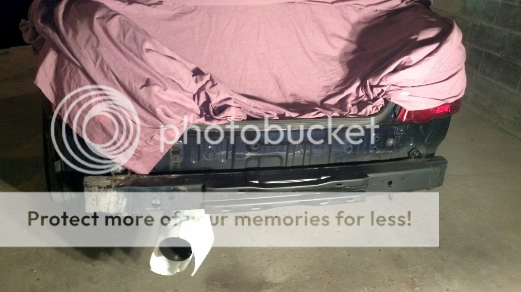

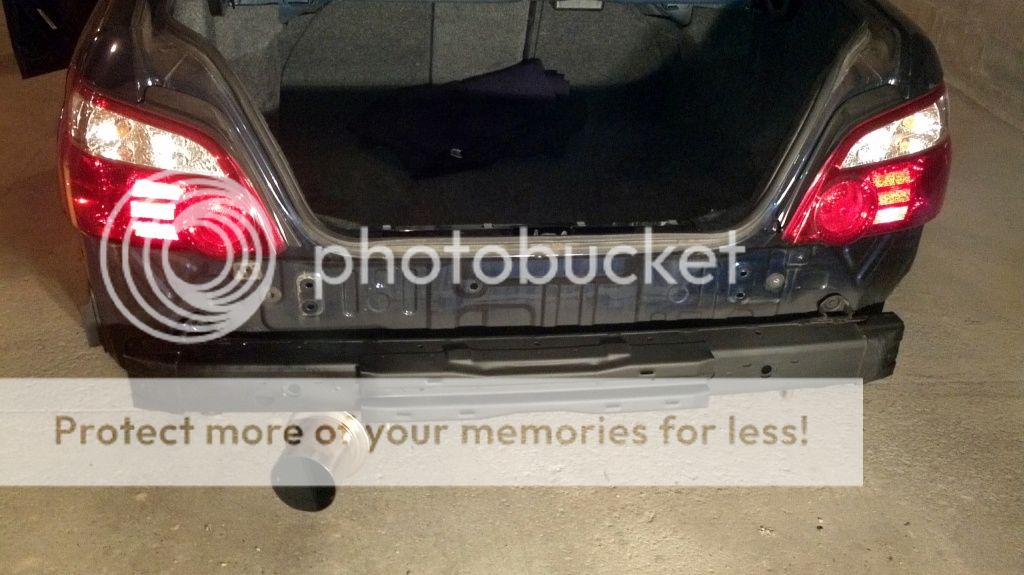

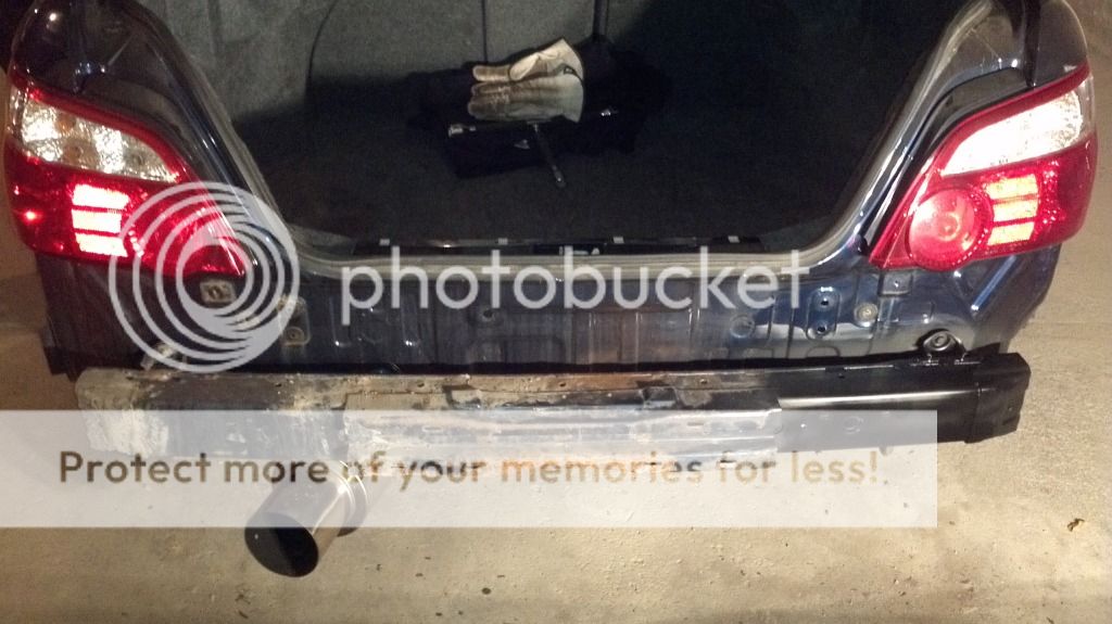

And we continue with operation **** You Rust. Since the rear arches have some rust all the way back to where the plastic of the bumper meets, I took off the bumper and guess what ... I found more rust. Go figure:P
So I took everything apart and started with the bumper brace or whatever you call it, the actual bumper lol. Wire cup brush till my drill was out of juice then covered what I got done with rust reformer.
These parts are going to be tedious
Oh and who new there was metal built into the bumper :p

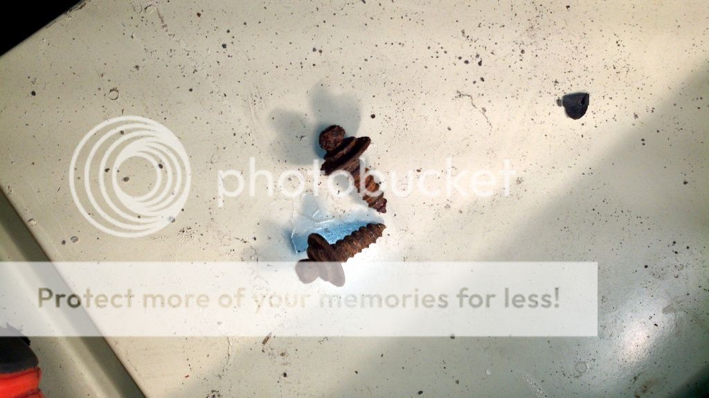

Anyone got a part number for these? They are located under the taillights and hold part of the bumper on
Lastly WTF is this, it fell out when I took the bumper off
i am not trying to be pestimistic, but not matter what you do , that rust spot is going to comeback right after this winter. trust me i have done it lol. may not not be visible since its dark color.
I havnt finished with the spot in the arch yet.
All the rust uis being taken down to clean metal. Covered with rust reformer for good measure and then anything that isnt an exterior body panel will be coated in rubberized undercoating. I know its not a cure-all but it should tack on some extra years to its life.
As long as you remove all the oxidized metal down to nice clean sheet metal, then paint or coat it, the rust should be gone.

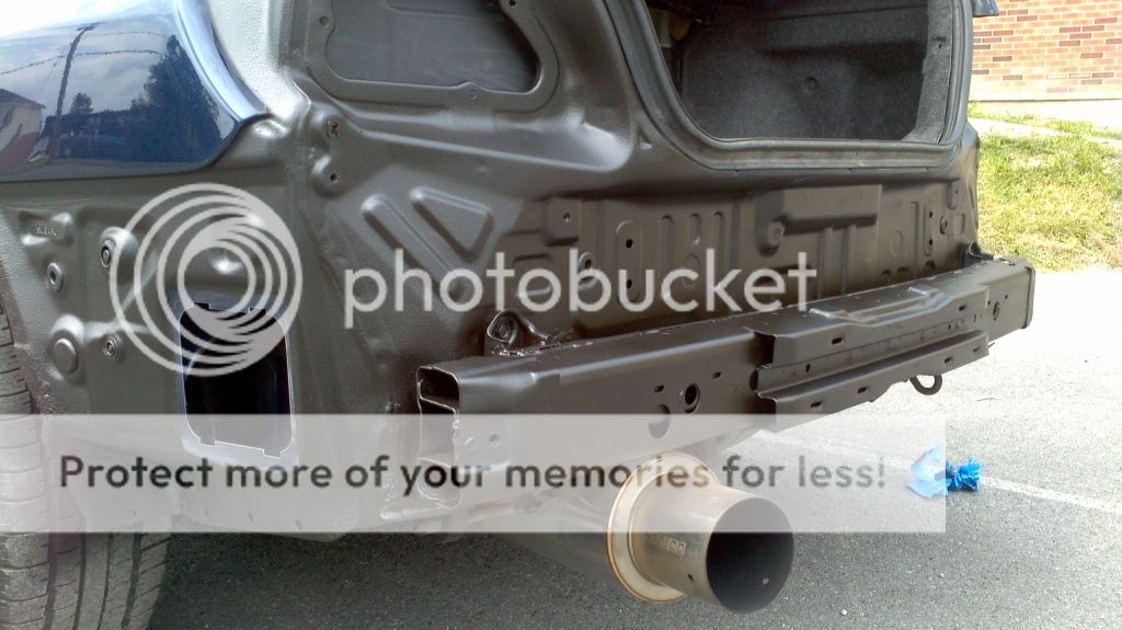

With the next two days off, I just decided to finish up the bumper beam tonight

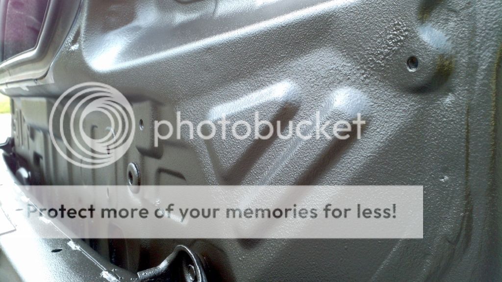

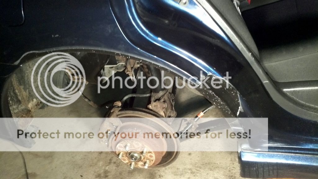

My game plan for tomorrow is to bring her to the car wash and clean the mud out from under the rear and the rear wheel arches. Then bring her back, lift up the rear, take off the rear wheels and go to town on the arches spending the most time there to ensure as best I can that the rust wont return. Also taking a wire cup brush to any surface rust under the rear, then spraying liberal amounts of undercoating where need be.
Got to work this morning-> Lunch/Gym break right now

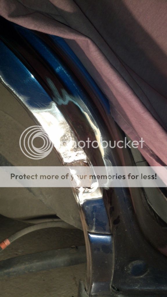

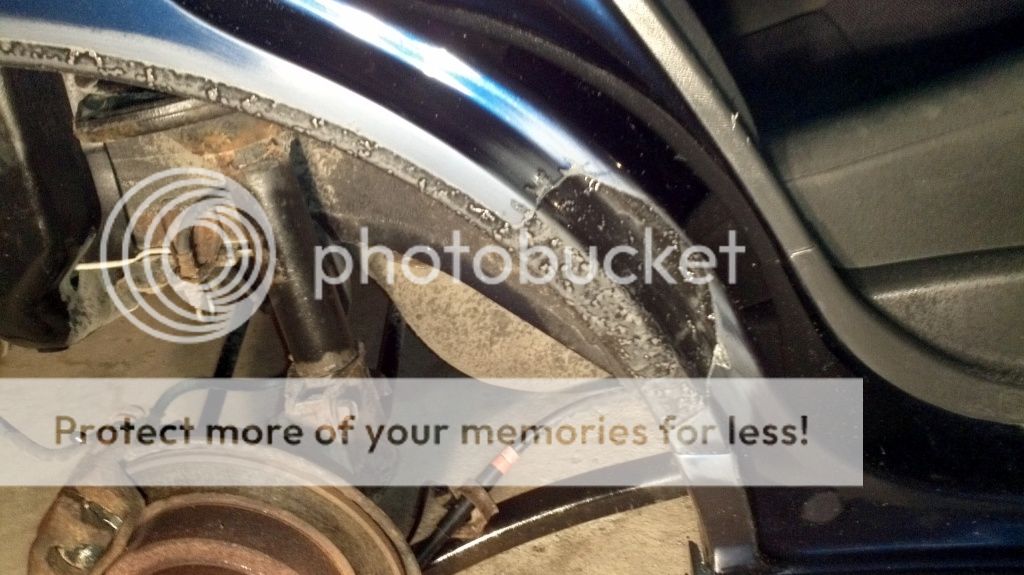

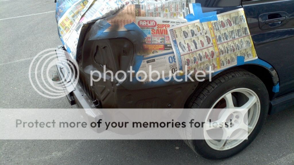

Started on the arches, heart sank when this happened, not sure what to do now
Then go the rear side undercoated:

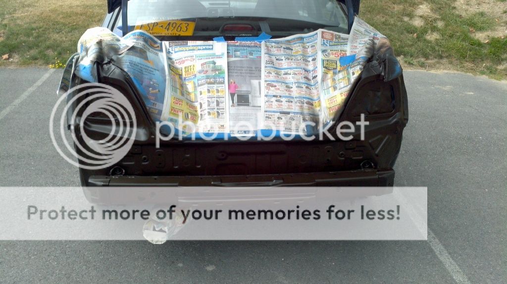

Last photo makes me really want to smoke my tails

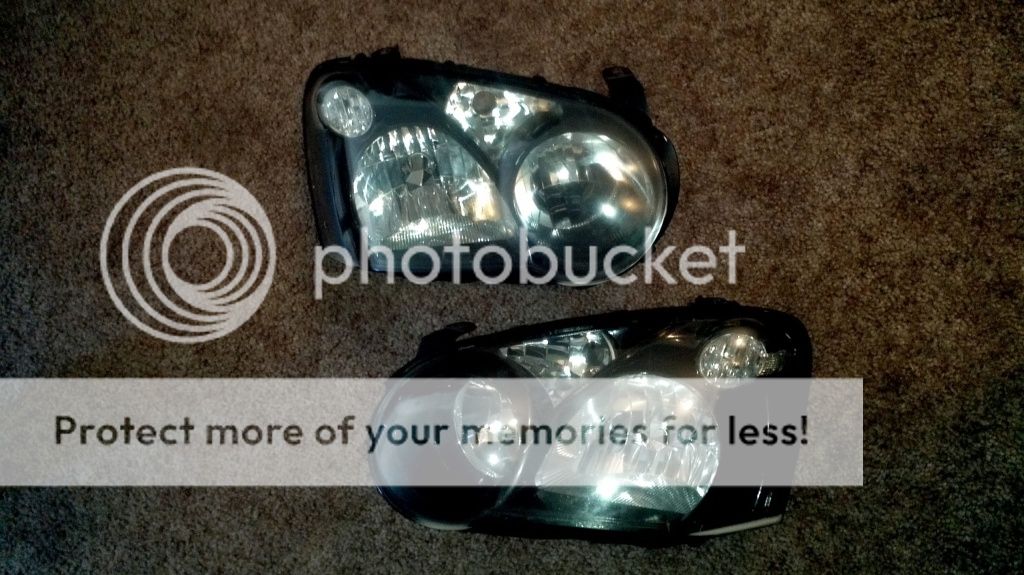

Also makes me think the headlights may look better in black

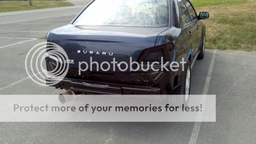

Bumper is back on!
Shes dirty and needs a bath asap!!
Also this pic seals it ... I need to smoke my tails
As mighty mods would say, blaaaaaaack

What Ive already done is taken a small paint brush and hit the rusted hole on the passenger's arch with por15, let it dry, then filled it with liquid metal filler. Then sanded down the filler to make everything ready for the final steps
The plan is:
Hit the arch with a wire cup brush to prepare the metal for the Evapo-rust
Apply the evapo-rust, Im hoping it wont take too long since the rust isnt too terrible now that Ive taken an angle grinder to the bad spots.
Hit the arches and bad spot with some 60-grit overlapping about an inch onto the good paint
Then applying probably two thick coats of por-15 with a mini roller
Ill either leave it like that for the winter or hit it with a coat of clear to prevent peeling at the edges
Then work on the body filler to fix the bad spot in the spring when I hopefully start wrapping it
And Ive come down to two choices for color:
Matte black or Matte Grey

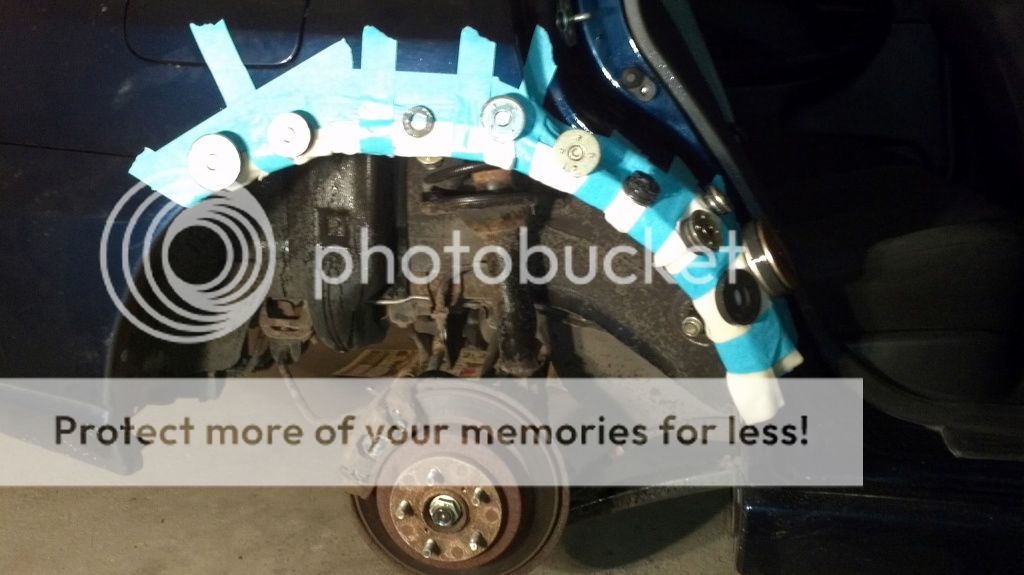

Update. All finished for today
Final thoughts, everything went according to plan, expect the finish of the POR15. No biggie, just means extra sanding/finishing to do :/
1) Evapo-Rust soaked towels held in place with painters tape and magnets. Put remaining evapo-rust in spray bottle and soaked the towels every half an hour for eight hours.
2) POR15 applied. Three coats with 20 mins drying time in between. Applied with a mini roller. Let sit for three hours after final coat
3) Removed tape. Notice the "popcorn" like finish. I think its fibers from the roller.
4) Started a bit of sanding. I like this stuff, dries very hard but flexible at the same time. Should last.

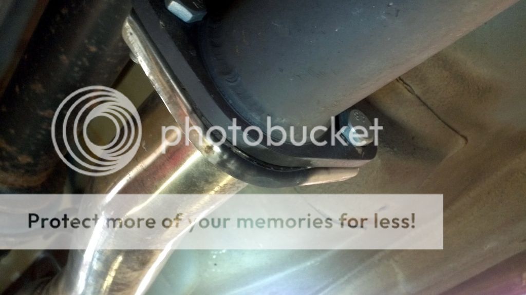

Also grabbed a tube of copper RTV silicone to fix this pretty annoying exhaust leak while im under there.

And if your exhaust leak is from bad eBay gaskets blowing up, RTV only helps for a little while. Especially with winter coming, the salt will erode that stuff away by next year.
http://www.flex-innovations.com/gasket.htm
These guys looks like they have top notch DIY gasket sheets that should be nothing but a fun day for you. Not expensive either.

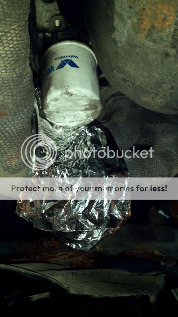

So I got the oil changed and "mended" the leaky exhaust gasket. Was going to switch out my O2 spacer but it looks like Im going to need an O2 sensor socket to get this damn thing to budge. Also looks like Im going to need to drop the midpipe to get the old 90* spacer off since its going to hit the underside of the car as I turn it.
Had to make a barrier to protect the wrapped header from oil:

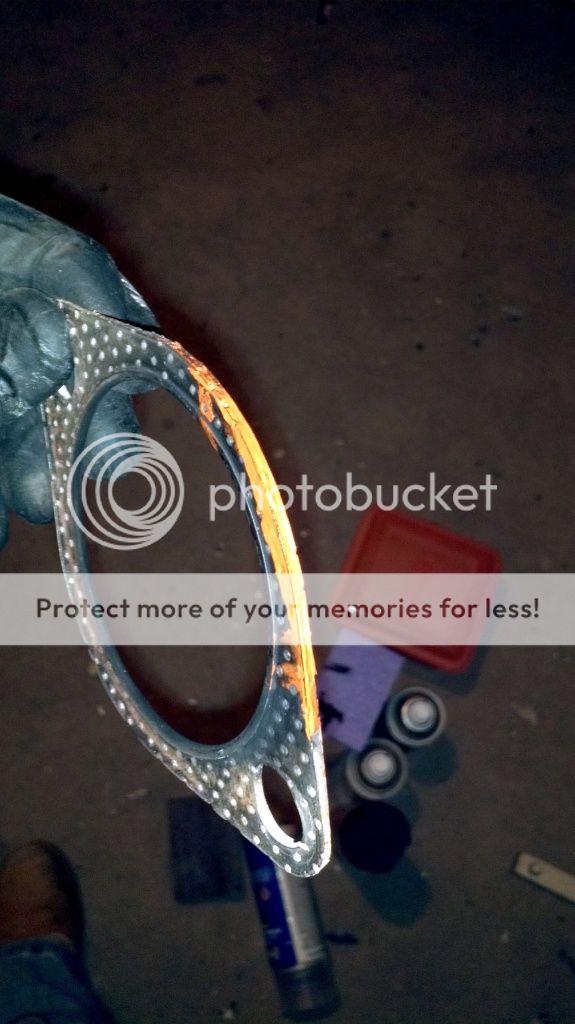

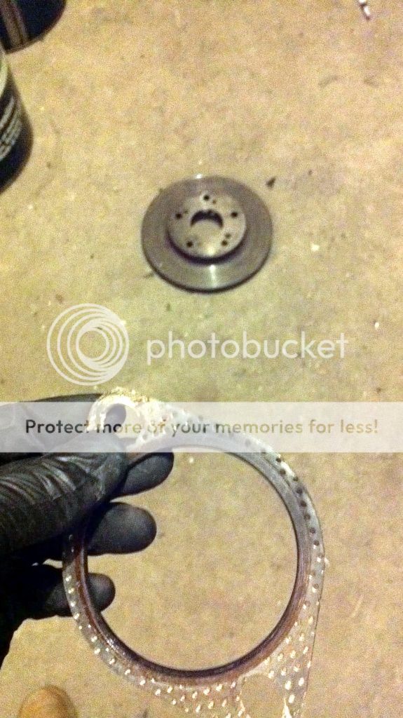

I noticed that the majority of the gasket was in tact and fine and wasnt too comfortable replacing the whole gasket with the rtv so this is what I did: As you can see after cleaning the gasket, just a small bit of the inside of the bottom of the gasket had worn out...
Hopefully that should last a bit anyway
Small change from this:
To this:

Downside to the black is it really shows how badly etched and oxidized my lenses are. Jonesing to get a new set now.
