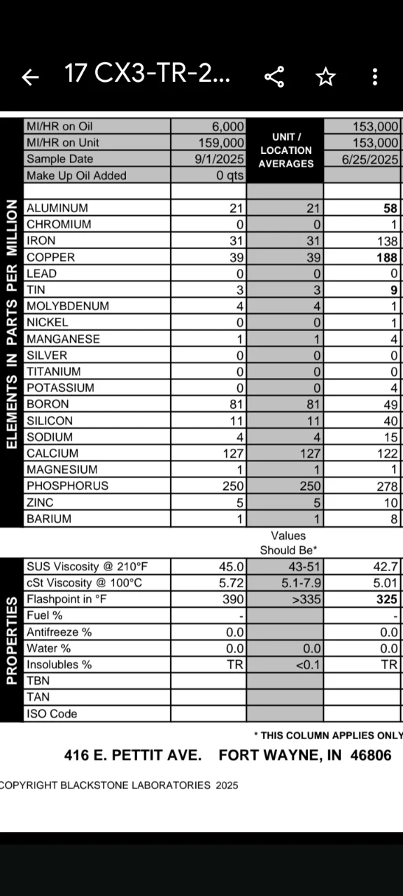

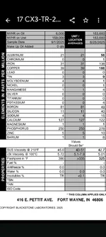

Here's the report on the sample from 9/1/25. I was tardy and submitted the sample very late. 🤦
Comments from the lab:
There's a lot less metal in this sample after the shorter run. That's not surprising given the drain and fills you mentioned and the lower wear is nice to see. The metals here compare well with universal averages, suggesting the parts inside this automatic transmission are interacting nicely. The flashpoint and viscosity read within expected ranges for this kind of ATF, and no extra dirt, coolant or moisture was detected. Insolubles are ok at just a trace. Nothing here points to a problem so just look for more nice results next time.
Too lazy to redact the PDF.
