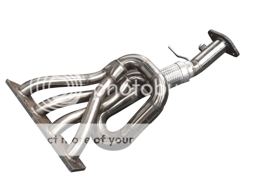

Hadn't been doing anything with it, went ahead and got back to it. Need to widen the flange hole on the U a little bit like .5mm more for proper alignment of the bolt to the header. Just gonna weld a 7-8"black pipe that has a 45 degree end (salvaged from my axle back turbo exhaust) to the flex pipe( maybe 3 Orr 4 inches), and then join the end of that to the u pipe with maybe 3 or 4" of pipe and the up pipe will be done. Clearance from the rear diff yoke seems good. Then I just need to make the DP which may be more difficult because of the less space on that side, and I may have to add an s or something. I might use one of those rigid but flexible exhaust tunes for a small portion of the dp where space is tight.

I've got check valves in the vac lines and my welding is only for prototyping. Not worth the $ to have some test a theory when I can get a working prototype for 1/5th. Also note of the welds on my rear mount broke and that was with heat, bouncing and the occasional scrape. Also thats the good thing about SMAW welding.. it's harder to do correctly but it also has more tensile strenthg so my "bad" weld is still better than the same weld with a mig or something
