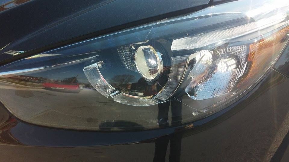

On CX-5 with LED lightings we have LED DRLs wrapping around to corners, they can serve as not only the parking lights but also the US-only side-markers too. We still have amber side marker reflector hence this mod is totally legal with US front side-marker requirements. In fact, the old CX-9's and some of new Mazda3's have similar setup - the amber turn signals are independent from front parking lights. The old CX-9 even keeps the "city lights" in high-beam reflectors only seen in Europe which serve as front parking lights.

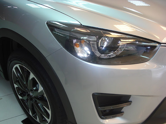

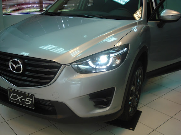

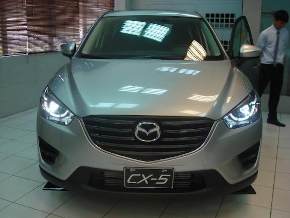

Here are Euro version CX-5 I saw in Taipei with LED headlights without front amber parking lights, side-markers and side amber reflectors:

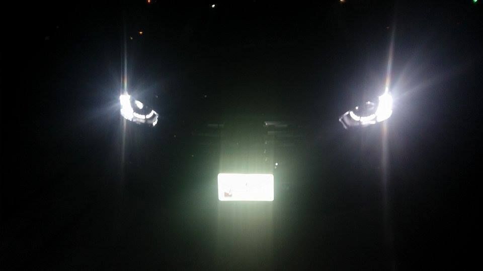

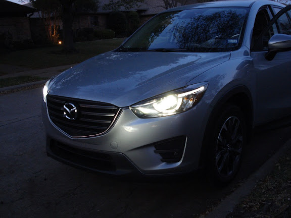

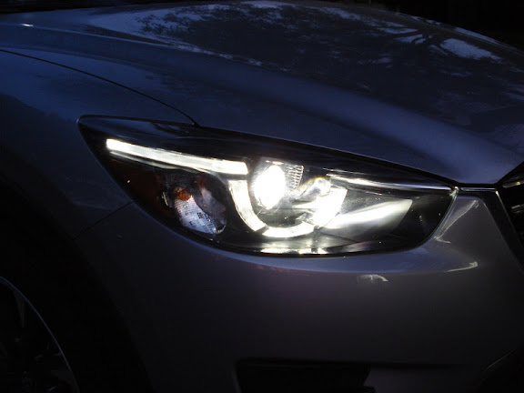

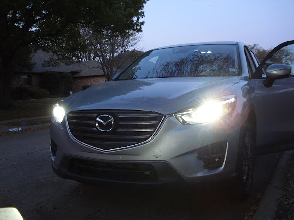

Here are my LED headlights without front amber parking lights and side markers:

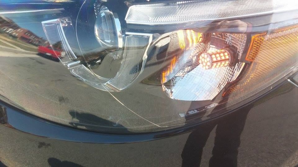

On 2016 CX-5 with LED lightings, the front turn-signal/parking/side-marker lights use 7444NA amber dual-filament incandescent bulb. The rear turn-signal lights use 7440NA amber single-filament incandescent bulb. Be aware that the spec in our owner's manual for rear turn signal lights is wrong as it says 7443NA; and 7443 is a dual-filament bulb!
I started with getting some cheap Wagner 7440NA's as the base of all 744X bulbs looks the same. But I couldn't plug the 7440NA into the front turn-signal/parking/side-marker bulb socket. After further inspection, I found 7444NA socket has additional tabs, which prevent 7440NA bulb to be fully seated. Now I had to modify the 7444NA to make it becoming a single-filament bulb.
7444NA is pretty new and it's hard to find. You can only find unknown brand 7444NA at Amazon. Dealer price is outrageous and it requires special order. I then found the Philips 7444NA at local PepBoys. I simply cut the wire contact for parking/side-marker at the bulb base with electrical wire cutter. Now I could plug in the modified single-filament 7444NA bulb which only works for turn signal.
Those 744X series bulbs are very cleverly designed. They can be single or dual filament without worrying the orientation. You can plug them in either way and they'll work. You can take the 7440NA and compare, cutting two wire contacts on 7444NA, pointed by blue arrow in picture, which don't exist on 7440NA. Or you can trace the wire contacts to thinner filament with less wattage which located at front of the two filaments in the bulb, and cut these two. Or you can try to tape over one of the wire contacts you believe they are the two to cut, plug in and try it out before you actually cut them. Cutting one of two wire contacts is sufficient but I cut both anyway.
