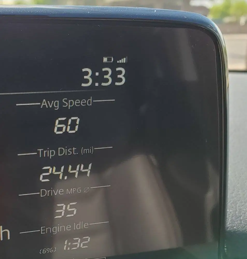

for me the biggest benefit is that the car is more responsive.
example photo
