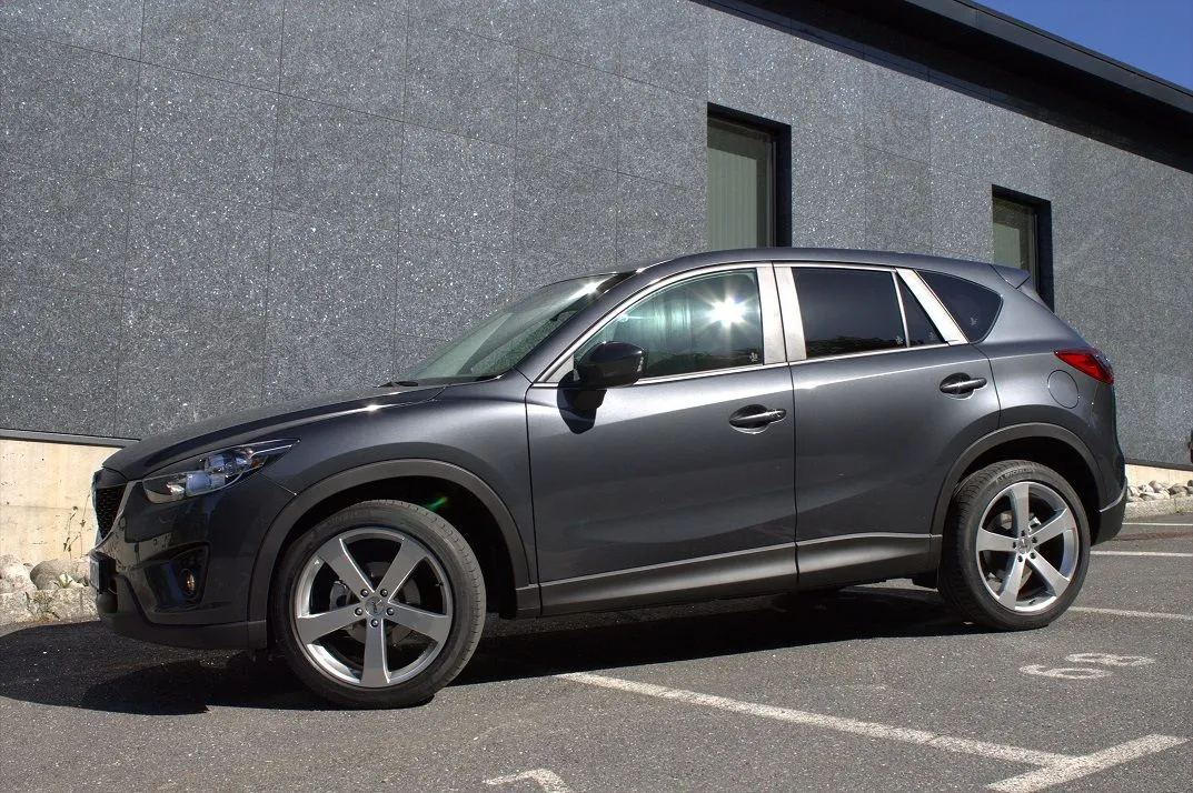

TSW MAX A20x10x40 (ET40) Tires 275x40x20
There should be more than enough clearance given that you don't go too wide and tall of a tire. Factory 225/50-19 will fit fine on a 19x8 and you can even go 235. The wheel well allow enough space to clear the fenders and fender liners even on 19x8 +35.
This here is the factory 19x7 +55 (or +53, forgot) running on 225/50-19 and 20 MM spacers.

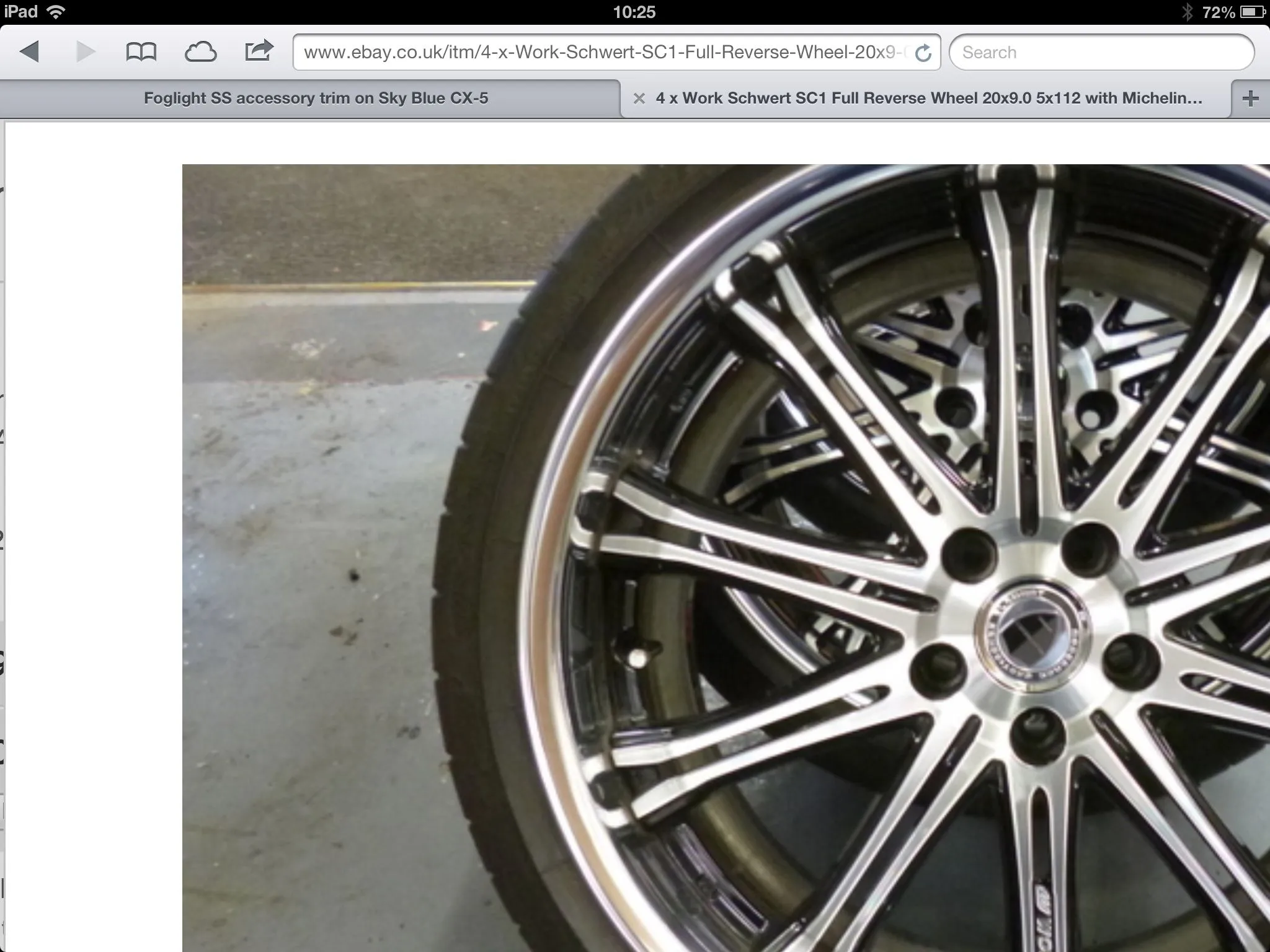

Been so bored waiting for delivery of my CX5 so have bought these on 20x9j rims with 245/45/20 wheels
Wow only taken four months
