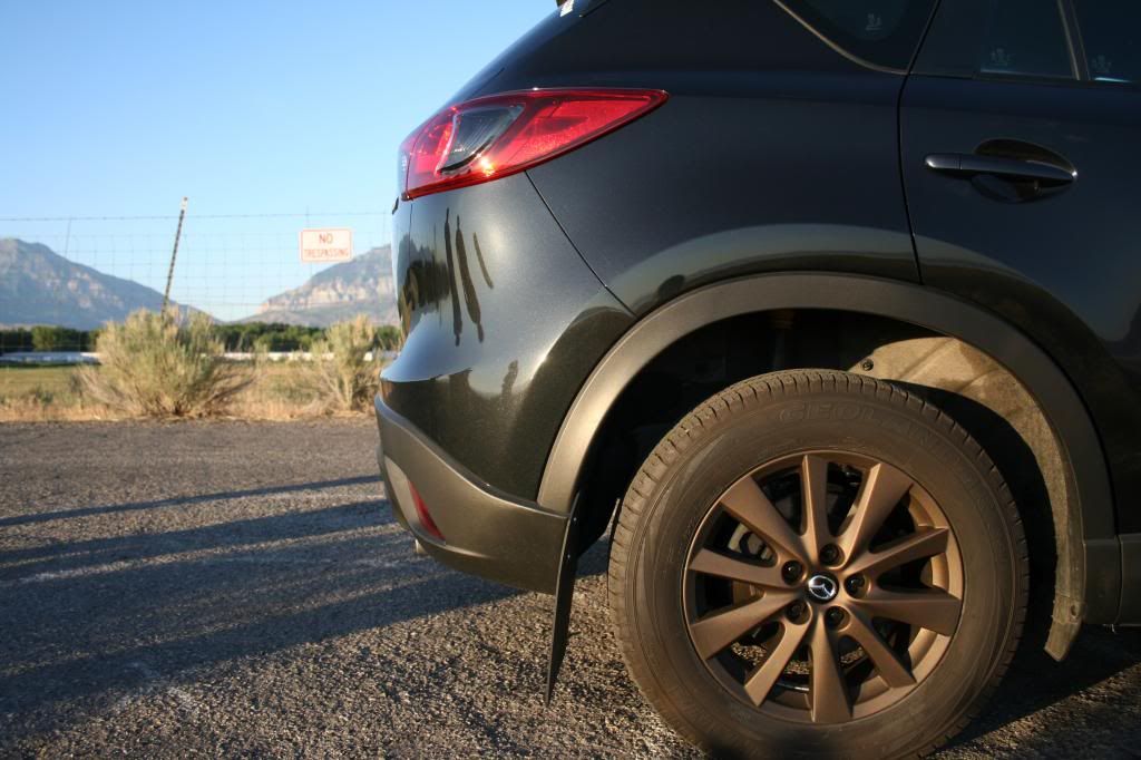

Stock 17's powdercoated matte bronze.

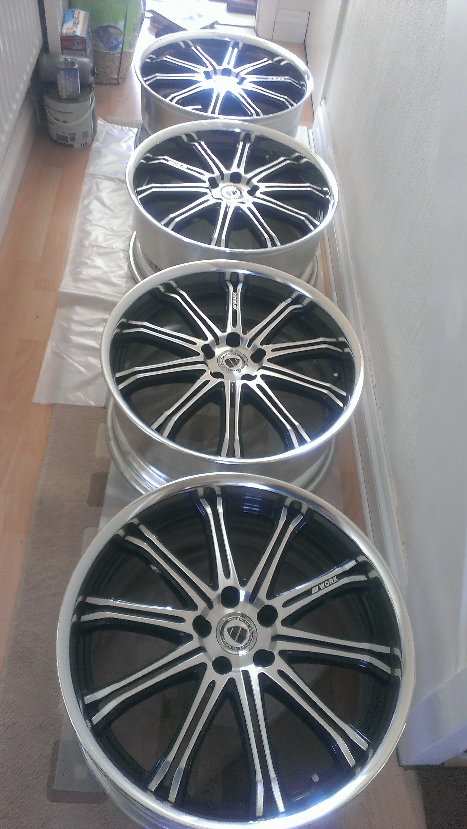

Been so bored waiting for delivery of my CX5 so have bought these on 20x9j rims with 245/45/20 wheels
Wow only taken four months

Hi i have been given a set of nearly new works rims for free due to seller messing up
they are 20" on 9j where it all went pear shaped because they where advertised as ET +48 but they are ET+24 basically will they stick to far out from the arches and wondering what the steering going to be like any ideas

If your wheels are 9" wide w/ 24mm offset, I think that means the outside of your wheel would be about 2 inches farther out than the factory wheels (not sure if my math is correct, and not exactly sure what the factory offset is... 50mm? If so, +26mm (~1") for offset, and +1" for a tire that is 2" wider). ...Which means they would probably stick out a little bit. Judging from SayNoToPiston's pics in the post that I quoted above, about 20mm (.8") looks to put the wheel about flush.
