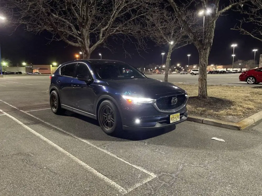

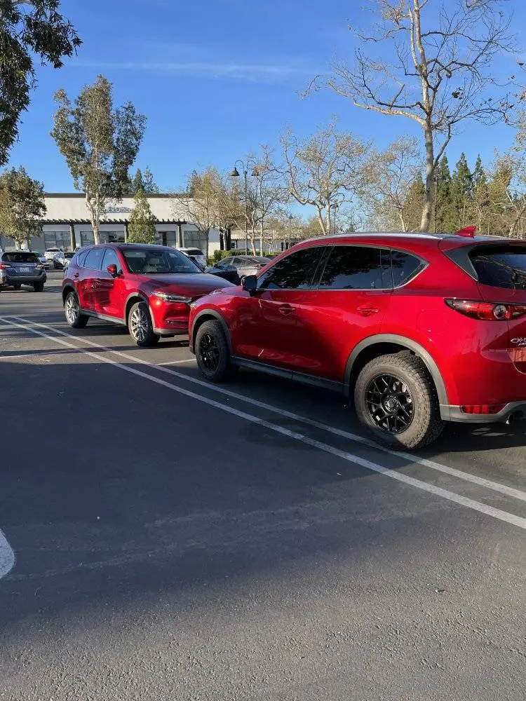

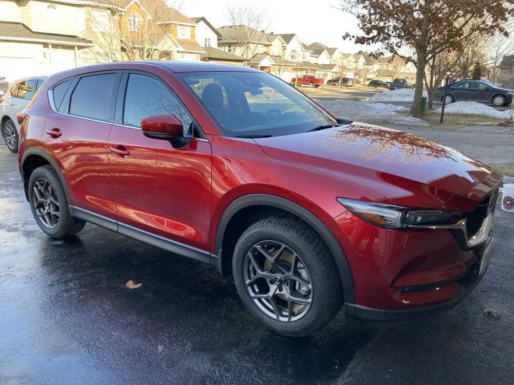

245/55-18 is what I have for my summer setup. Love it.
Yes! I love the look of the beefier tires with the 18". This looks so nice. I really like your wheels too. Now I'm on the fence between the M001 and M012 in 18". :unsure:

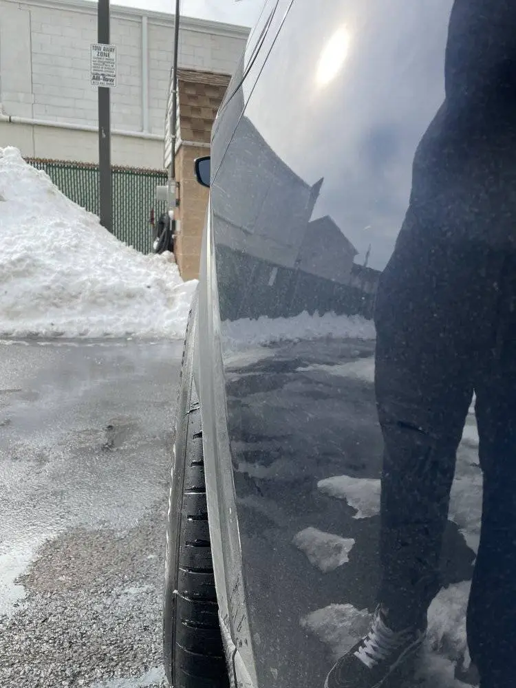

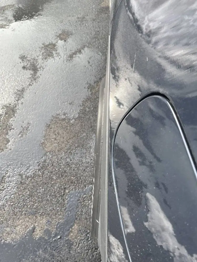

18x9.5 +35… if the tires weren’t so fat, the rim of the wheel would be flush with the fender.

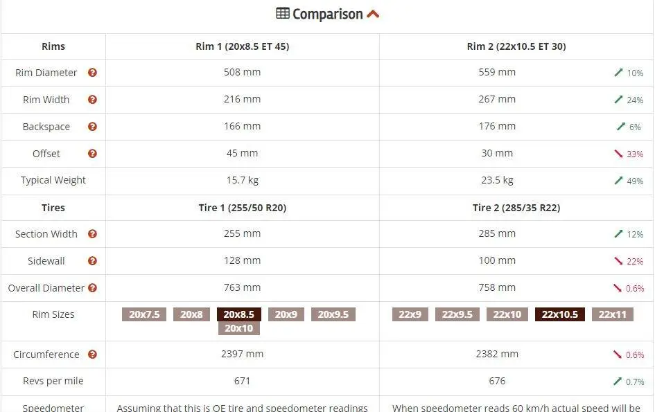

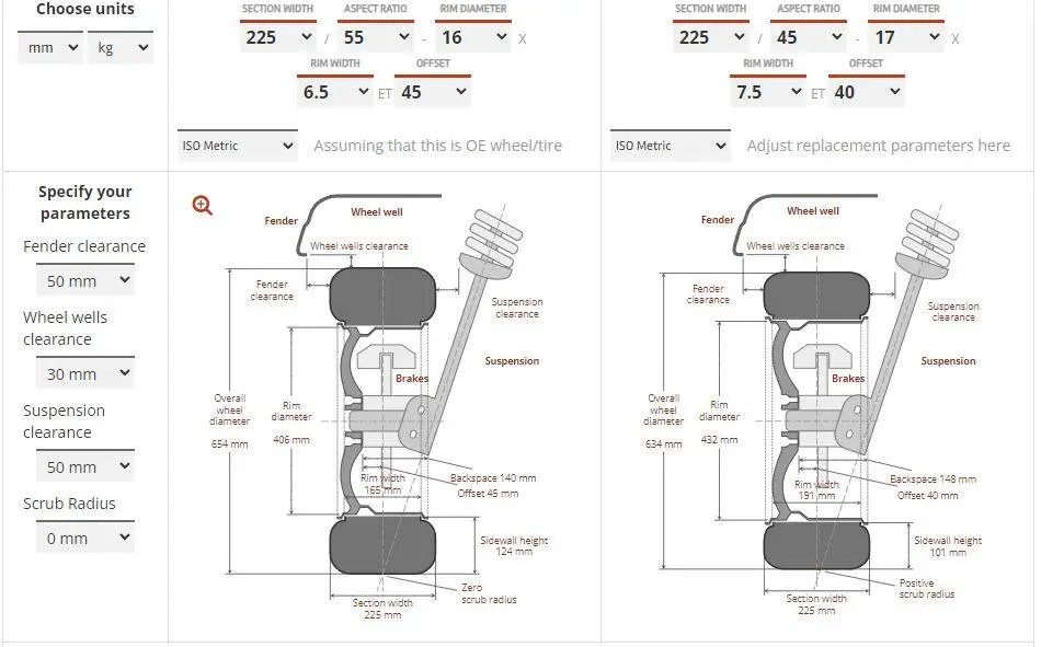

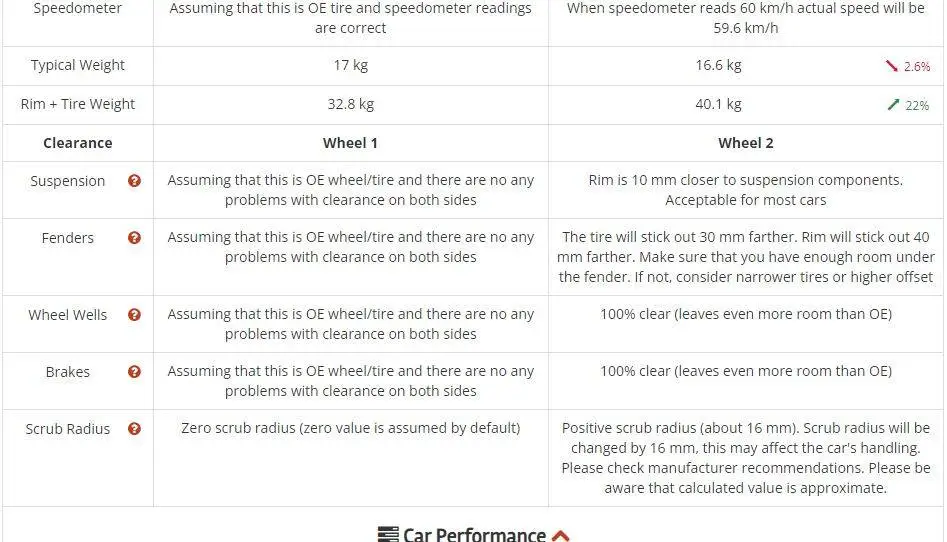

Aside from comparing with what others are running in this thread, your best bet is to use a wheel and tire calculator like the one found here: Rim & Tire Size Calculator. Custom Offsets
You can plug in your OEM/starting wheel and tire specs, then plug in the specs of the wheels/tires you're considering, and it will give you a lot of helpful information. Here a screenshot to give you an idea:
And here's a comparison I did with my OEM wheels vs. my "summer setup":
You can also use this site to find the OEM wheel specs for your car, if you don't already know them.
Thanks for sending this over. This has honestly been a ton of help throwing in these different numbers and tire sizes to get a better understanding!
