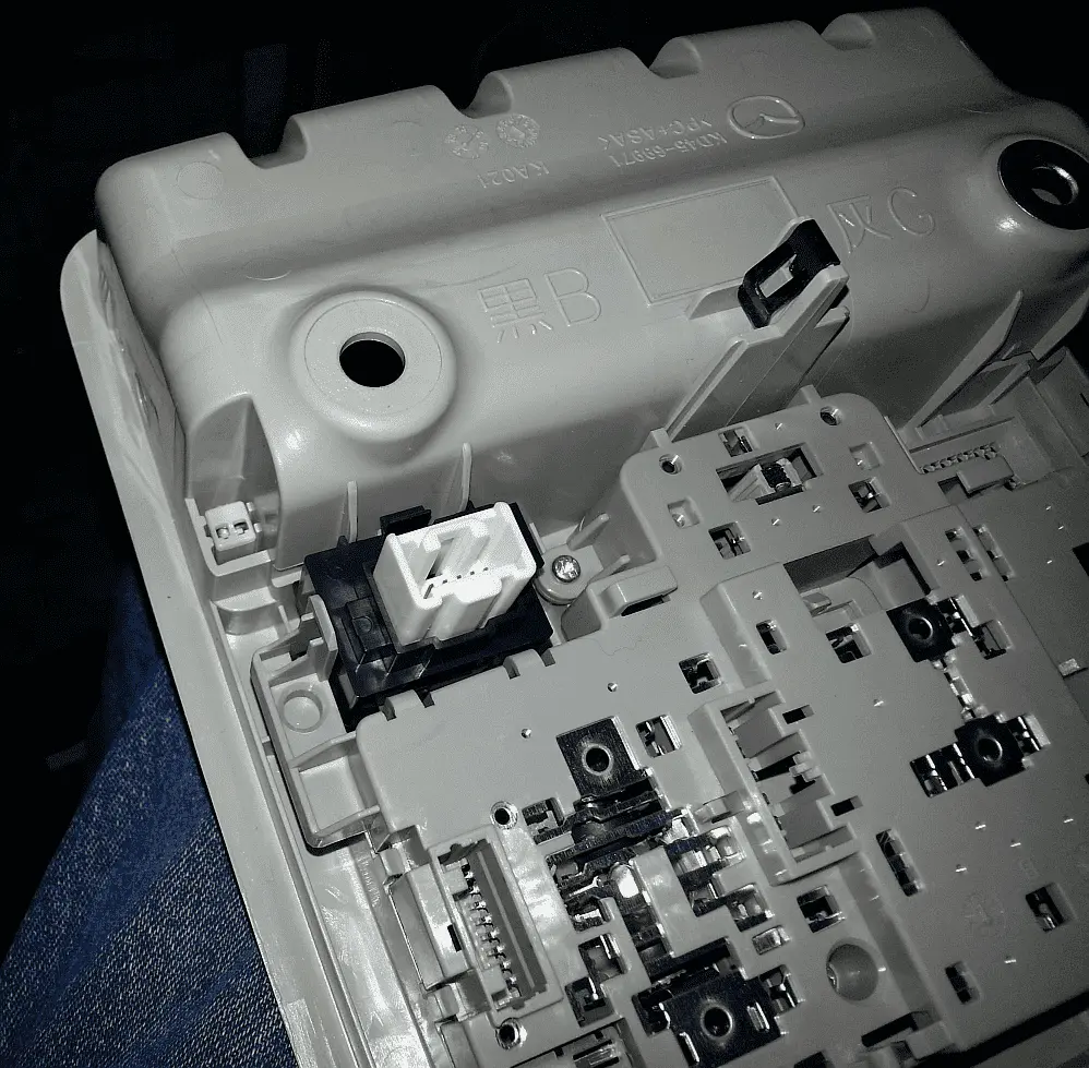

Does anyone have the shop manual section for the overhead console area containing the sunglasses holder/map lights/switch for a 2016.5 cx5 (touring) they could share?
On Mrs. HyFlyer's, the three position (off/door/on) switch for the room light seems to be jammed up and won't move. The switch is in the "door" position, however, no lights illuminate when the door is opened (though the lights do work in map mode by clicking the individual lamp on).
Don't have the manual, but if you want to just remove the overhead console and look into it yourself, it's pretty easy. Just open the sunglass holder and undo the two screws there. Then just pull it down to unclip it and slide it forward a little to remove.
My first gen is a 2014, but I'm sure it's the same as yours. Attached pic shows the console with the visible screw holes and clip. Note that the lights and buttons have their own connector (just at the bottom-middle of the pic), but then all is linked inside the grey box/assembly. (The white connector in the middle is just for the microphone.)
