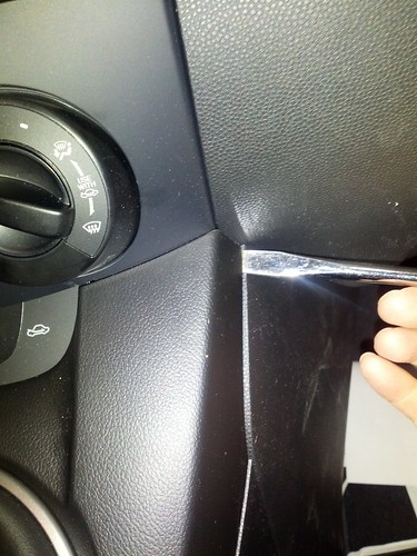

First off, this was the best spot to pry from because it had the most pliable spot to stick my screwdriver in without marking:
the rest pops right off. here is how it looks :

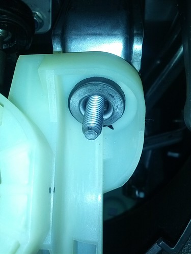

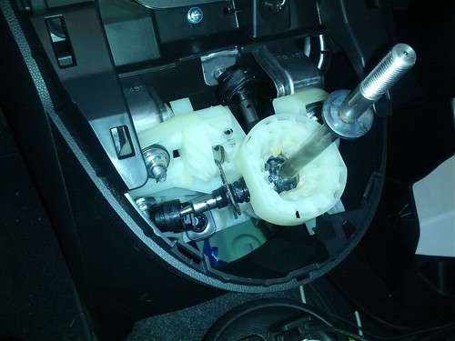

Lots of plastic, but a very solid steel base. See those top 2 nuts? They're the top connection for the gear shifter.
There is quite a bit of play in them :
There are 3 ways to deal with this, 1 - Replace the rubber bushing with machined bushings to cut down on movement, 2 - pull the rubber out, add washers, call it good enough, or 3 - crush the rubber by tightening the crap out of it and hope it makes a difference.
I didn't have time to expose the lower connection point, so I went with #3. I torqued the nuts back on to 20 ft-lbs -- ended up being pretty damn tight.
The difference is incredible. I've always liked "feeling" the gears, and having some sense of what is going on, instead of just jamming it into gear. You get more feedback, and the whole assembly feels more precise.

I really like this idea! I do have a question. I tried tightening them and they just seemed really tight already. Did you tighten them 20 ft/lbs more than they already were or 20 ft/lbs total?

Hey xyrth, how tight were the nuts when you removed them? I was going to tighten the crap out of mine today but they were already tight as crap (like seriously tight).
I think there is some confusion here, mine were not loose, they were snug. I tightened THE **** out of them.
I was using an older torque wrench (but still snap-on) and went to 20 ft-lbs, I just got my electronic (Techwrench) back from a friend, and will check it with that -- but I probably did 2ish complete rotations and crushed the s*** out of the rubber.
Gotcha. I was expecting them to turn easily. I'll take it back apart and maybe tighten it 1 turn or so.
