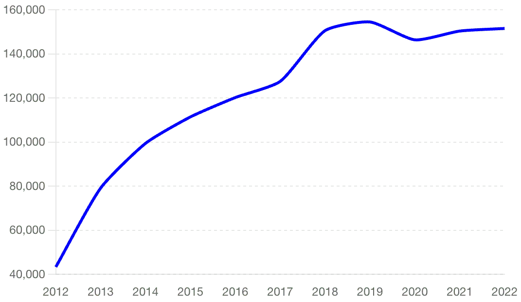

Data on yearly sales seems to be down right now at GoodCarBadCar but here are US sales from 2012-2022
