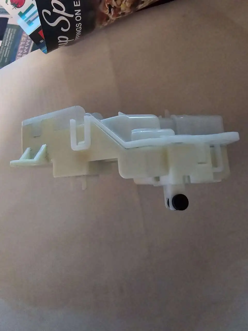

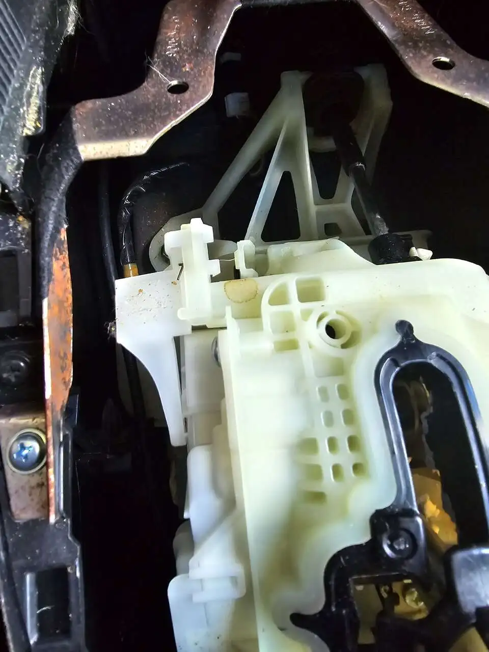

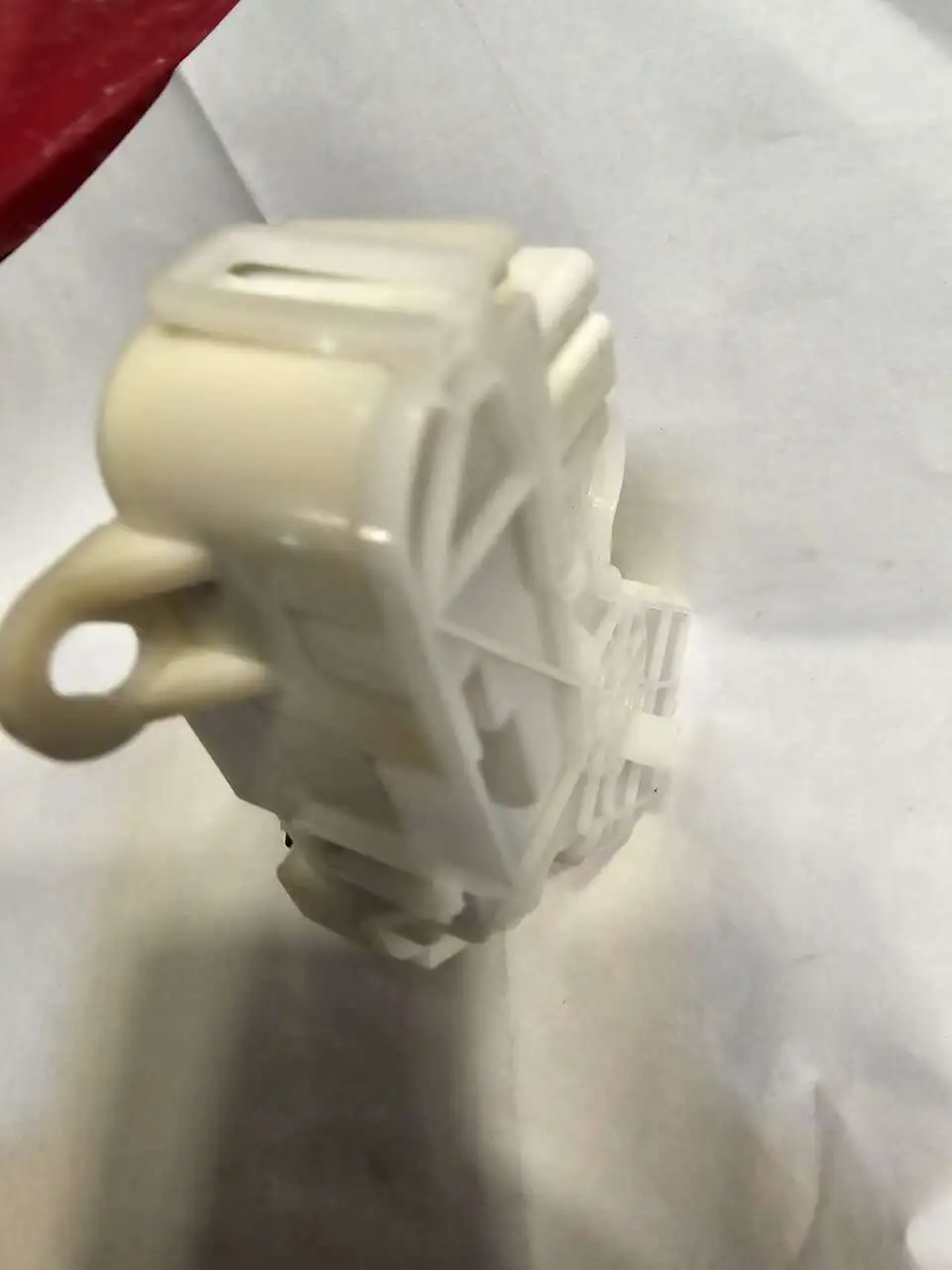

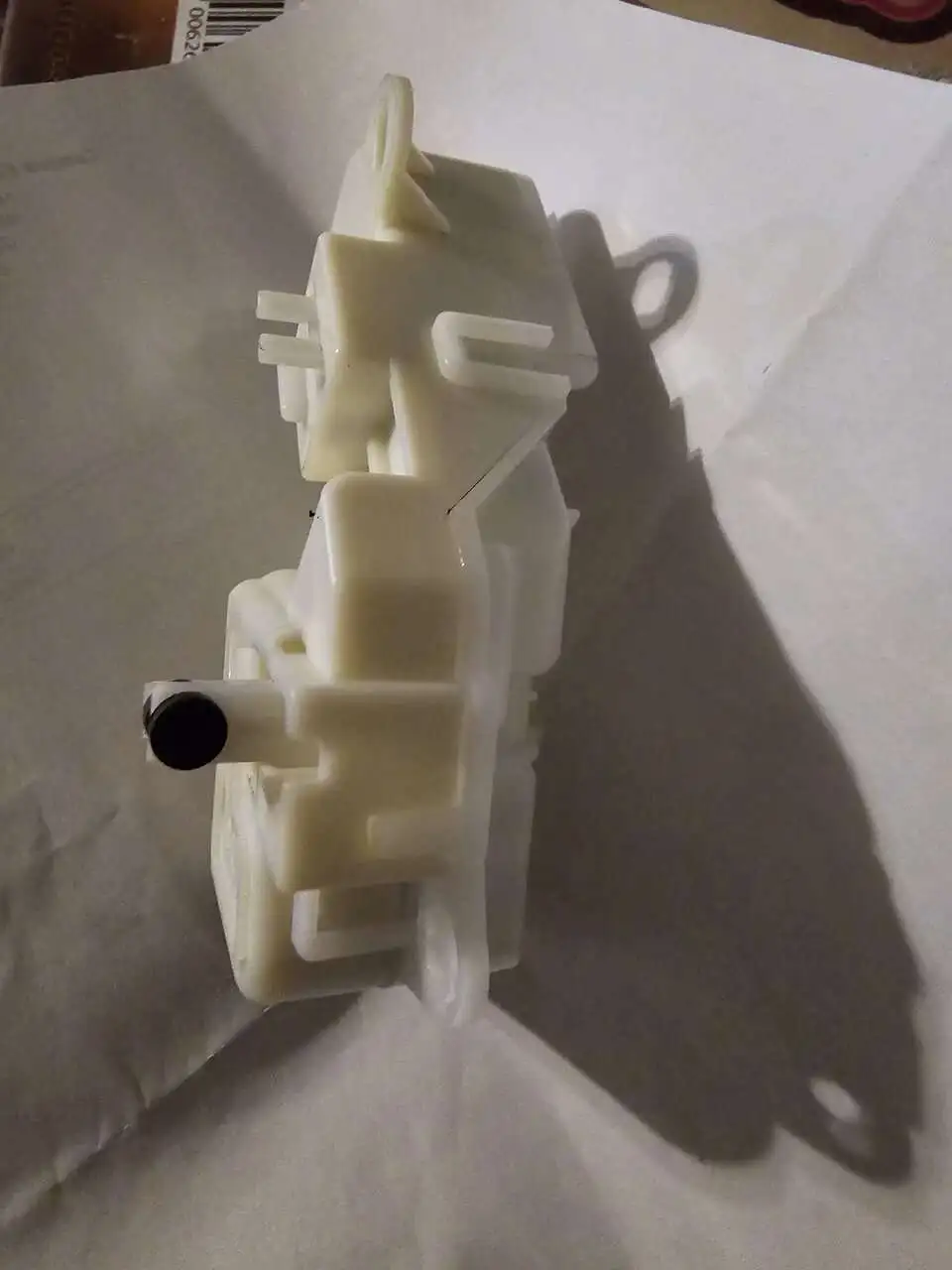

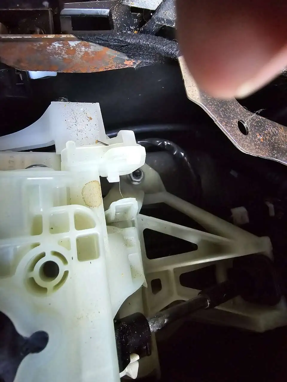

So I have a 2015 CX5 2.5 and the radio started staying on after the car was turned off. It is the shift switch is worn but no one can help find the proper switch. Mazda Canada was completely useless and one deal wants me to make an appointment so they can see my car and the other one says I will have to buy the shift assembly at $750 to get that $80 switch which is what that switch costs from Mazda for 2014. The upgraded part is KYD0-46-040 which does not fit my car. It is an automatic. Have not been able to find any scrap yards with a 2015 up in it. Any suggestions besides dumping the car. It did start to work again. Thanks for any input.

Thanks. That looks like the switch I am looking for. Found a scrap yard that has some 2015 cx 5 so will have to check it out tomorrow. But of a drive but Mazda Canada and the dealers around me are useless. Thanks for checking it out.

There was no numbers on the part I took out. Never thought of aliexpress. Will do a search. Mazda says I have to buy the whole shifter assembly for $800 to get that switch. Pretty sure this is the last Mazda I will own. Feel really screwed over. Thanks for the info. I have give Mazda dealer my vin and found nothing. Says to pay the $800. Thanks for your input
So aliexpress has the same switch that Mazda said to buy the KYDO-46-040 which is totally different. Thanks for the idea
Here is an update. I found a yard that had the 2015 CX5 2.5 and had to buy the whole assembly for $50 Can. The actual switch is on the side that Mazda will not sell. Mazda Can did not want to help a customer out finding the part. Dealer wanted $800 and also book an appointment so they could look at the switch. So Mazda put another piece of junk switch in and then won't supply like they did with the KYDO-46-040. My car has 130k klms and it is failing like the other switches and the new solution is to have to buy the entire shifter assembly for $800. Think I only had another make of company rip me off like that in the early 80's was GM. Screwed me over huge. Never bought another GM product since. Will be dealing this as soon as affordable and never buy another Mazda. I appreciate all the help from all the members that replied. Thank you

Thanks but yeah it is 100% different switch. I also bought the upgraded switch like you did the KYDO-46-040 for $39 on Amazon which is the same switch as the one Mazda dealer said was the replacement was. Bought it but no way it will fit.
The only thing is you're replacing it with another 10 yr old switch that has a bad track record to begin with. I would at least see if it's possible to take the used one you bought apart before you install it and clean and lube the mech and also the electrical contacts on the switch itself. You'll be hating life if you take the time to install it and two months later the problem comes back.
