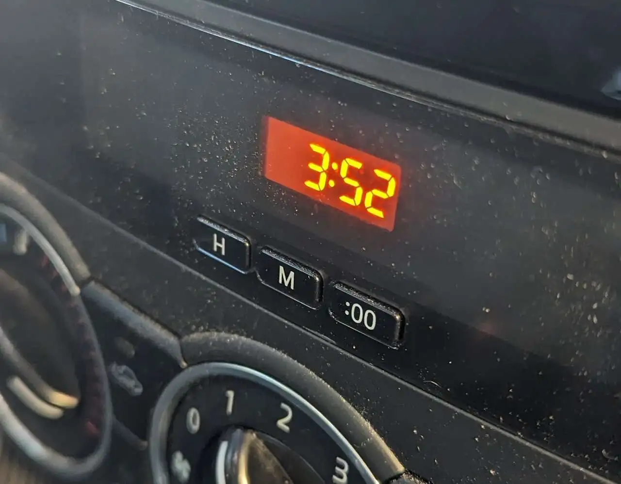

On my 2013 CX-5, you simply press H for hours and M for minutes. Why they ever got away from that, I'll never understand.
