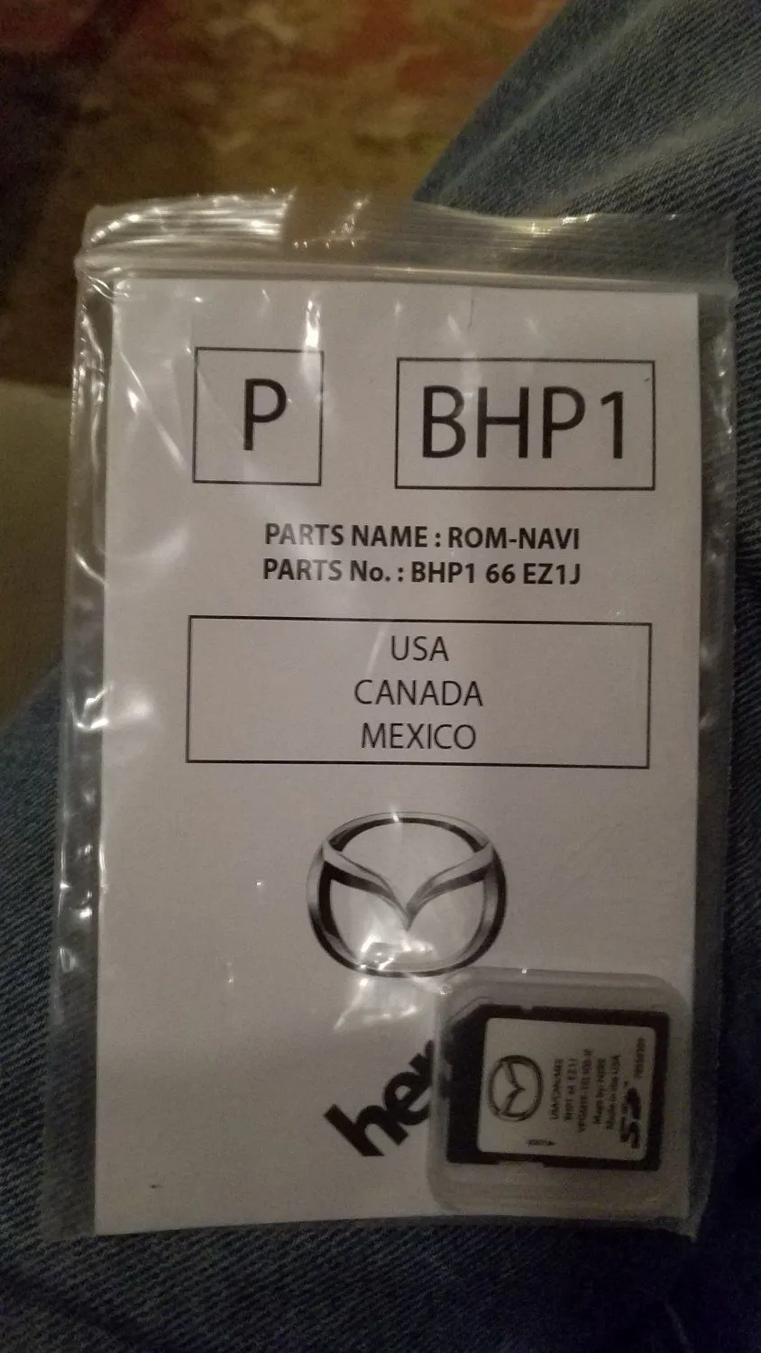

Who said they're copies? Genuine Mazda SD cards are easy to find. They're simply previous iterations, and can be updated to current maps. I bought a "J" card on Amazon for our 2020 GTR (IIRC we're now on "L"). It was shipped from a well known vendor of authentic parts; one that would not risk their reputation selling counterfeits. I have not bothered to use an update, though, because I've yet to encounter any road discrepancies.

You may need a newer card version for the 2021's. The "J" card worked fine on our 2020 GTR. But revisions to the system for 2021 may preclude using an older version of the card like that one.
It looks like the latest version of the BHP166EZ1 card ends with an "N" suffix (yours is "J"), but I'm not even sure if that's for the 2021's or only an update for older ones. It may have a different base stock number now... or not. Don't know for sure. I think you're going to have to check with Mazda.
If 2021 is compatible with the "N" card but no previous version you may have to wait awhile to find it cheap. OTOH, if it's compatible with, say, an "M" card you should be able to find those reasonably priced. To wit, it appears that Mazda liquidates previous versions of the cards when a new on comes out, and that is why we are able to find them selling cheap but not the newest one. Make sense?
