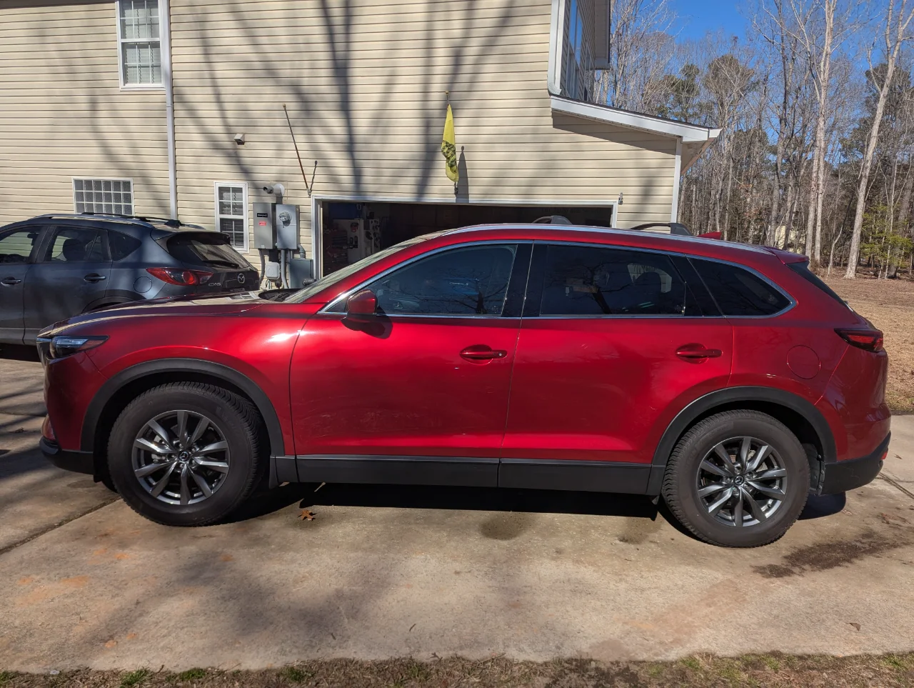

Here in SC, we aren't used to ultra cold weather and snow, so these past 10 days have been WEIRD.
Time to get the salt off of my baby's baby.

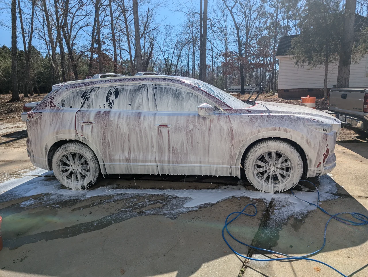

Just did this yesterday. We hit 60° (freedom units) so I took advantage. Car was covered in a film of salt and muck.
I used an APC plus an acid to loosen as much as I could exothermically before foaming the car down.

I didn't even know "salt neutralizer" was a thing. This is just Guyeon Foam. Get the car wet, spray it with the Foam, let it soak in for a couple of minutes, hose it off. Then you wash normally.
